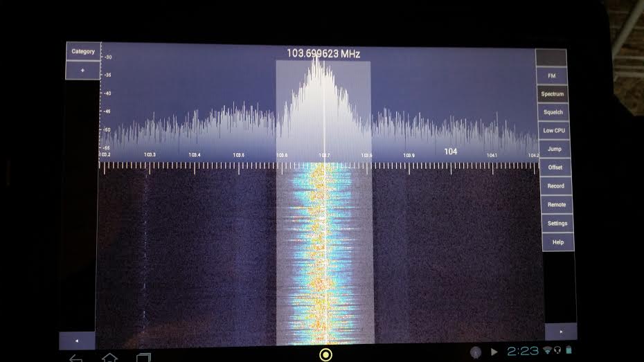

I paid for the Pro version, which gives you the waterfall/spectrum display along with the ability to record. It was only 10 bucks, and you get all the updates the developer adds along the way for free. Pretty cool and fun to play with, but I haven't had much time to fiddle with it. It worked immediately on my tablet (which has a full size USB port), and hooked up to my slim jim antenna, received quite a bit of stuff. I seem to be getting overloaded by some FM broadcast stations, so I'll have to look at the rest of the settings to see if I can knock that out.
73,
Brett
That looks good on the tablet. I figured out the HF signals must be birdies. There is no change to RF levels when disconnecting a piece of wire.
