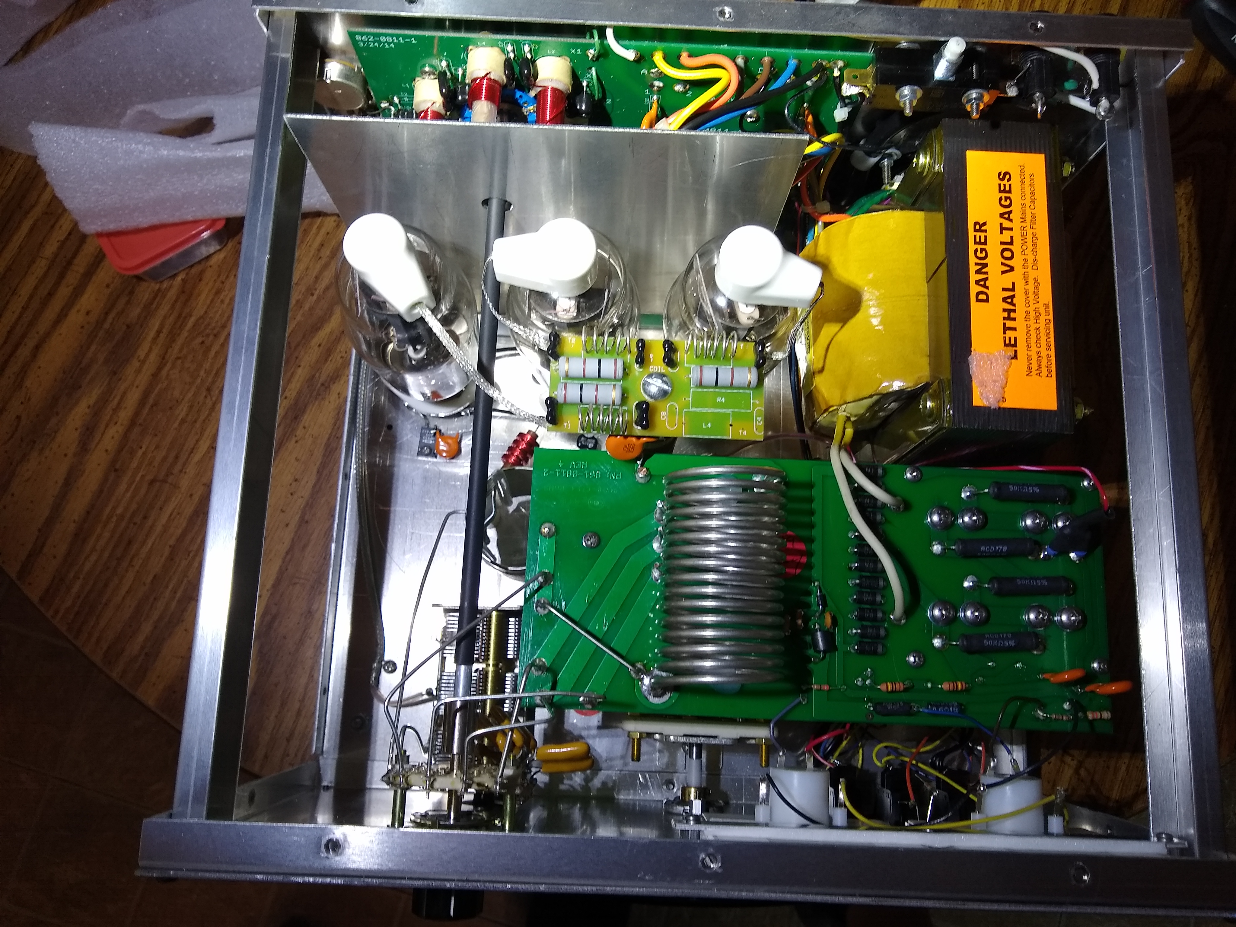

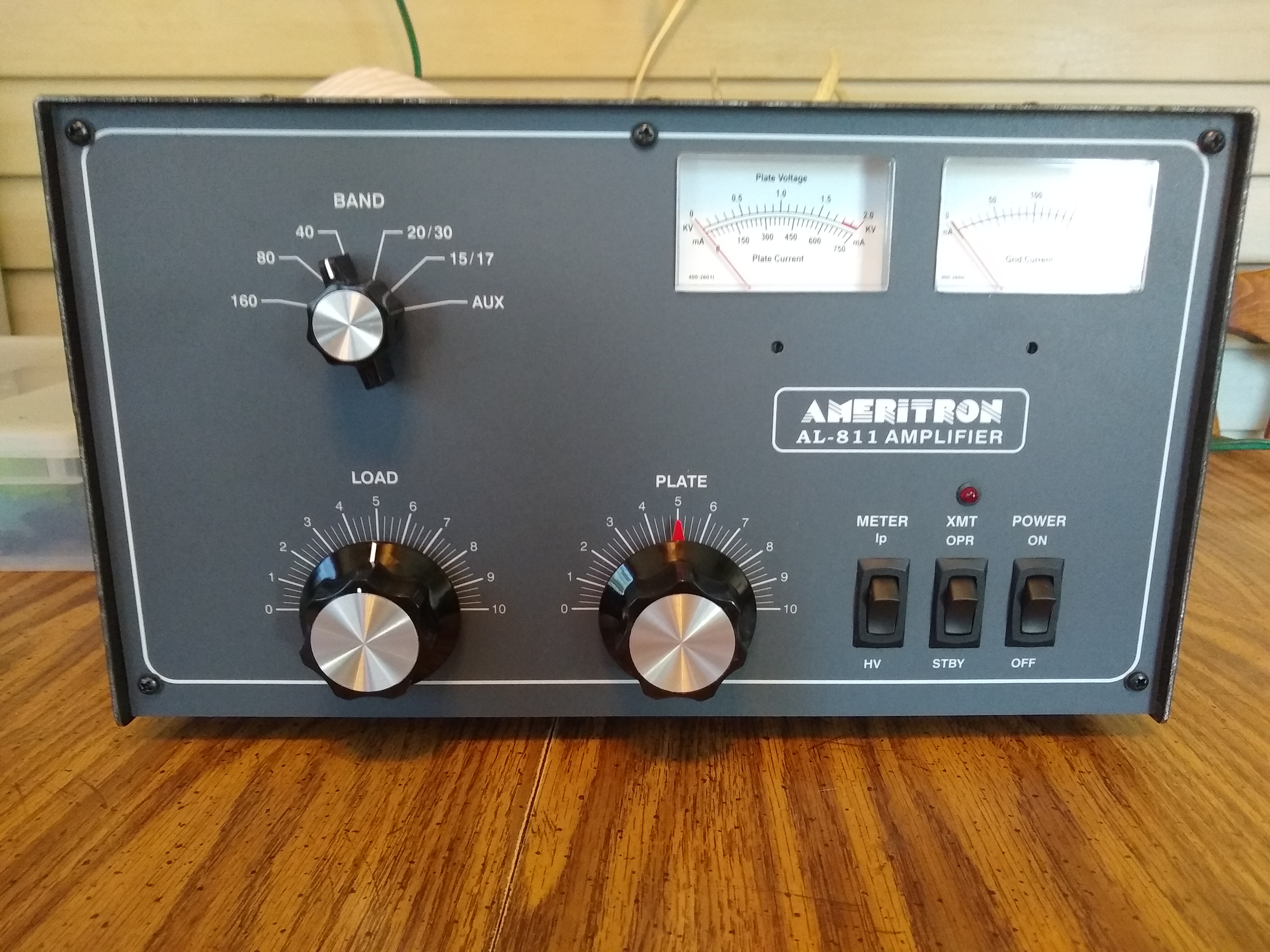

Looks to be in near mint condition. Very clean inside. Fan blades clean. Looks like it was a desk princess.
I didn't look for the green wire, but it's gotta be snipped.
