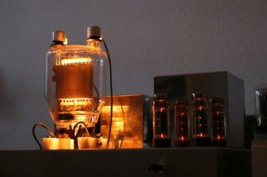

A single 4-400C or an 833A/833C make nice mood lamps in the shack when mounted and the filament lit.
833A

Now that's a tube! My friend Artie Arthur windjammer (RIP) would remove the cove on his Viking 500.
With the room lights off those 811's had the coolest purplish blueish glow I'd ever seen. It was a long time ago but that's the way I remember it.

That is a single 833C. The top pins are the grid (on the right) and the plate (on the left). The filament pins are on the bottom and require 10 volts at 10 amps to light them. One of those has a plate dissipation of 350 watts. I serviced many 1 Kw AM broadcast transmitters that had a pair in the RF finals which were plate modulated by a pair of them in audio service. The TX cabinet looked pretty cool with the four of them lit in the dark along with six 807's as well.
