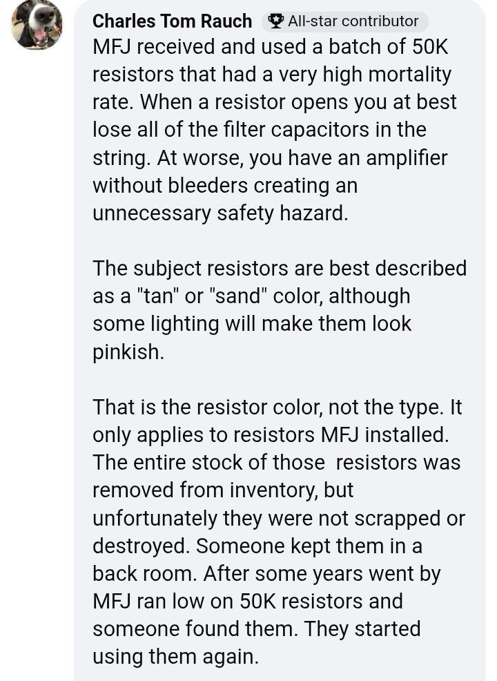

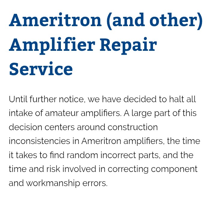

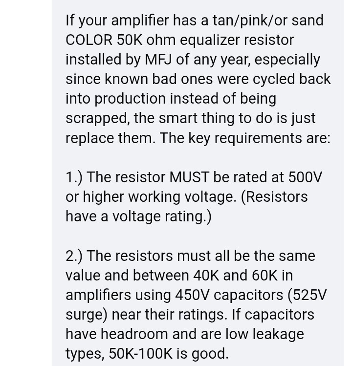

From Tom Rauch on his FB group.

Tom is the one that designed the amps for them many years ago.
He has a company now called CTE and does (was doing) repair to these amps.
There's a lot of them still out there and on his FB group he still helps people troubleshoot and repair them.
He posted this last week for those who are still running them.
The reason I said was doing is that he has stopped working on them because of the problems caused by the building at MFJ.
