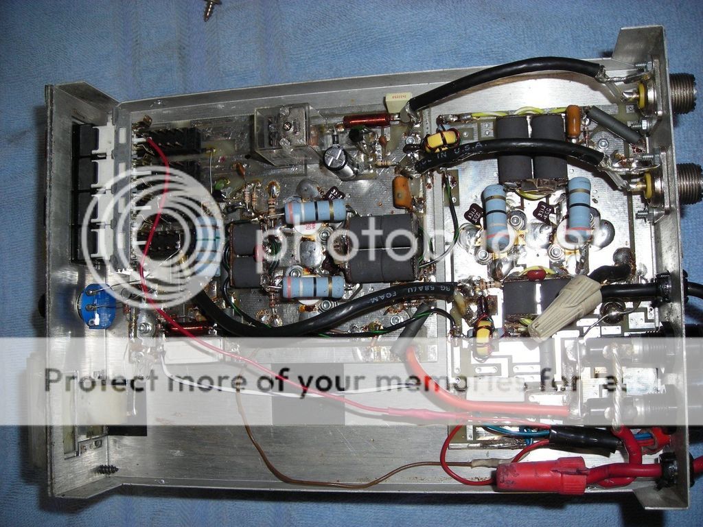

Look at the wire nuts.......why didn't they just replace the wire and solder it on? Some moron still paid $230 for it.
Lets see 4 original 2879's matched (not DEI's). Everything else looks good in there. If the only thing that has to be done is some new wire. For $230 who's the moron?
1) First of all that amp is 25+ years old and that's more than what it sold for new.
2) It is a Texas Star.....that speaks volumes. LOL
3) It is equipped with 2sc2290s, not 2879s........25+ year old 2290s though.
4) How did you come up with the matched 2879s part...the numbers are not even visible?
5) People who half ass ultra simple entry level repairs generally don't take care of equipment.
Look closely at the positive wire where the wire nut is. There's a large burnt trace there. Looks as if the wire nut is cracked as well. Burnt trace is right under the blue wire. Or am I just seeing things?? Wouldn't touch it with a 10ft Pole!!

Anyone that buys a used CB amp with unknown history and expects it to have good matched pills is dreaming. Just because they still work doesn't mean they are still good.
It doesn't matter what the lot numbers on the transistors are, if they were matched when the amp was built, red dots or no dots. That all goes out the window after after its been abused for any amount of time.
