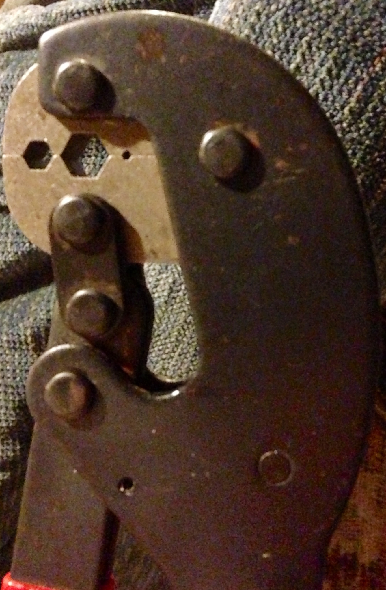

Not that one. I'll take a picture of the better crimp tool after getting home from NEAR-Fest next week. I've had to redo many hex crimped connectors done with that tool.

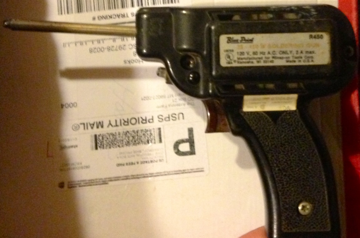

I second that. I expect longevity not just ease of use. I wired up my first mobile alarm back in the eighties by only using crimp connections. That lasted only six months before the connections failed because of corrosion. I use a 450 watt Blue Point(Snap On) soldering gun for heavy duty connections.
