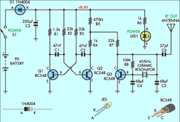

Anecdotally,
I once built a 455 kHz , AM modulated power oscillator.
It was my road rage broadcasting station.
It's amazing how many devices you can get into within a 100' radius with 150W...
Reactions: Shadetree Mechanic
Thanks kopcicle, I will attempt to build one of those. I have not had a chance to get back to this d201a. I have had other things come up. I am still having a little am rx issues. I did get the replacement pot for the rf gain. I need to get that in there to see if it helps my am rx. Thanks to all for your help. I will try to get in this thing again this weekend.
