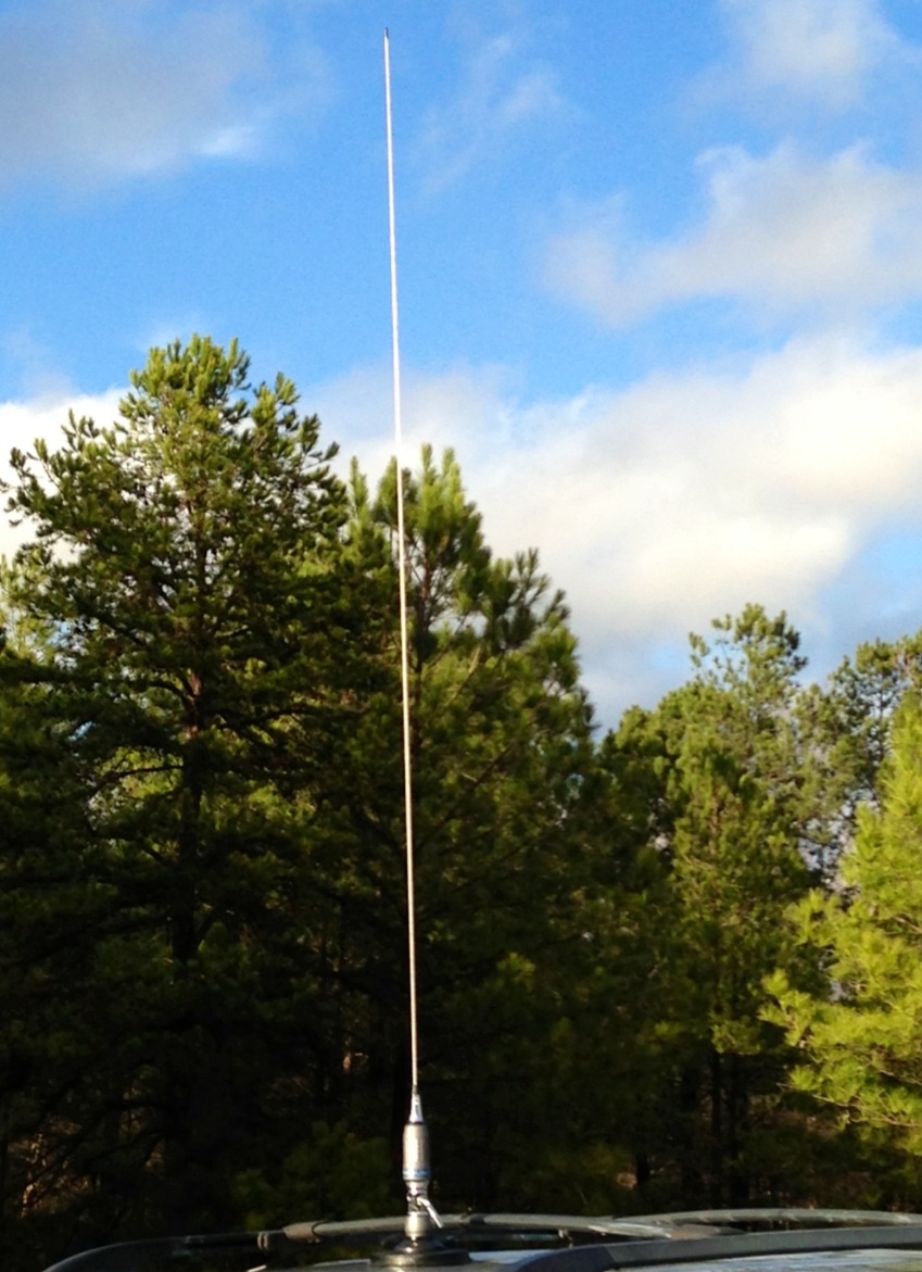

Alright! Got it dialed in. A band;2:2:1 25.855 MHz. B band;1:6:1 26.305 MHz. C band; 1:1:1 26.755 MHz. D band;1:1:1 27.205 MHz. E band; 1:2:1 27.655 MHz. F band; 1:7:1 28.105 MHz Thanks to you guys!

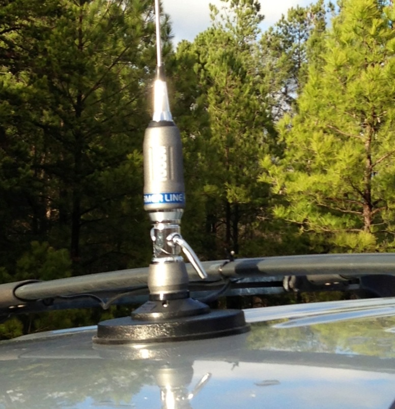

Here's another. Sirio has it right putting a rubber seal at the base of the whip itself to keep out moisture and a seal at the screw on bar where it attaches to the mag mount. Also,Sirio supplied a sheet of metal foil w/adhesive to seal the base and to keep out moisture. A problem K40 has with theirs. K40 let's water get inside with their mag mount which in turn raises the SWR. I almost have to glue some metal sheet steel on the inside if the roof to keep the roof sheet metal from flexing so much. Thicker material equals more magnet holding power.
