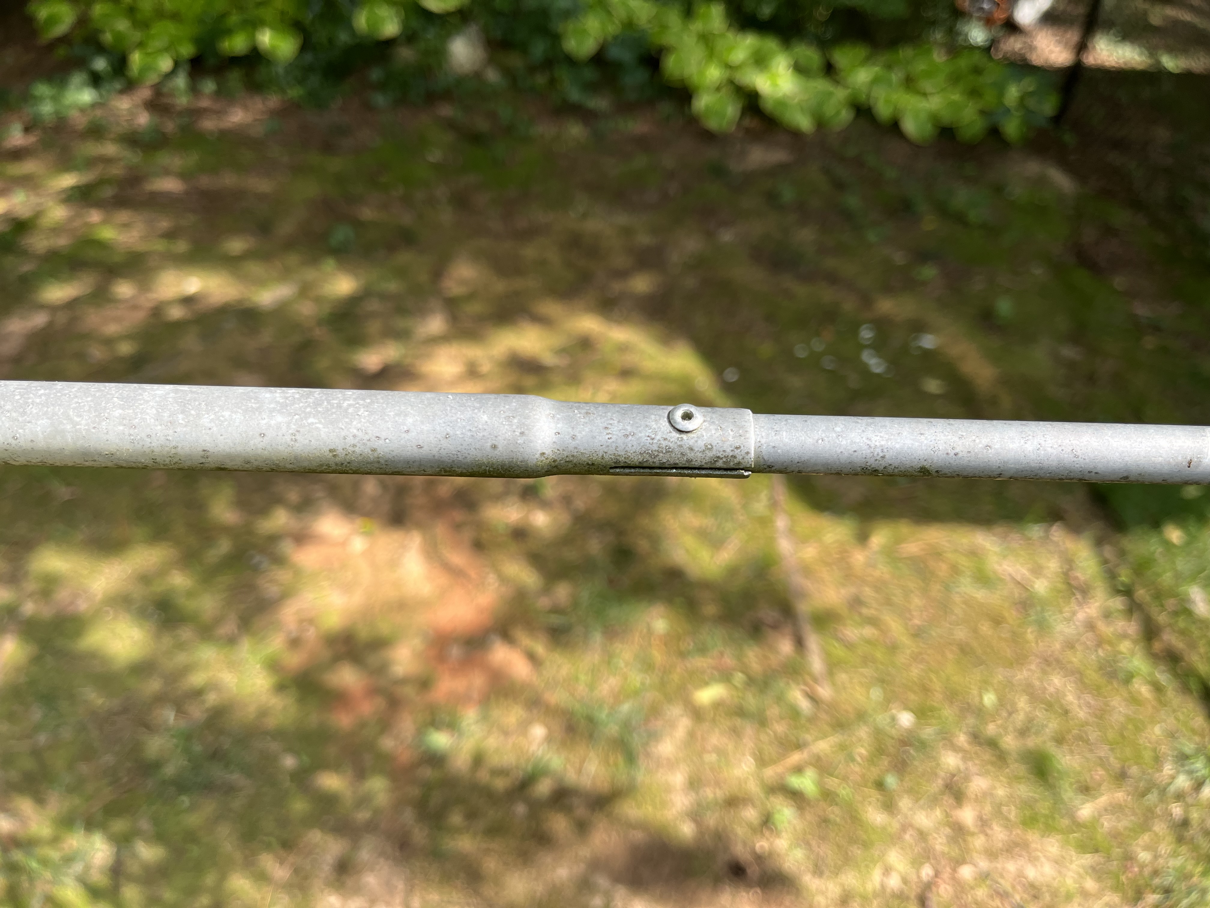

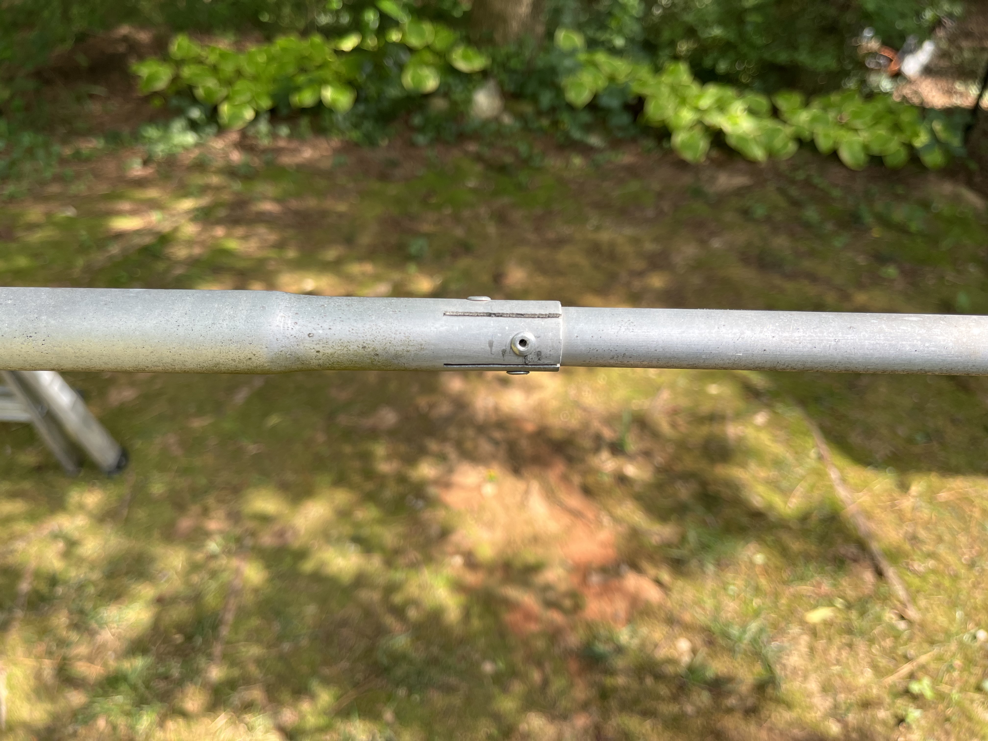

This is an example of the “double swage” as I called I called it. In retrospect, I guess it is just swaged.
Below from the 1st element (attached to the boom) to the middle element.
Below from the middle tube to the outer tube.

Those rivets make me nervous, especially on aluminum. Should be stainless steel hardware, including lockwashers.
IMHO, of course.
I did notice the sections have some play in them with the rivets holding them. I will either remove the rivets completely and add TRUE stainless clamps or add the stainless clamps in addition to the rivets.

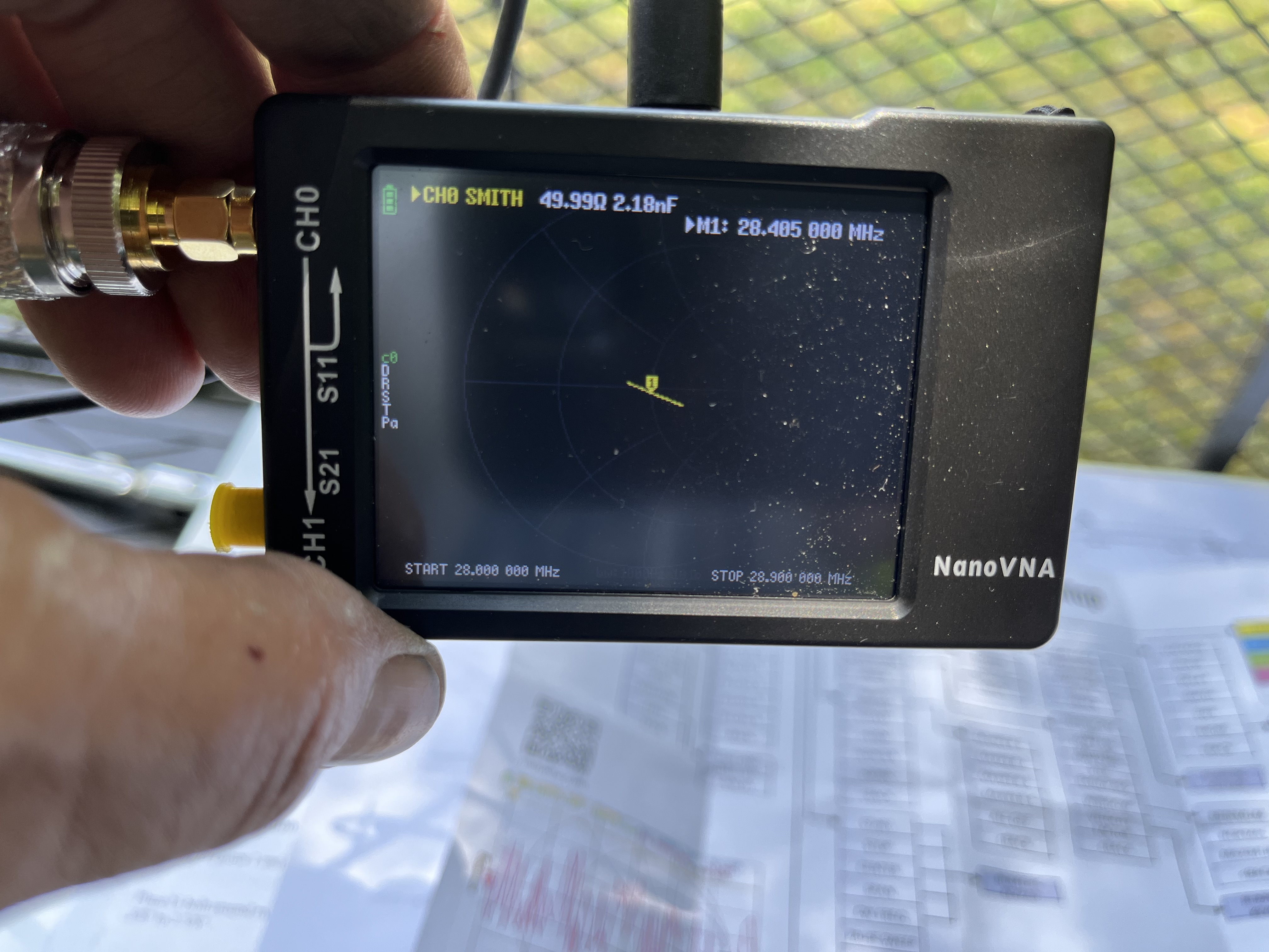

I finished it last weekend and haven’t transmitted on it once. I tuned it to resonance at 28.400 with the mast laid over and the reflector about 6’ off the ground. It very usable for all of 10 meters. See Nano
VNA display below.
After raising the mast to full height, I get an SWR of 1.5-1.7 at 27.385. No issue using it there. If I want to go lower in frequency, I have an outboard tuner.
I did remove all of the rivets and used stainless hose clamps on the elements. I did not use any larger tubing. With some straightening, all of the original tubing was usable.

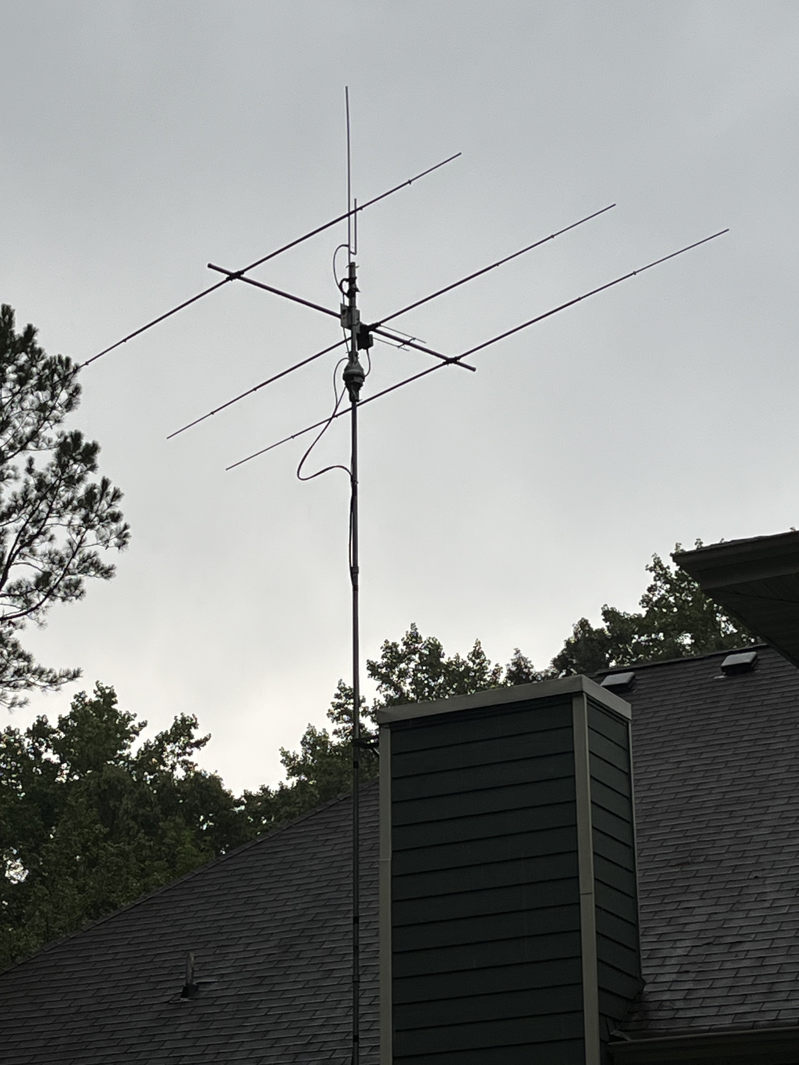

Below is the finished product. I am liking the HD-73 rotor and if the afternoon lightning storms stop I will have to give it serious work out.
