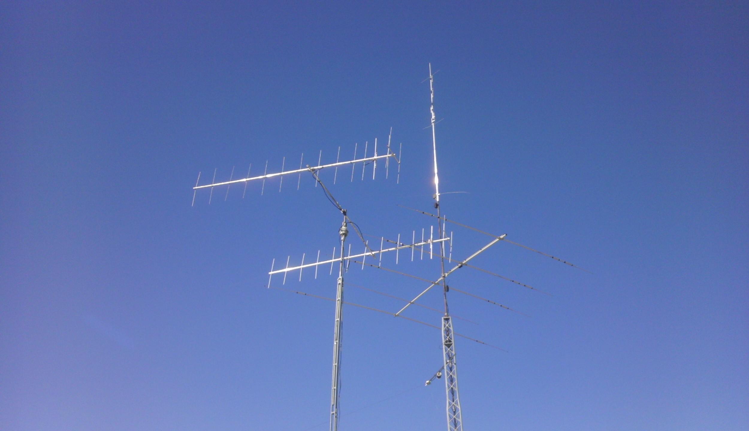

Well my Antenna farm is getting larger :thumbup:
Just added stacked Cushcraft 215's @ about 35 ft. (one real 215 and a home made copy of) So far so good for repeater work, Gained a couple DB on the local repeater for recieve that is like 45 miles away. Hit the Kingman repeater that is 130 miles or so +/-
Dont know how well it will do SSB being vertical?
The other Antenna's are Hygain TH5MM for 10/15/20 And a Cushraft R7 for the warc bands and 40 meter
Do not know if you can see the end feed wire below the Tr-band for 80/160 but can see the choke sticking out on the pole for mounting it..
Also just got a 80 meter full wave dipole waiting to put up next
