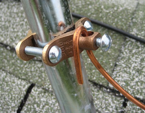

Even though your mast is dug into the ground some, I would still recommend driving at least 1 or more 8 ft. ground rods at least 3 ft. from the antenna mast and attach the proper size ground clamp near the base for your mast. Then run 4 gauge solid copper ground wire from the mast ground clamp to the ground rod(s). See pic below for an example.
MAST CLAMP
GROUND ROD CLAMP
The idea here is to break the coax line and ground the coax shield. This actually provides a good D.C. ground in series all of your radio equipment connected to this coax line.
Then in the event of a high static discharge near the antenna, the Polyphaser should blow the internal gas charge tube therefore shorting the coax's center conductor and sending this current to ground.
As I said before, your fiberglass antenna probably won't survive but at least all your connected radio gear has a more than fair chance.
MAST CLAMP
GROUND ROD CLAMP
My confused mind needs a little more advice. If I use more than one ground rod, does that mean I will also use an equal number of mast clamps and ground wires running to each of the ground rods?
And, regarding the poly phaser - which I now have!!!! - if I bolt it to the mast pole as you suggest, should I also run a ground wire from the poly phaser to a ground rod, or is the mast pole sufficient for that?

Yes, each ground rod needs to be linked to each other so use 1 ground clamp on each ground rod so you can run the ground wire from each clamp to the other. Remember, one 8 ft. ground rod is better than none, but 3 is best.
Your mast is metal and conductive so your good to bolt the poly-phaser to it under the the antenna and use a short coax jumper as suggested. Then use a pipe mounting type ground clamp at ground level at the base of the mast and start running your ground wires to your ground rod(s) from there.
All these ground clamps can be found at most hardware stores. The ground clamps come in various sizes for 1/2 inch pipe all the way up to 3 inch pipe that I usually see in stock so finding them shouldn't be a chore.
Get the largest size solid bare copper wire that will fit in the ground clamp's holes.
