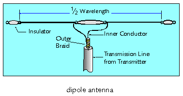

That a99 will die with 3kw guarantee. I would go with a half wave dipole or similar. Wire antennas are hard to see compared to a big ole vertical sticking up in the air. And they are cheap to build. Or get a coily vertical

Hoa? Bummer. I would go with a wire antenna, 10g or 12g wire and a balun in the center. Hard to see and will handle your new box. They are really simple to build. Lots of help online and on here. Someone will chime in with dimensions soon im sure. Google dipole calculator, it will give you the correct length. Plus with that antenna you have orientation options like horizontal, vertical, sloper, inverted v etc

The math required for calculating a 1/2 wave horizontal wire dipole is so simple you could train a monkey to do it:
468 / your favorite center frequency in MHz = total wire length (both "poles") or 1/2 wavelength
Example 468/27.185= 17.2 feet total wire
234 / your favorite center frequency in MHz = length of one "pole" or 1/4 wavelength
Example 234/27.185=8.6 feet per "pole"
The formulas get you close, add a little for attachment. Tune/trim for low VSWR (or not) and key the mike. It will work.
