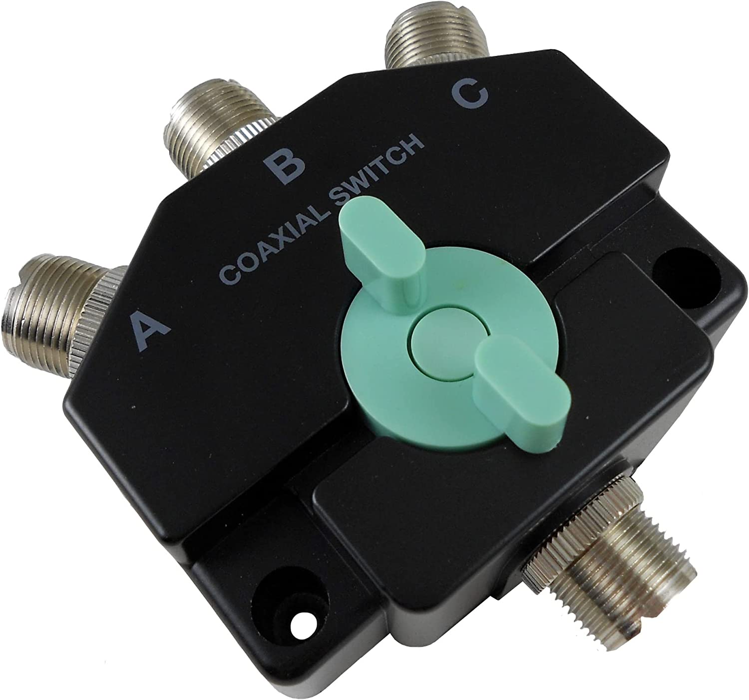

Antenna Selector Switch a major upgrade from the common far lesser quality tin foil housed selector disk sort. Not a name dropper I am but mighty fine junk comes to mind. Sad I am, wasted hard earned blood money on two of those cheap 5h1t sorts moving onto two cast housing dual selector sort, painted sky blue, with no backside access. Which also turned out to be shite.
Have a 1st of these upgraded types in operation as an antenna selector and now a second for radio selector. This second, pictured, was the more expensive (+ $30) model on the Amazon market, several months ago. It has face markings on it where my 1st did not. I remember is as the $30 more expensive model and is now $2 less than the model with no face paint.
Just like the 1st, this 2nd was in need of pre-install inspection and function tweaking; to insure positive internal contacts. Just like the 1st, this 2nd had 1 of 3 pair of contacts screaming for attention.
The price is not cheap but the assurance of connectivity is worth it for me. And you can't say it's housed in tin foil.

The only accessory I use between my transmitter and antenna is a SWR/Wattmeter, because monitoring my rig's output is a must. Every connection in the Coax line is a problem waiting to happen. Even if your connections are 100%, each switch, relay contact, etc. introduces losses and degrades your signal. There is no such thing as a no loss switch.
After spending the time (and/or money) to tune your rig to the max, why add inline accessories that steal some of your hard earned output ??

I am assuming that ninety-degree coax connectors and "barrels" fall into the same category as an accessory, and I stay away from those.

Can't and won't argue, el Capo. Agreed! The loss I find minimal, were I able to measure it down to a knat's abdomen. Craps switches, aforementioned mighty fine junk, are an exception I can't afford. I can see their impact in the SWR. I've seen no such, apparent, degradation in these flavored switches. Wouldn't highlight them otherwise.
And I use choke Baluns which I find no SWR reflections of.
Now these "accessories" I avoid. Occasionally I have to introduce a barrel connector; and, I ohms check them all to find the one with the least resistance reading; it's likely corrosion build up. The 90s, I avoid these like the (moderator edit) plague.
That looks like a good switch. I have had good luck with Alpha Delta.
:o DX Engineering Delta-2B price was the original price for the NoName 3 Pos (NN3P) unit I posted above; B4 they cut it by almost 1/2. And here I said NN3P switches weren't cheap. I'd expect them Delta-2B and 4B to be making power, with signal enhancement :o. Are their inner workings accessible? What sort of switching mechanism?

I have never had the one I have apart. I know they sell extra short protection slugs Incase there is a lightning strike. Very solid switch.
Specs on it are most attractive. Grounding antennas when not in use, big plus+
Surge protection, another big plus++

My amplifier has (4) antenna ports so not extra switches are required. All of the radios have (2) antenna ports as well if I wanted to go that route, but I let the amplifier take care of it & it switches between up to (4) antennas & (2) radios automatically.
Most of the antenna selectors I use are either built into the tuners or are remote. Case in point with the latter: A Drake CS-7. In my case, the remote unit is used to select a multi-band sloper from one of 5. It shorts the feedlines of the unselected ones, effectively turning them into reflectors.
For an in-shack accessory, the A-D units are what I'd go with if I was selecting one from scratch.
