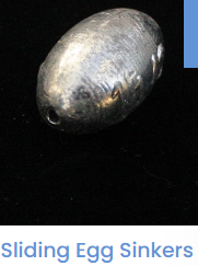

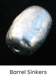

There is a purpose/reason for the corona ball. Otherthan the dampening of lightning bolts from the ends of a high powered antenna, I contend that it serves to preserve the null areas off the end of a monople. How much wasted energy is directed into space, towards the stars, I've no idea. But to state that when missing it will not effect anything is no reason for it having been in place to start. It wasn't install so you wouldn't poke your eye out.
View attachment 61071View attachment 61072
A corona ball has no other purpose than dissipating static buildup or making a poke in the eye less damaging. It has no affect on pattern. Current maxima in a 1/4 wave vertical is closer to the feedpoint.
