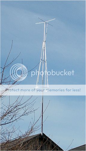

I remember Bob making the model in the image. I though it was a real NTO at the time. He had to tell me that he made is using a Vector. I think I told him that was probably what Sirio did too, and it looked real. I said that Sirio likely did the same, made it out of a Vector, and visa versa, and that those folks were just smart businessmen IMO.

I linked the thread about the NTO I built in the post with the picture of my V4 to NTO photo.

i thought of a potential better way to modify this and other antennas eddie, the idea came from the top-one i made,
a vector with its cone turned upside down is the same thing,
http://i5.photobucket.com/albums/y152/ukmudduck/topsyturvey.png
convert a vector into 2 x 1/2wave
I got pissed because I thought you're trying to trap me into commenting like Donald did without specific dimensions for the model. If EzBob can't show the dimensions, or you can't add them by hand to the image, then just type them in long hand as part of the text and we'll see if your idea works.:sneaky:
#1 might work if the dimensions are right, but I don't see it reasonably working in #2, and that is all I'm going to say.

Are you planning on setting this NTO up with a full 1/4 wave element in the top too?
no eddie, i won't be setting up the nto with a full size 1/4wave, we know what the hat does with regards bandwidth and height of current maxima,
the interesting mod to me is the topsy turvey 2 x 1/2wave.

its about converting a vector to a 2 x 1/2wave by inverting the cone like the new top-one and using a phasing stub/coil 1/4wave up from the feed-point,
there won't be much separation between the 1/2waves so you can't expect 3db gain but it could be better than the stock vector on the same mast.
