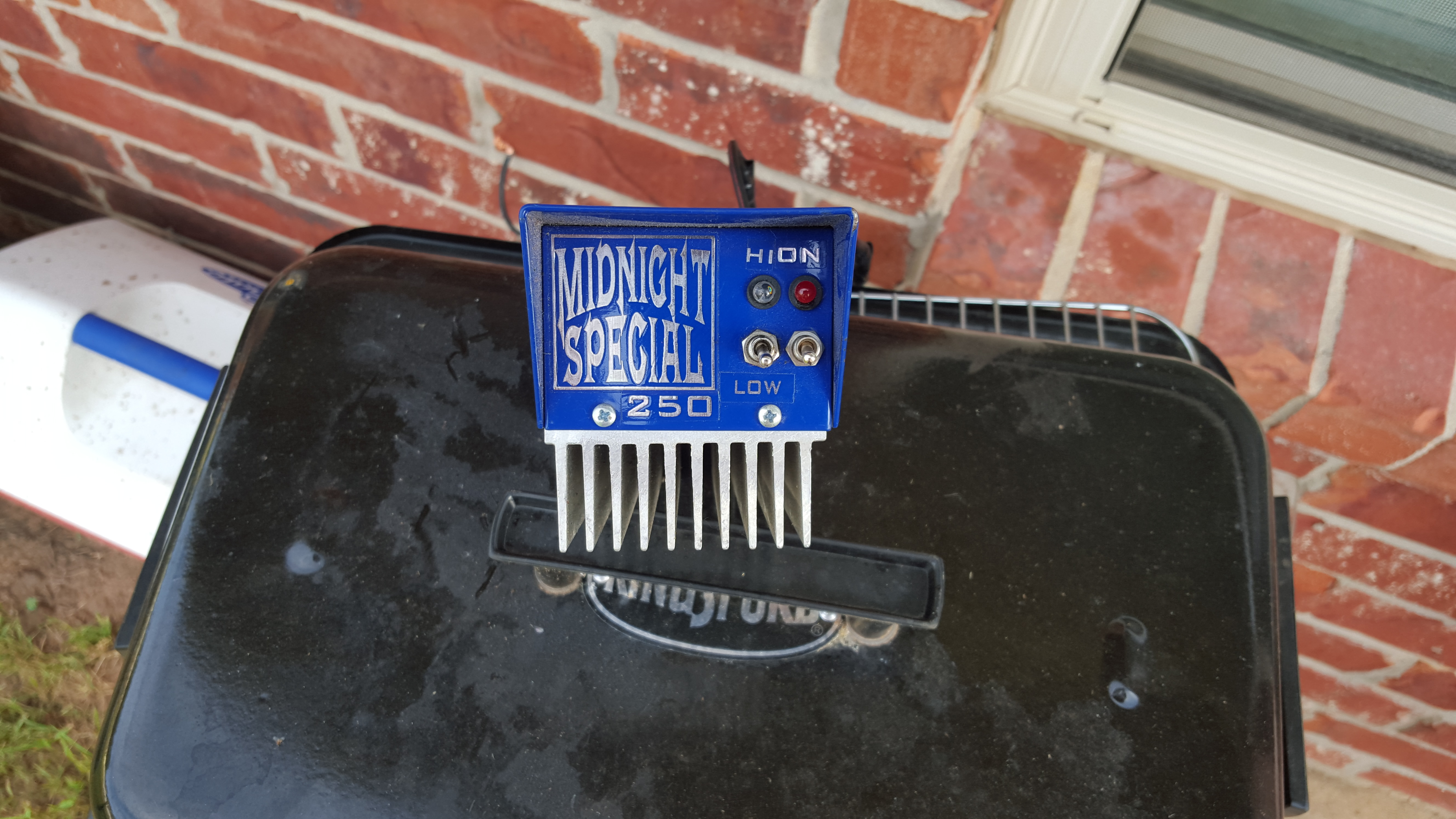

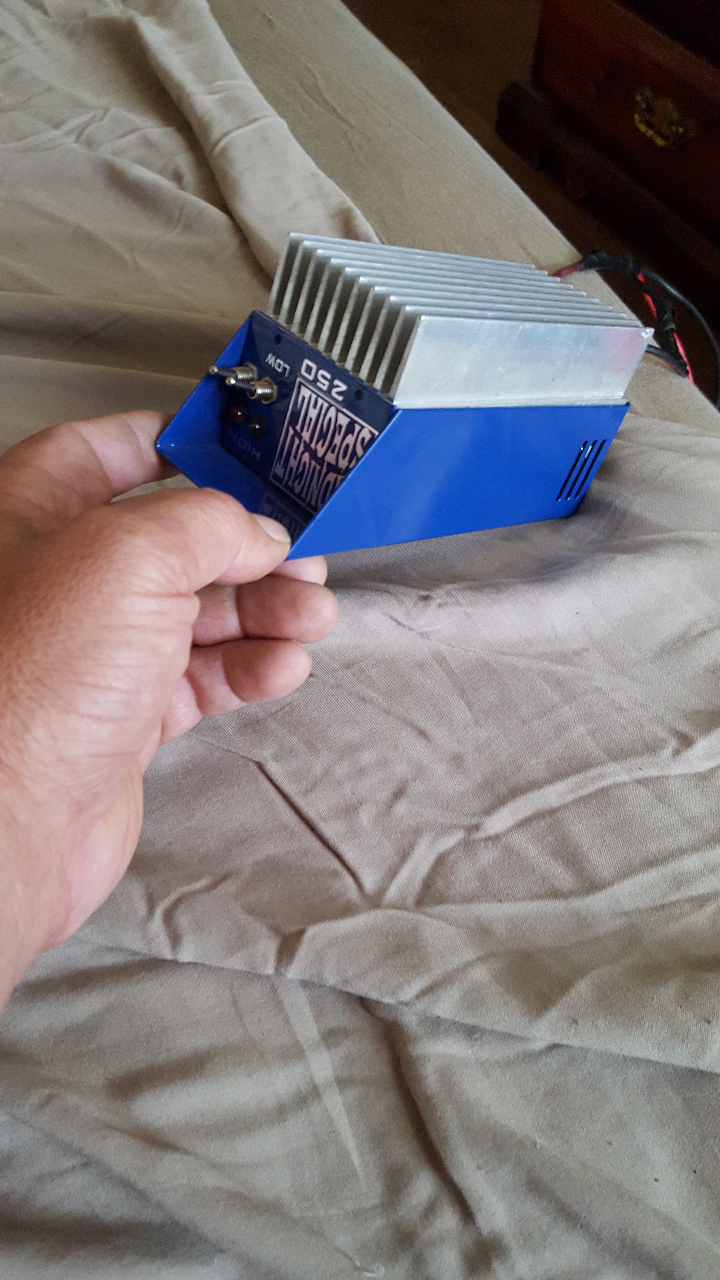

A couple of pics of it would go a long way!! I understand if you do t want to post them, but it's the best way to help us see what you have. The name could be made by a bunch of different companies. Or some more detailed info. Pics are IMO, the best. 2-4 pics showing front side and back at least. Good luck finding out what it is. Hard to tell with just a name and very little detail. Good day.
Thaxton guys for feedback, got some pics, didn't take cover completely off as didn't have necessary tools and looked like a bit of a delicate job .thnx

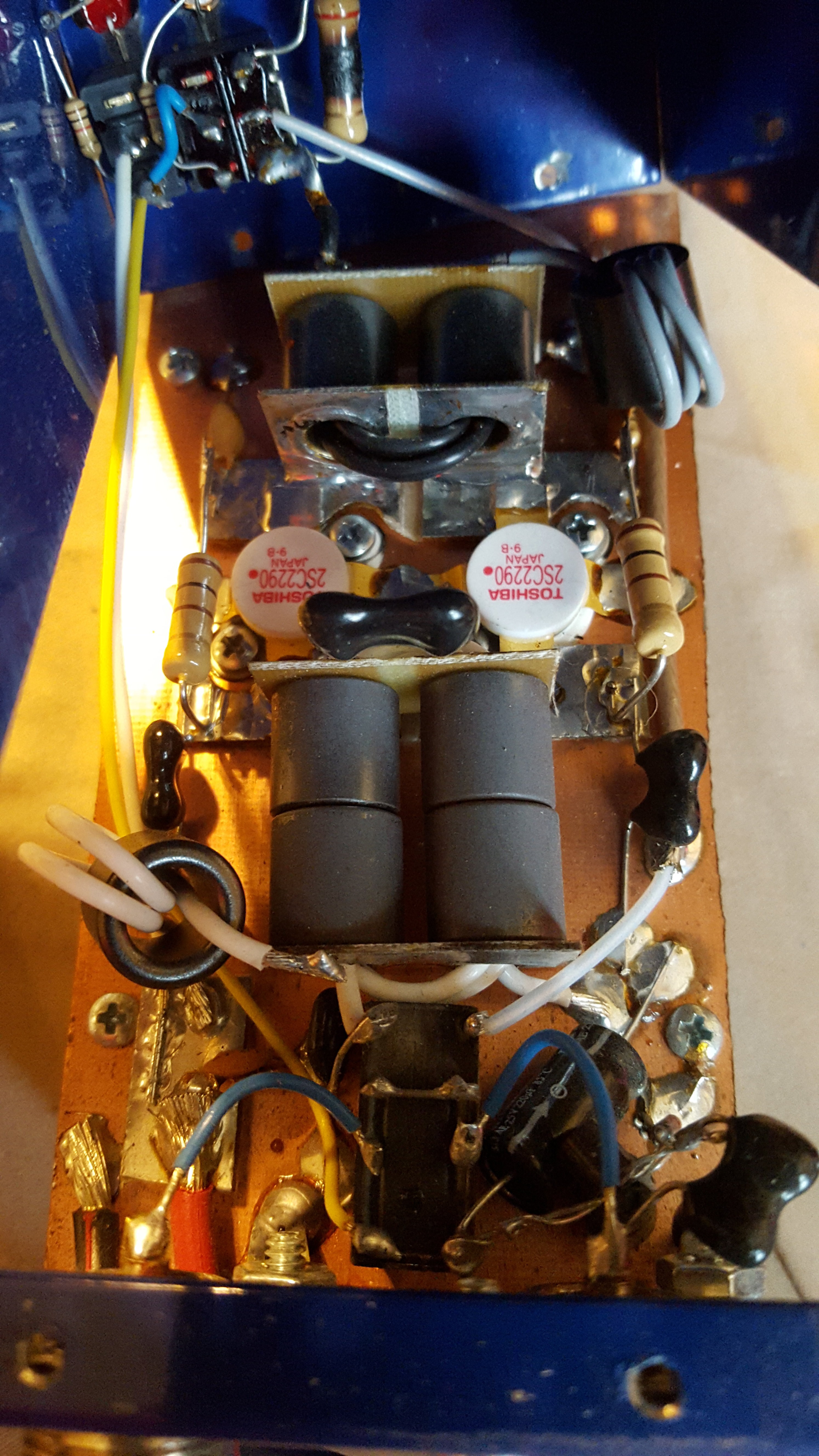

I see a burnt resistor on the circuit that stayed on the cover.
Don't hit that amp with high drive radio.

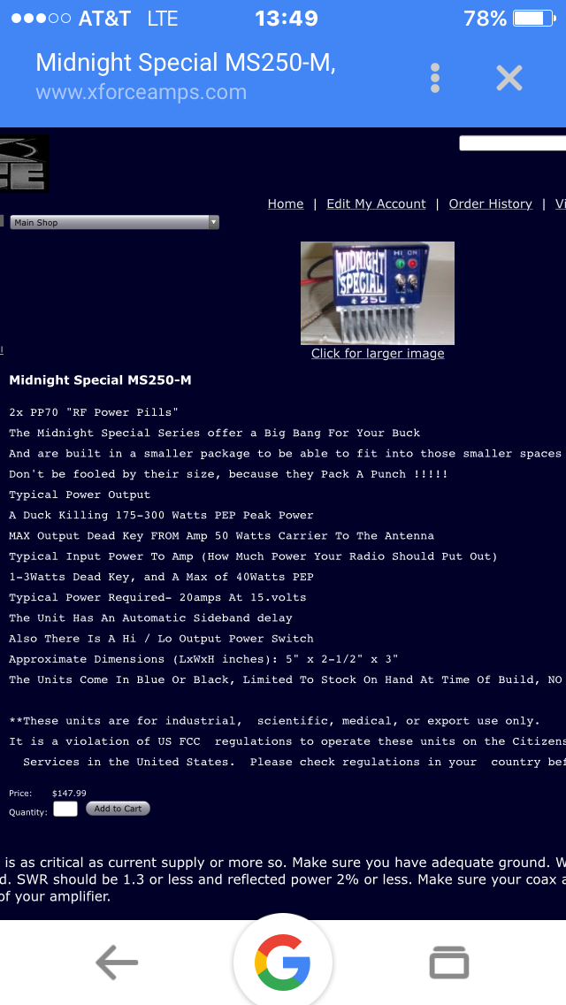

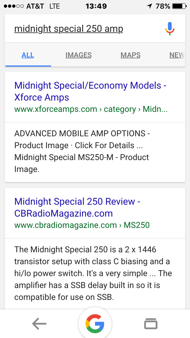

That is an economy amps made by X-force. Info can be found is on it from X-Force's website which is xforce.com. If you google that amp this is what comes up. Note the photo below.
The new ones come with the Power Pill transistors or PP70's which is supposed to be an equivalent to the Toshina 2290's. Or those may mot be the original transistors either the Toshiba 2290's unless that is an older amp or someone had them added. I don't know. But I do know it's a class C amp. I am not an aamp tech so I'll let them tell you about the way it operates more in detail. But like said, keep the input low. Dead key as well as PEP wattage. JMHO. But I would have it looked at before you keep messing with it. You may end up damaging it worse than it possibly already is. Again, JMO. Hope this helps. Good day
