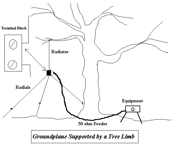

Hard to beat an 11 meter home brew 1/4 wave wire ground plane antenna hung high up in a tree when cost is a consideration. Just need a single SO239 coax connector, 14 gauge wire, rope and a soldering iron. Just make sure you get all the wires cut to the proper length and feed it with some good low loss coax from the radio.
http://www.iw5edi.com/ham-radio/?fabricating-cb-antennas,135
Just a reference drawing for how to mount it. This one shows a terminal block at the wire junction, but the SO 239 is the way to go:
