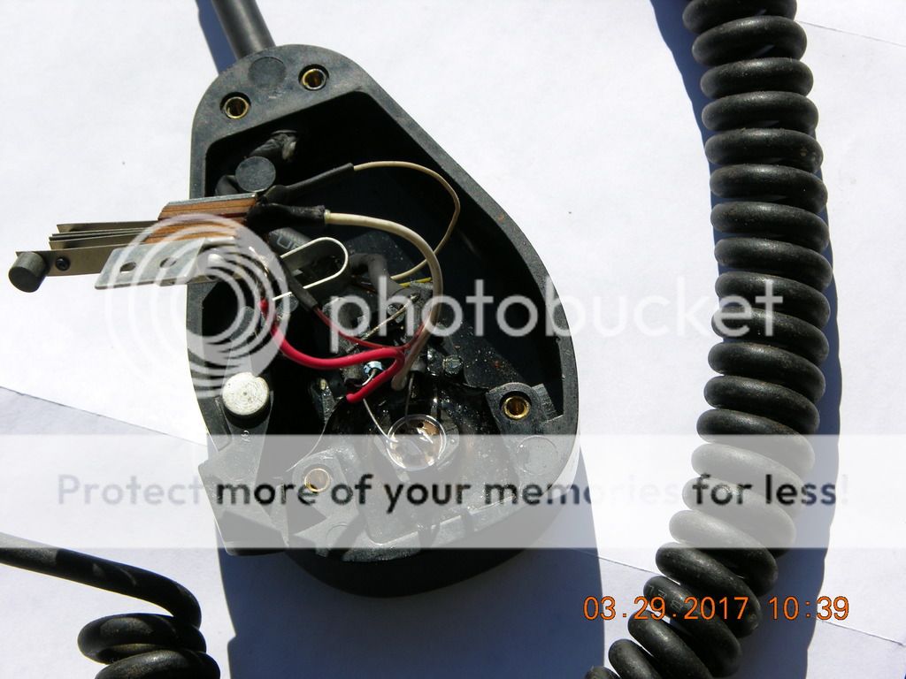

I have a few of them and even with a matching transformer, the audio is weak although sounds nice. I plan on retrofitting one with a noise cancelling electret in the next couple weeks.
Noise cancelling is achieved by sound entering both the front and rear of the microphone.
frequency response isn't too impressive.
ANM-5254L-R electret is what I plan using.
The element is fairly linear; but far from having a flat response. It is down -15db @ 100hz and +10db @10khz.
Have you used this element before - RPC?
Kinda reminds me of the D-104 response - IIRC . . .
It sounds really good but the audio level is a little on the weak side even with the matching Transformer added to it.
just out of curiosity where did you find that specification?
Sorry, I thought you were talking about the M80-C/U.
I'm still trying to get the mic gain turned down to the proper level with my new mic I just built. It seems to be kinda decent and I had a good audio report with it this morning.

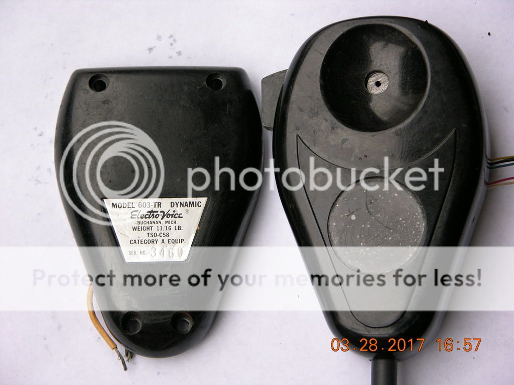

I epoxied one of those elements into an EV 603t housing and this is what I plan on using from now on in the mobile.
here is a pic and a sample of the line level audio. No over the air recordings yet though.
Keep in mind I'm still trying to figure out the levels.
Once I figure out the levels, I'll be putting one of those electrets in the M80-C/U
Mic gain was too high here...These ANM-5254L-R electrets are ungodly loud with 5 volts of phantom power. Gotta choke that mic gain way back to compensate.

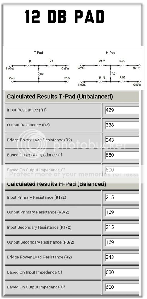

Depending on what the output level is you might need to build an attenuator pad to reduce the output level To 45 millivolts or less.
Here is a handy calculator to calculate the necessary dampening Factor.
http://www.sengpielaudio.com/calculator-amplification.htm
Here's a handy calculator to calculate the values that you might need to build your attenuator pad.
http://www.nu9n.com/tpad-calculator.html
