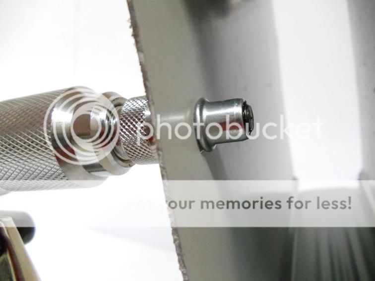

What kind of amplifier is it? If it's one of those ones that's a basic aluminum box just use a nutsert tool to put some threaded inserts (nutserts or riv-nuts) into the side of the sheet metal to allow you to attach an angle bracket with a bolt.

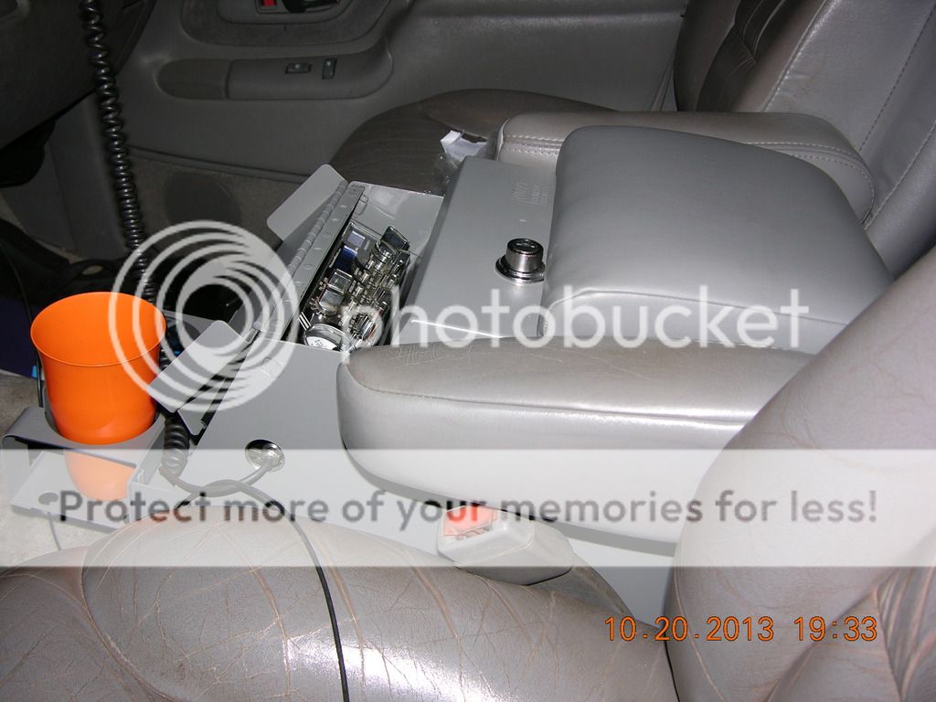

You could strap it to a seat frame if you didn't want to put holes in the chassis. I recall installing neon transformers in Southern Cali and everything had to be "strapped down" in case of seismic activity.
http://www.ebay.com/itm/2pc-Strapping-Banding-Tool-Machine-Tensioner-Crimper-Set-Sealer-Packaging-Poly/171376872228?_trksid=p2047675.c100005.m1851&_trkparms=aid=222007&algo=SIC.MBE&ao=1&asc=35389&meid=b2c7a7bb95834f248bed64083983354a&pid=100005&rk=2&rkt=6&sd=121861635622
This is what I did for my Chevy Tahoe.
My Texas Star DX 1600 V was going to bolt to the back of the console .
