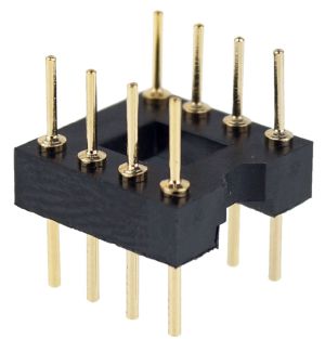

You can solder them into precision dip8 socket and put into socket on PCB
Or use
OK, trying to avoid removing the boards and sockets. I'm at the ordering stage Think I'm going to try it. Leads look long enough. There are metal can-type Fairchild 748's on eBay for approx $10.
Wait a minute, that's a double-sided male pin adapter in the pic? I never saw one before. Yeah that would work. It took me awhile to recognize. thanks

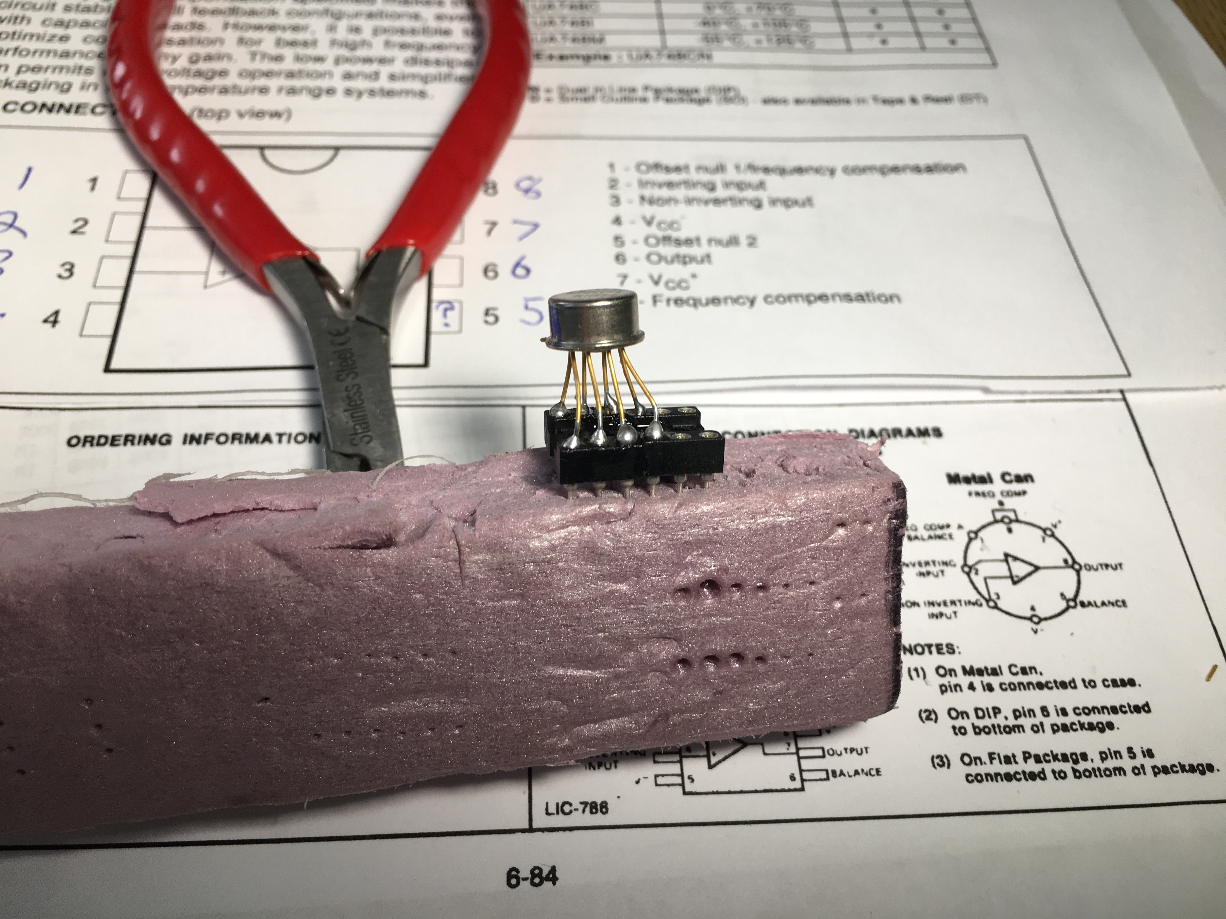

found these on ebay. May not need anything though as the Can type 748 delivered today. The leads are long enough to use existing socket......I think. I'm working through the pinout conversion now. Going from AM748 with TO5-8 round can and a regular ua748 8 pin dip.
