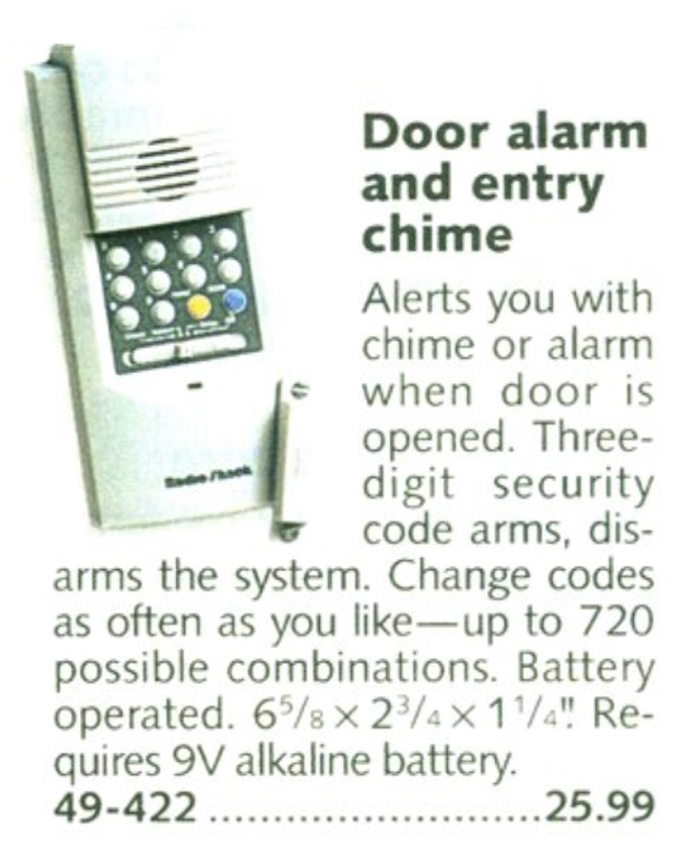

Anyone have a manual or defaut code for this?
357
Walkin' the dog From Chilliwack BC
Sep 12, 2009
1,519
897
123
52
Chilliwack, BC
www.youtube.com
I had the manual but lost it.
Cant find info anywhere.
Found it, in case anyone else needs it, default code is 1234
