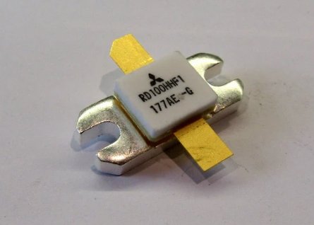

The main question though is there a difference in RD100HHF1-101 RD100HHF1-102 RD100HHF1C RD100HHF1C-501
RF parts only has the RD100HHF1C-501
From what I can tell, *501 is ROHS and has a bit shorter lead length.
But of all these, are they all the same mosfet?

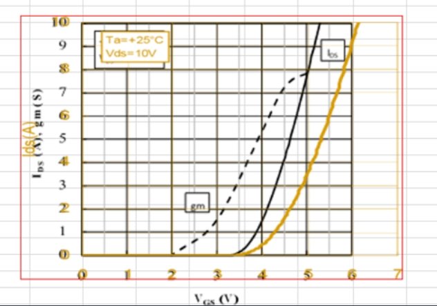

I found this.
orange is the RD100HHF1-101 black is RD100HHF1C-501
What am I seeing here?

So what I can find is the "C" version "offers slightly improved performance in terms of gain and efficiency over the standard version."
So the older version ended with rd100hhf1-102 and the C version starts at RD100HHF1C, *C-103 *C-501 *C-502
So the graph above shows this "slightly improved performance"

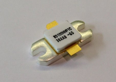

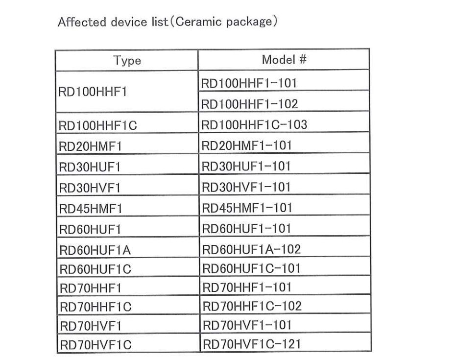

and I found this:
and this:
Also the "C" versions have shorter leads

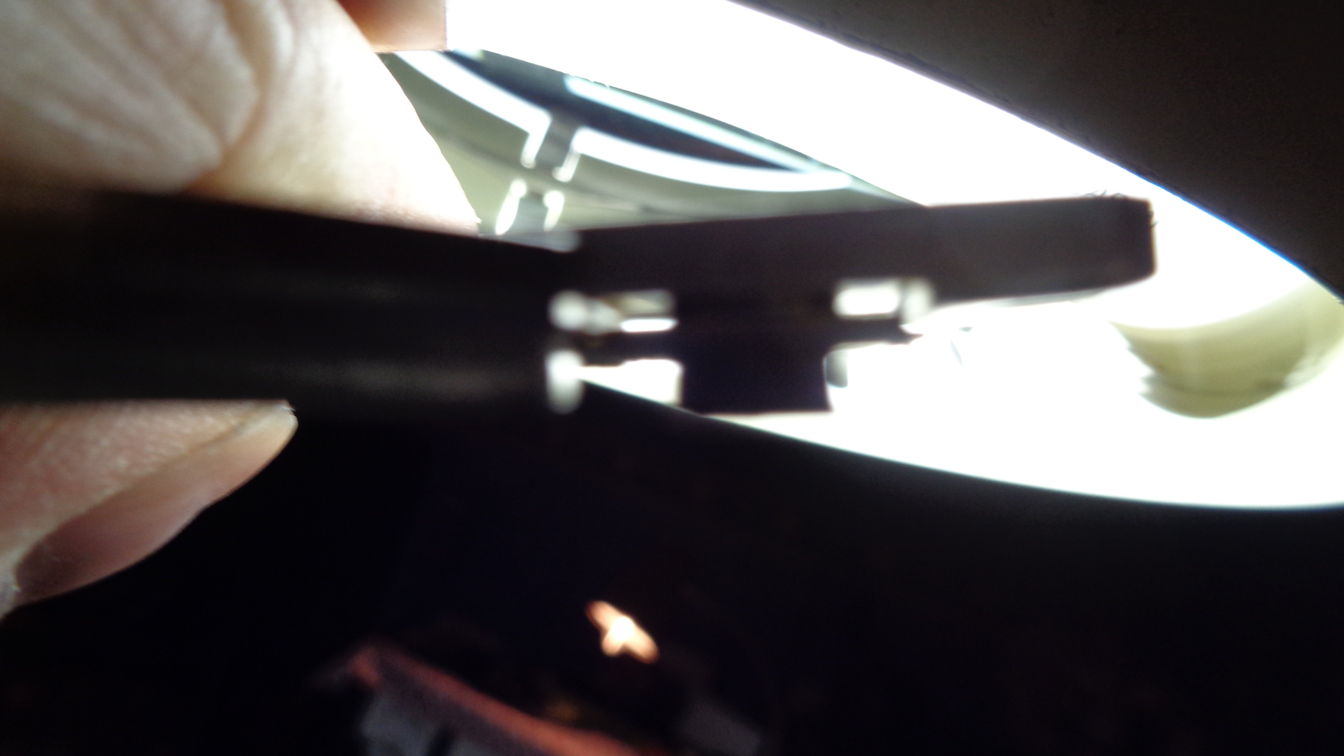

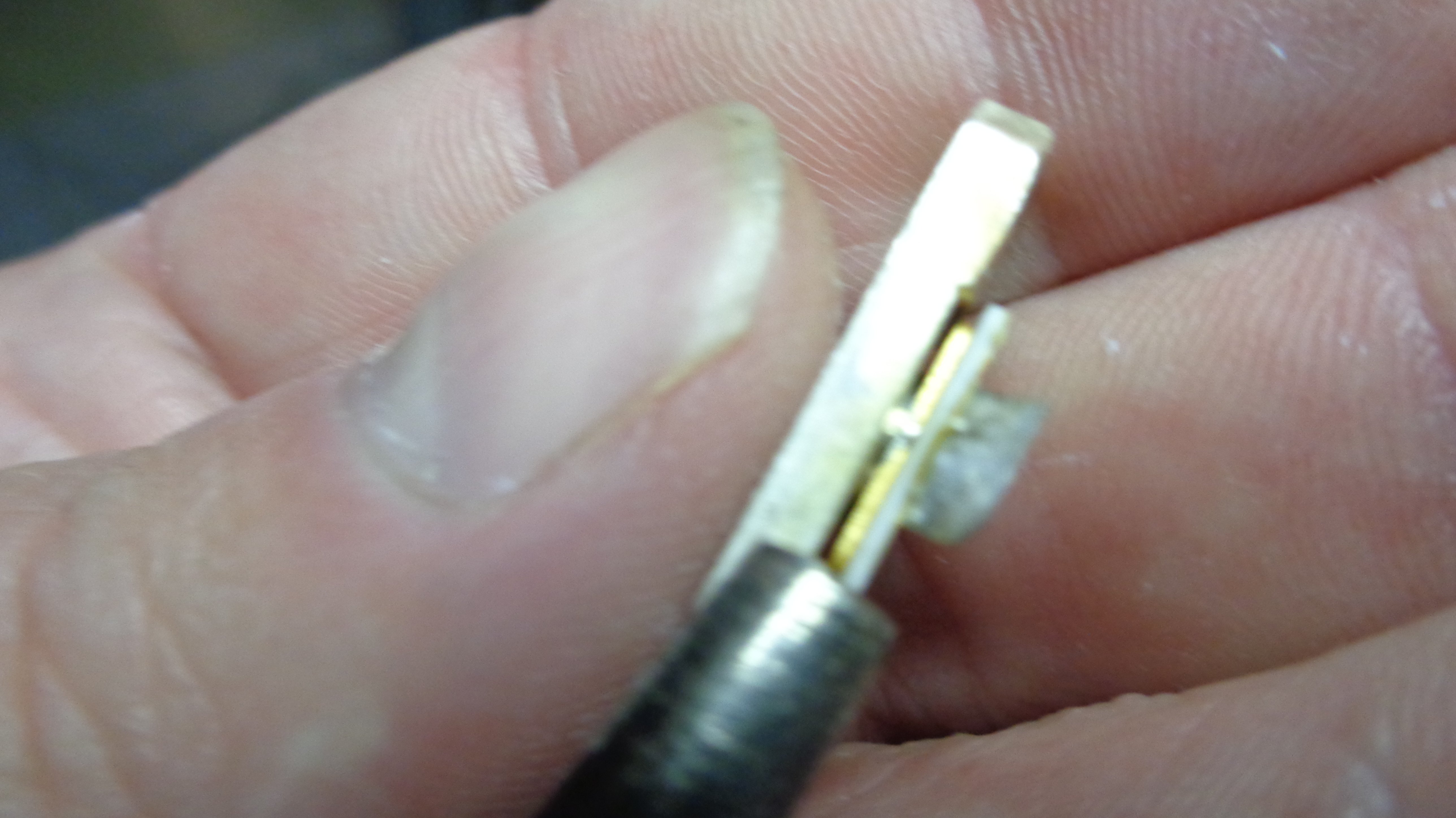

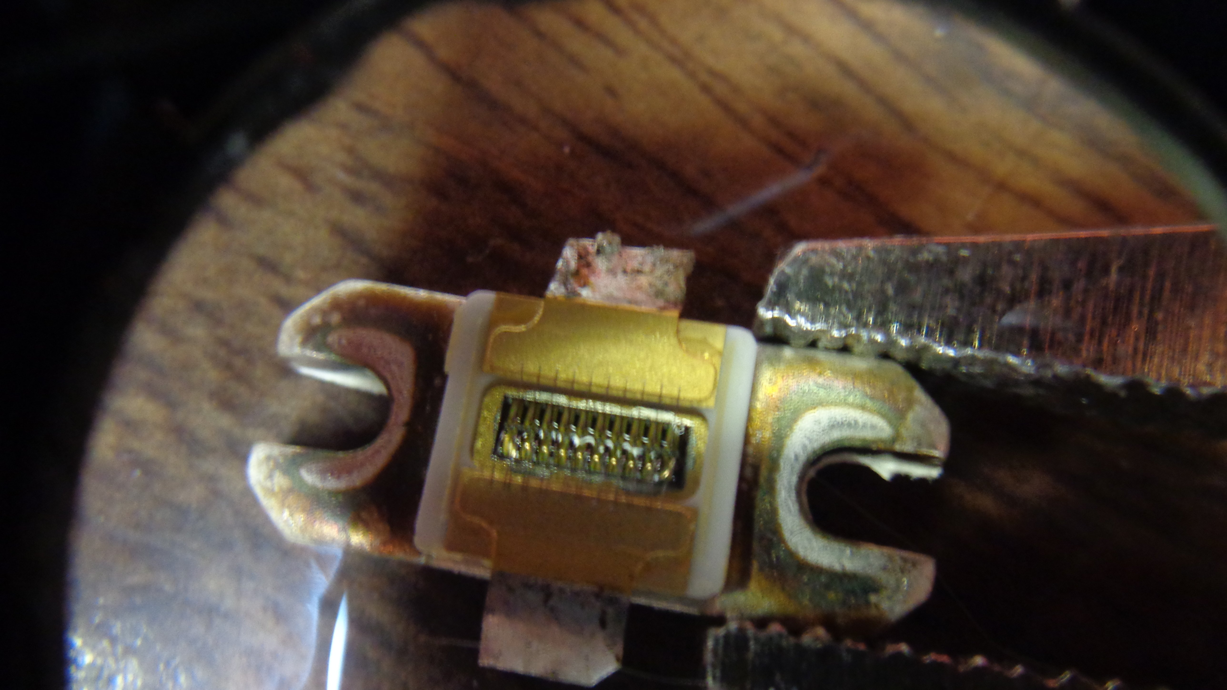

Cant see anything blasted. I see some gold sputtered on the sides? thats solder or something, looks bad at that light but its shiny
