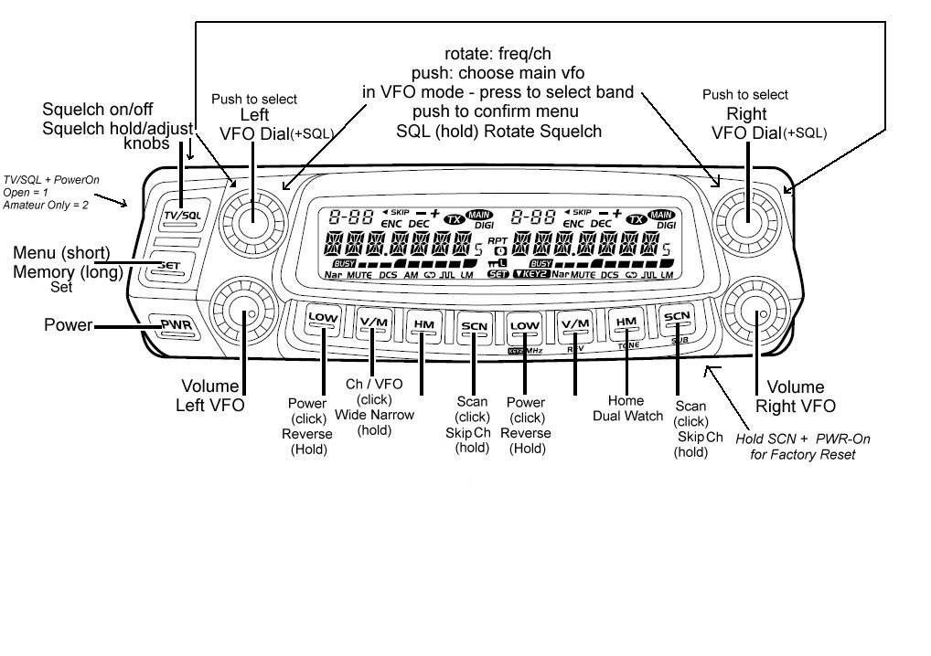

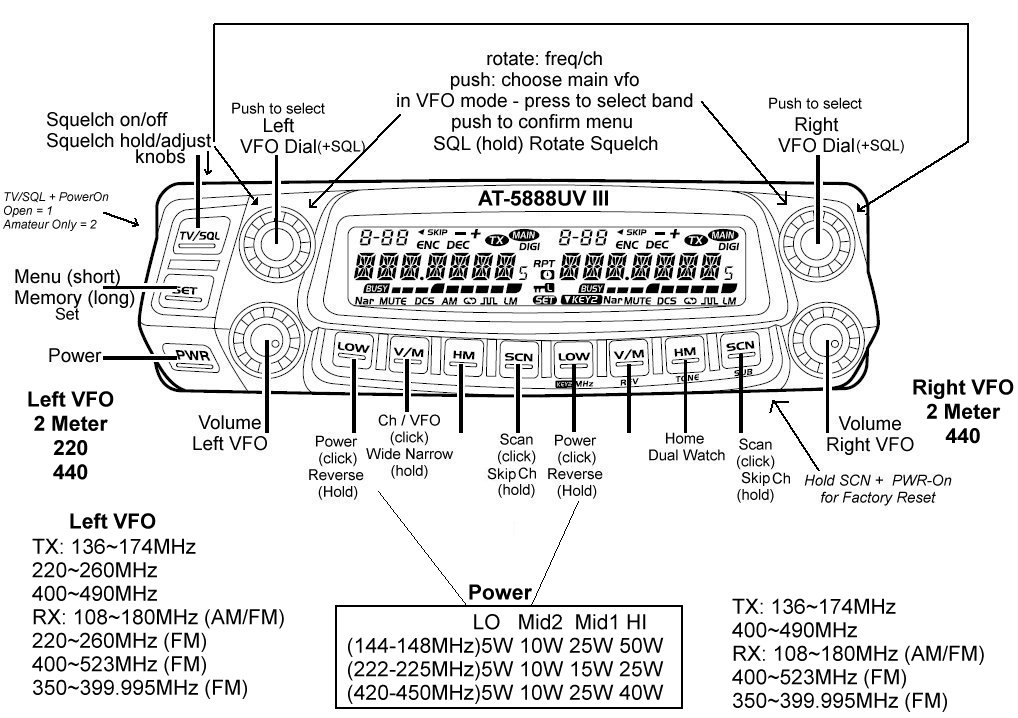

A better front panel diagram than in the manual.
