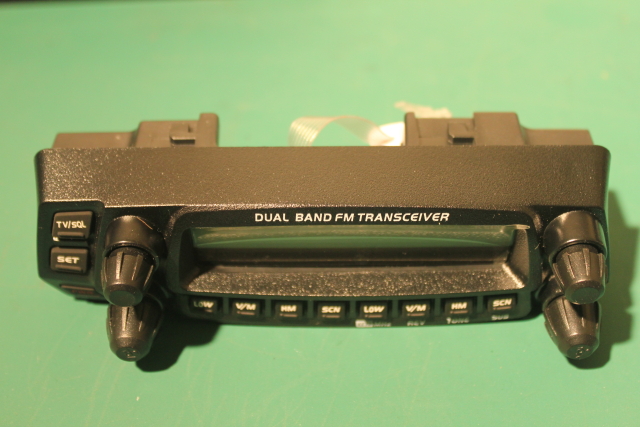

It seems to me that they leaned on the user interface and ergonomics of the Yaesu FT-8800 when they designed this radio. As you can see from the face, there are a lot of similarities:

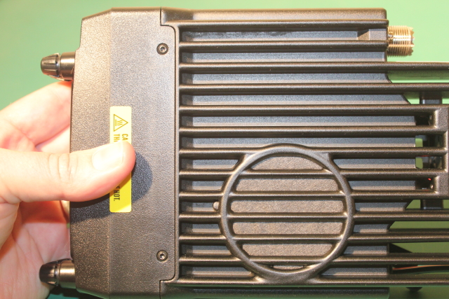

Here's a shot of the complete radio from the top where the large internal speaker is located:

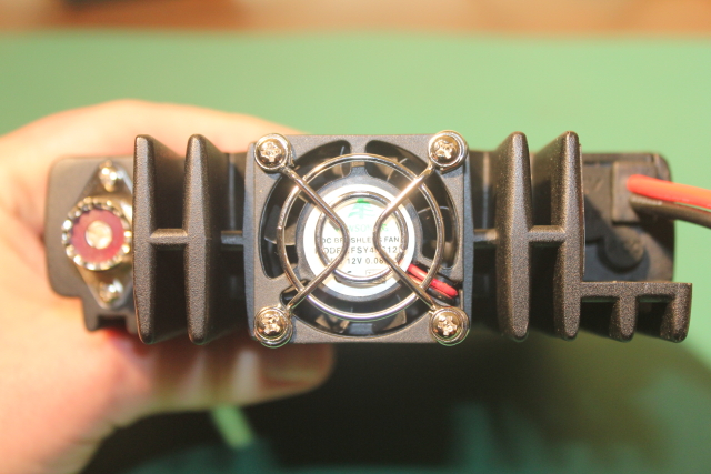

The radio body really is fairly small and as you can see, the whole top is a big heat sink. The back of the radio also features a large heat sink with an attached cooling fan similar to the Yaesu FT-8800:

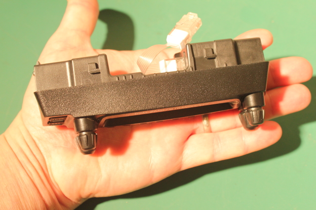

The face of the radio is detachable and is slightly thicker than the similar Yaesu FT-8800:

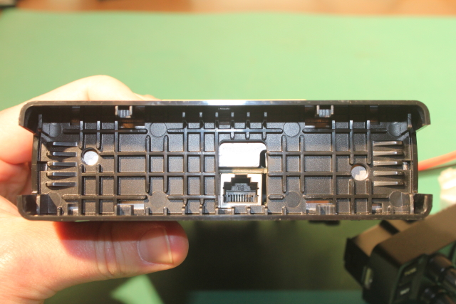

The back of the face has a small, flat ribbon cable with RJ-45's attached to mate it to the main body. This cable is replaced with an included, straight through CAT 5 cable if you want to remote mount the face:

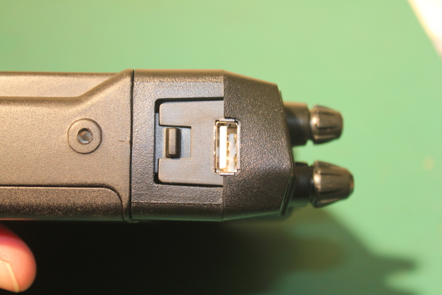

When the radio face is mounted to the body, everything is nice and flush. In this picture you can see the face release, as well as the USB port for programming.

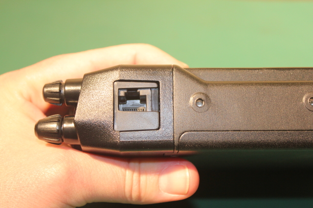

The right side of the face is where the mic connects. There is no connection to the body for the mic.

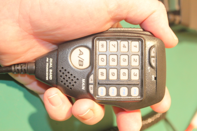

Speaking of the mic, here is a close-up:

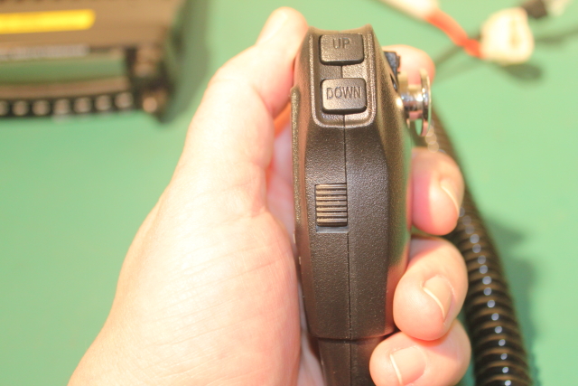

This mic is actually fairly interesting and I'll spend some time detailing its features in a later post. In the meantime, here is a pic of the frequency/channel Up/Down and lock buttons on the mic:

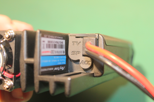

Lastly, the radio features some interesting accessory ports on the back side. The top port is a "TV/AV" port which, as best as I can tell sends the display and audio out to a TV monitor. There is also an external speaker and external power jack. When connected to a switched ignition accessory circuit, the external power jack turns the radio on and off in conjunction with your vehicle.
