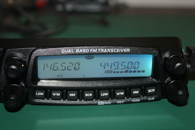

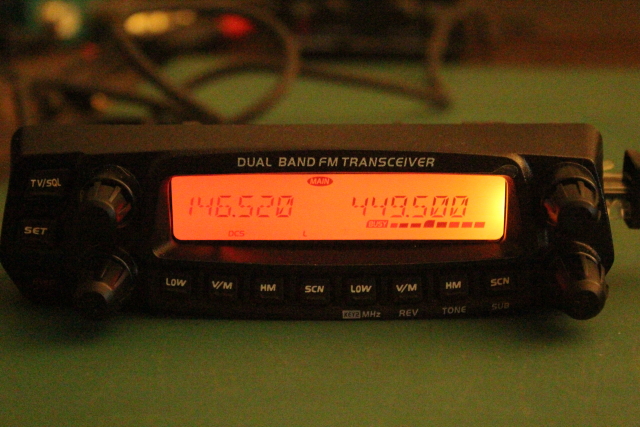

The display of this little mobile is actually pretty nice for a basic vhf/uhf rig. One of the more interesting features is the ability to change the display color. The settings allow you to adjust the radio for Red, Blue, and Green. Here are some pics of the display with each of these primary colors activated:
When I first found the display settings for Red, Blue, and Green, I saw the settings that range from 1 to 32, I thought that turning up one of the color settings would activate only that color and change it's intensity. I was dead wrong on how it worked. What it actually does is change the mix of that color in relation to the other two. Think of it like an RGB setting when editing photos on your PC. By changing the mix, you can make almost every shade imaginable. It's very cool!

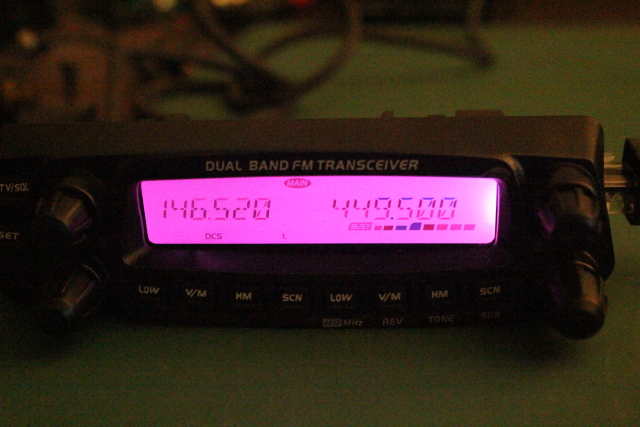

Here's a example where I made a purple display:
