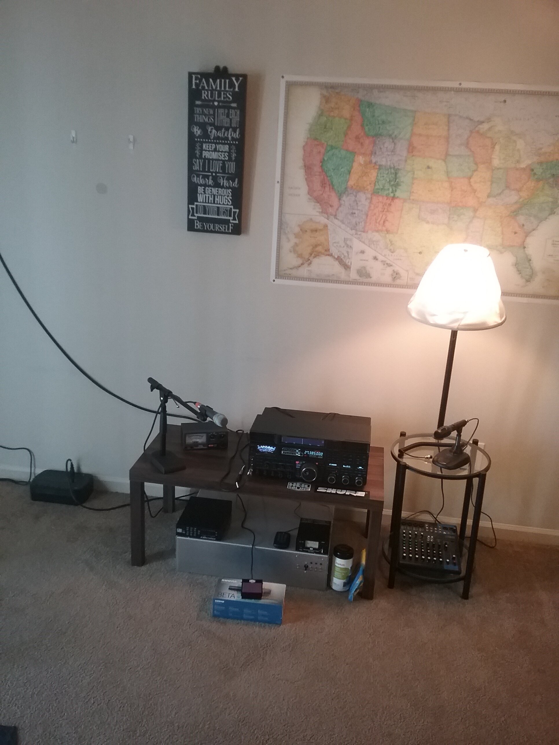

Just a little update. Things are the same as far as the setup. Antenna swr 1.1-1.2 across the band, over the summer talked a lot of skip, locals still don't think i'm in an apartment. I kinda want to step it up a notch or so, (AMP)!.....Have 20amps of service in my living room and have ran just the 200watts from the radio, any ideas? Tube or transistor, crazy but do it, or just plain stupid and leave it like it is? I've got a few linears and wanting to know if it would be overkill being in the apartment still... I've got the amp itch!

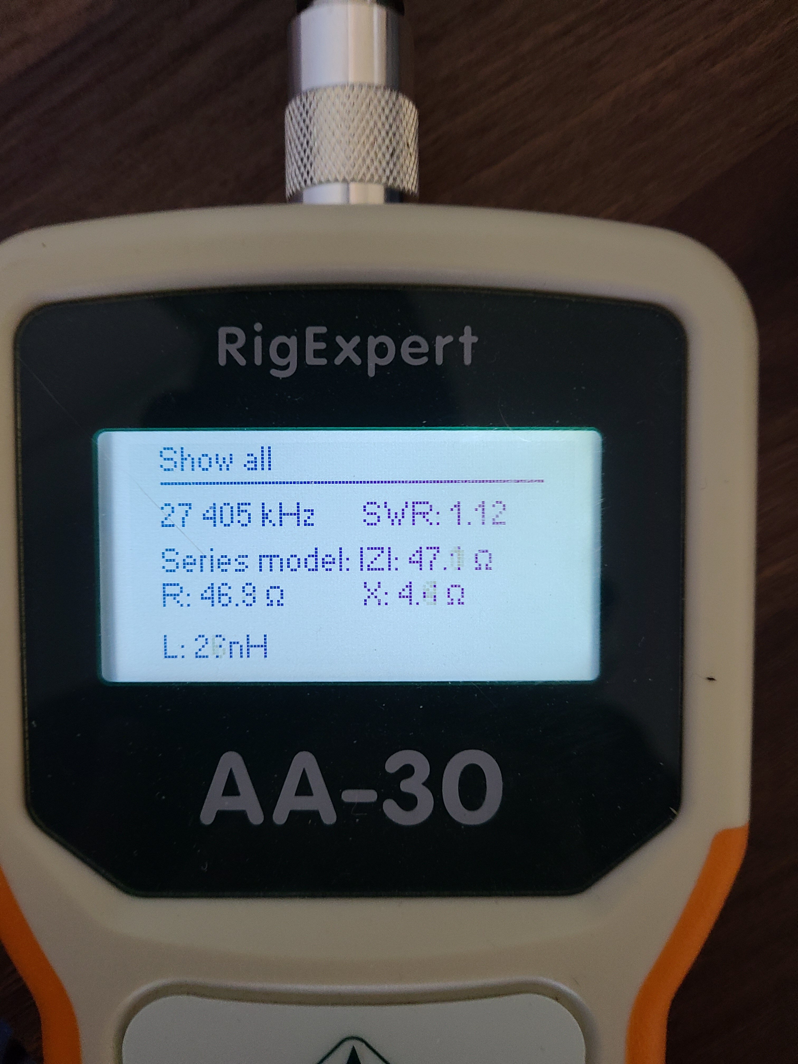

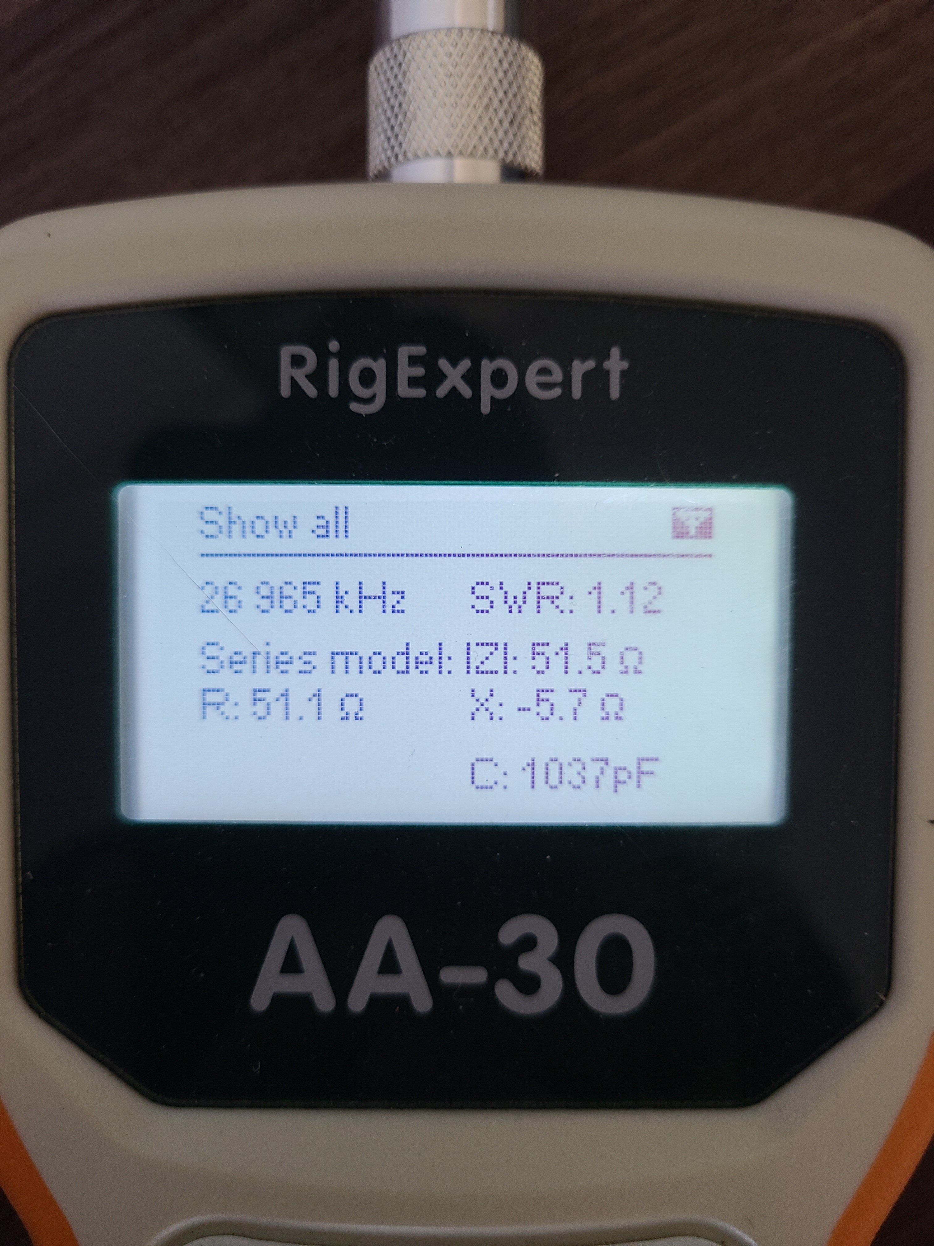

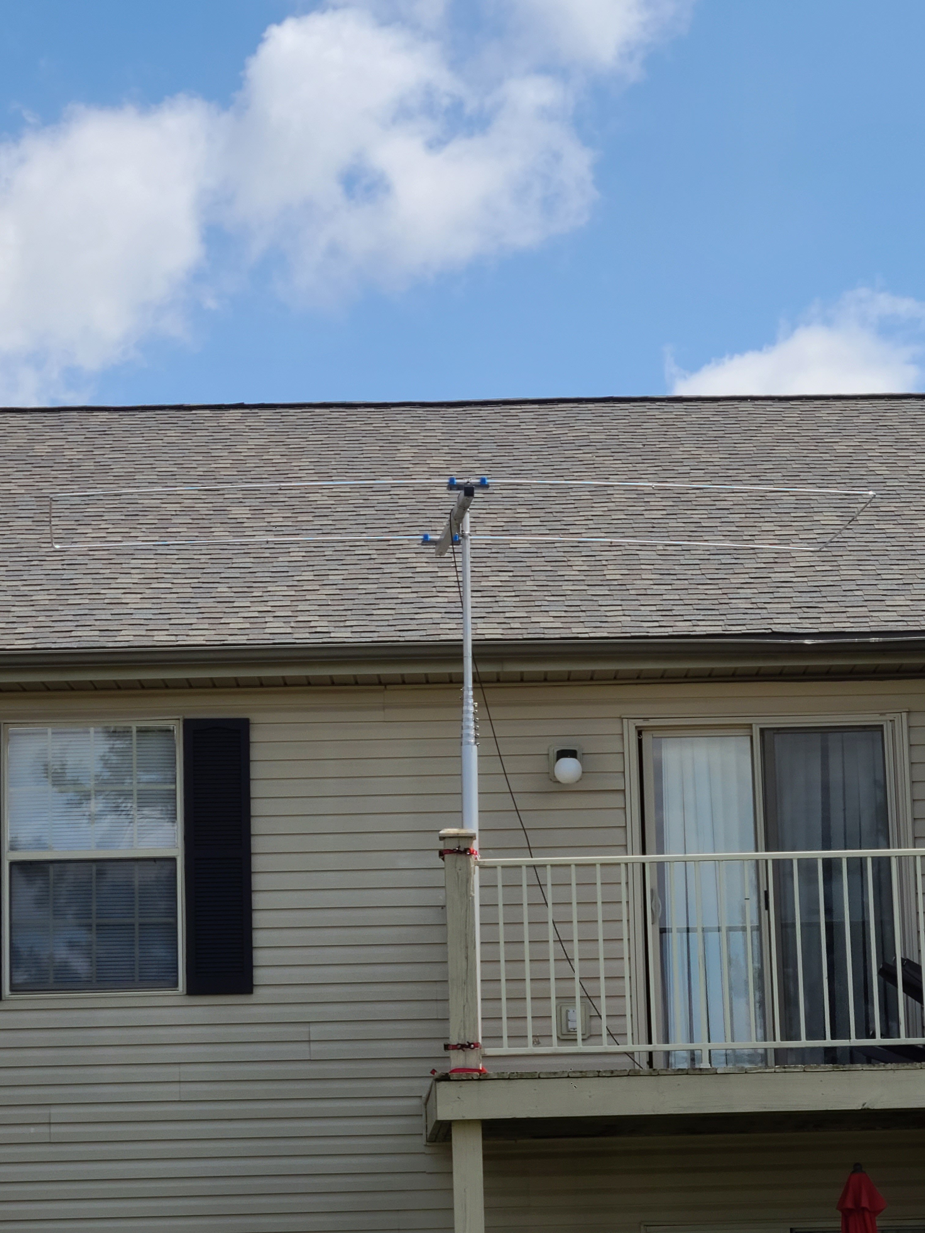

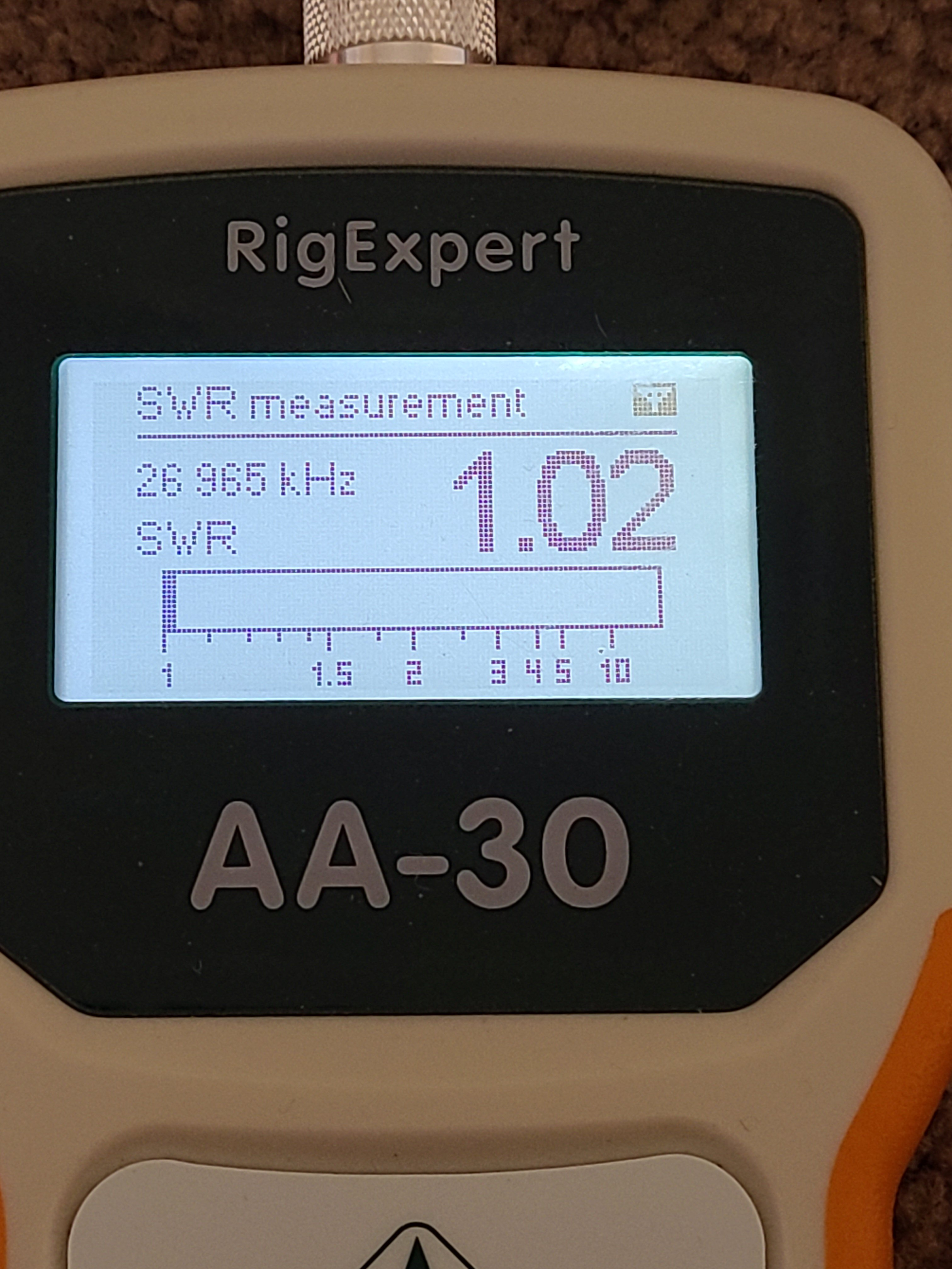

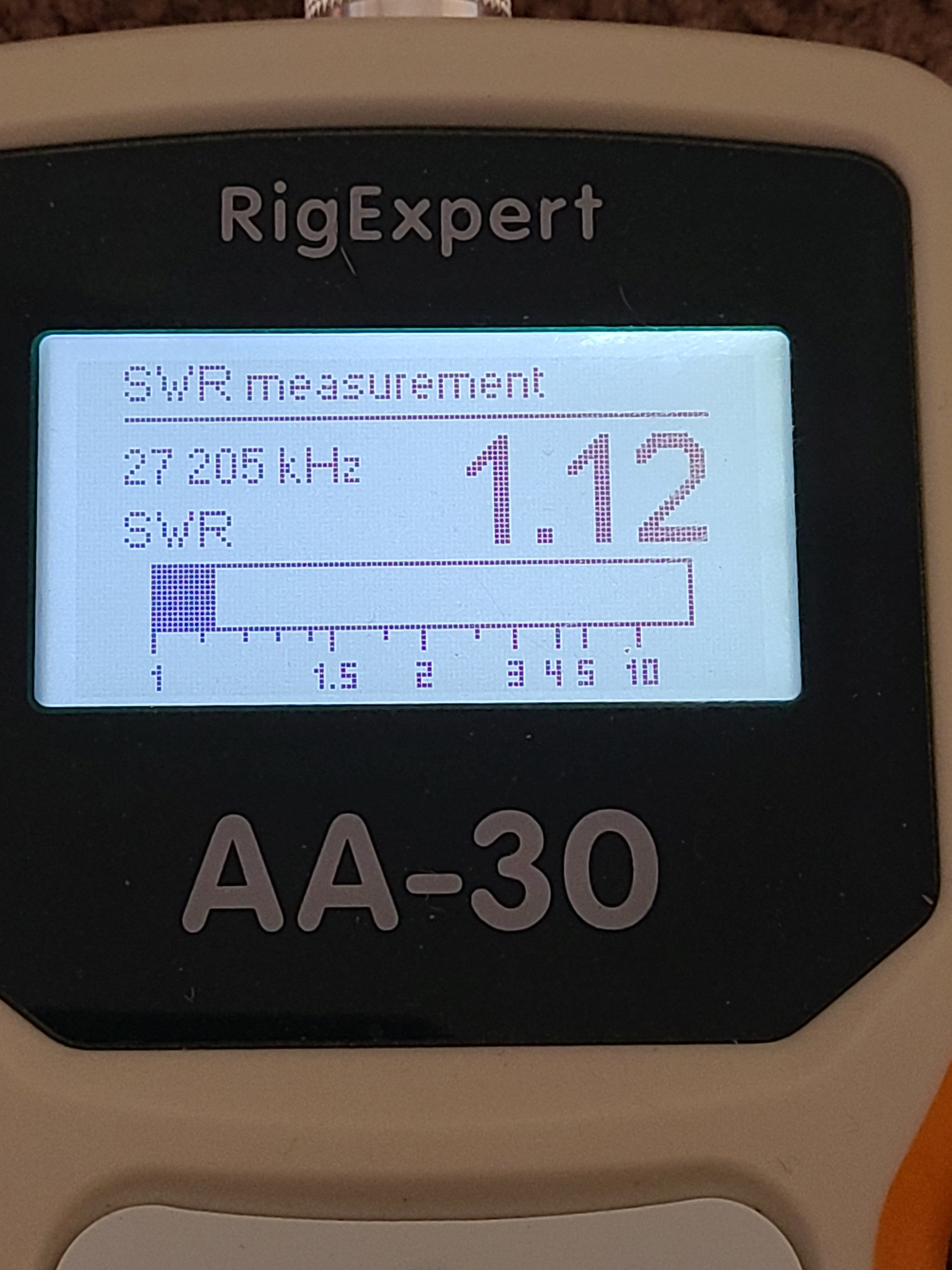

Ok, changed out my antenna, have a Moxon up for 11 meters about 25ft facing west. Gonna leave it up past Summer.
I'll raise it up later on and throw the rig expert back in line to see. It was almost spot on on ch20 down to ch1, going to ch40 I seen a slight change but nothing to drive myself crazy with.
I think on the moxon my length might be a tad long by half inch maybe or just leave it be. I think you folks know more about the R= O= Z= stuff than I do. Is it close?
