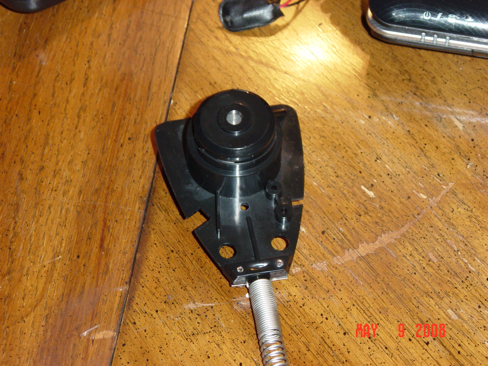

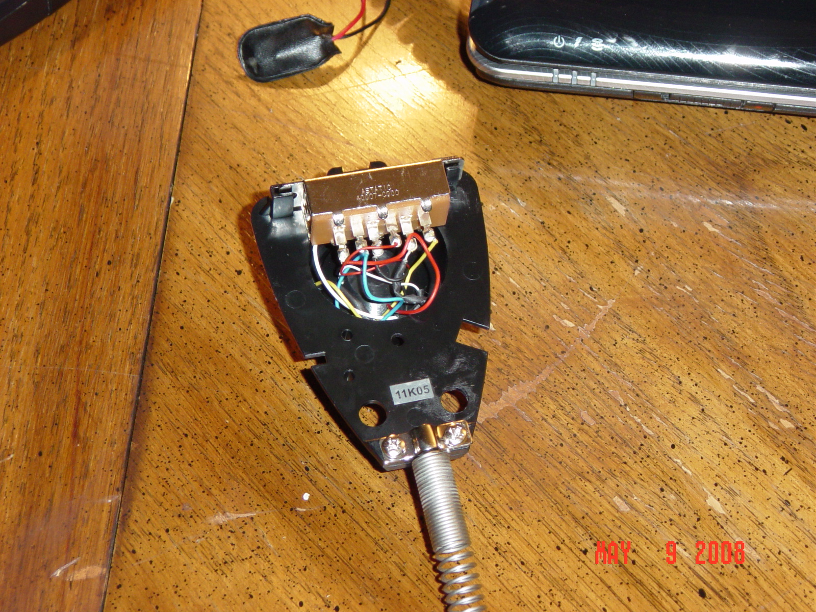

guys any advice on how you remove the actual pcb etc from the front off the michrophone casing ? there is a screw holding the battery backing down , have removed this but still the assembly does not want to come out freely, any advice ?
It's been a long time since I've torn into a hand mic, but maybe this will help. These are pics I took doing the 575 636 swap.
