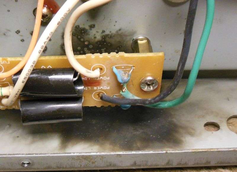

I'm wondering what could be damaged that's not on the circuit board.
The AC line-cord filtering, maybe?
Won't look like the one in this RCI base .
This board serves to reduce RF energy escaping from the radio, leaking out by the line cord.
If there was a nearby lightning strike to a utility pole, this can put a surge on the RF-filtering caps, like the one above.
If it did this from day one, I might suspect a design defect of some sort. But it behaved itself for nearly a year, so that's not it.
The AC line-noise filter might be perfectly okay. But the calibrated eyeball might reveal a stressed-out capacitor that was missed.
