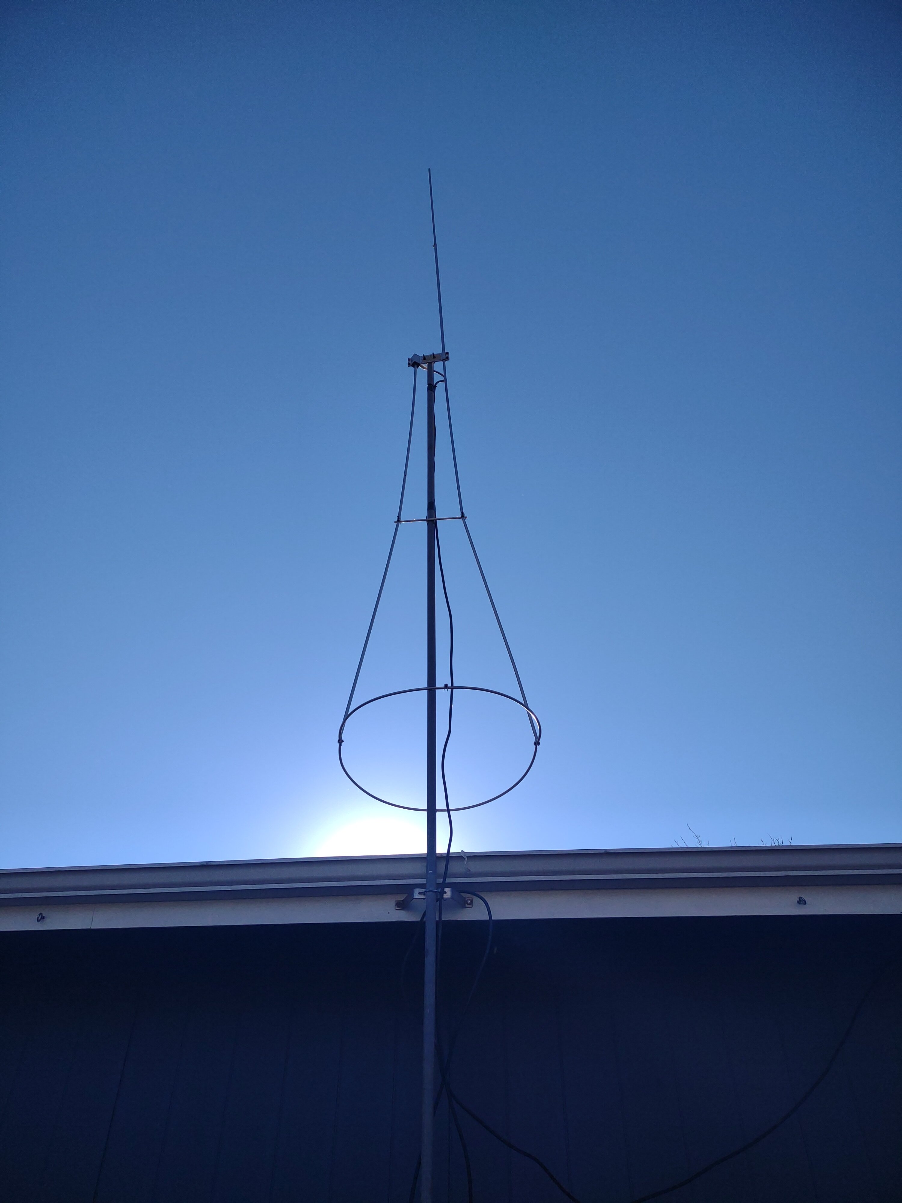

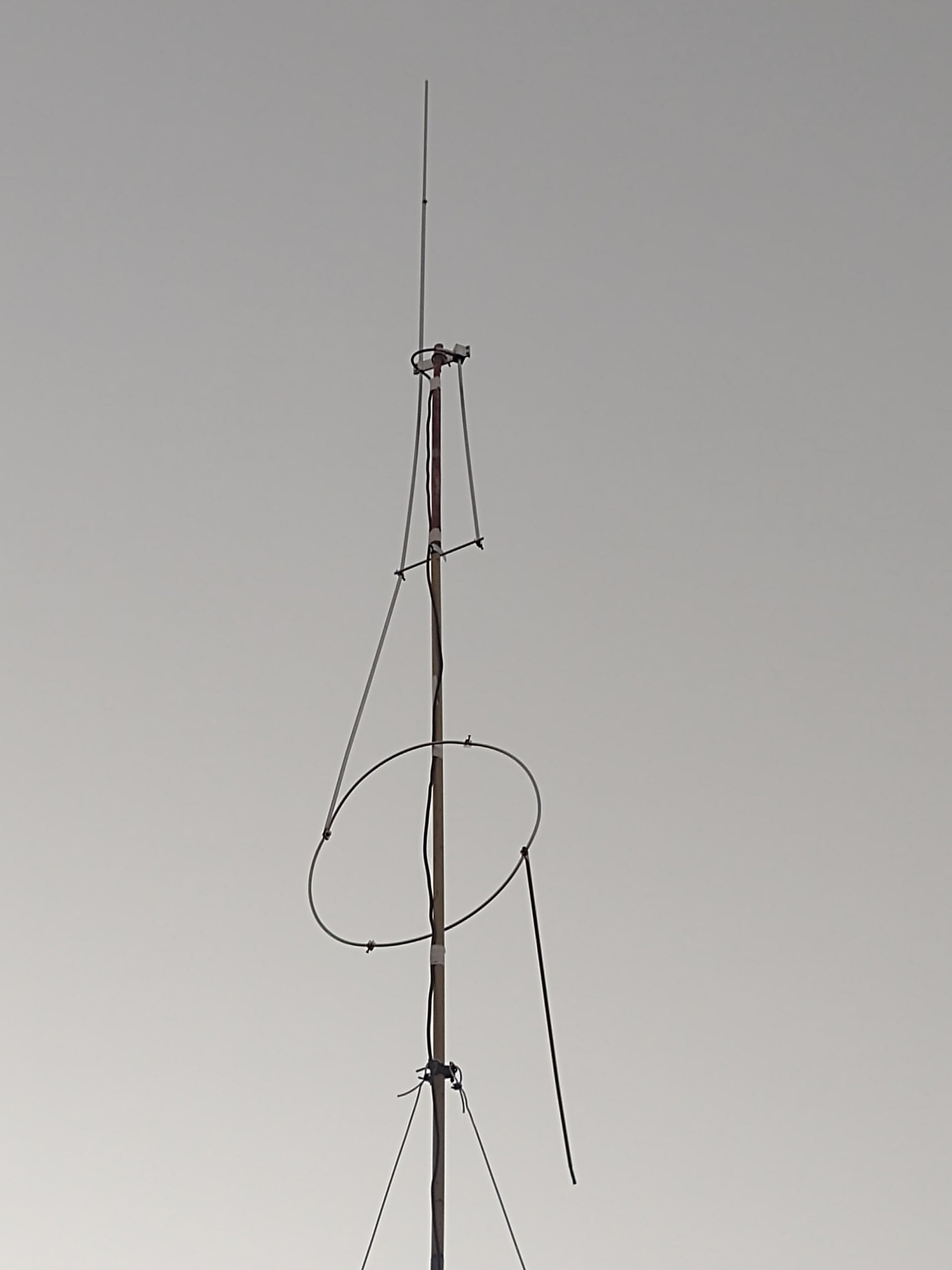

We had a severe t storm come through yesterday with 90 mph winds. The AP did not survive. The beam faired well with it only 22' and horizontal. The Imax will be going up untill I can repair the AP.

just looked at the picture closer.
is that an original astroplane? for some reason i thought it was the copy by CTE.
if so, then yeah it does look like that set screw might have just wiggled loose and given way.

Yes it's an original AP.
And that's what I see also. I hope that is the case. But won't know till it comes down. Hope the weather warms up enough.

It's definitely not the CTE model, as the mast stand off bracket is different in the CTE and the elements don't telescope into each other.
the CTE i have has held up quite nicely over the 10+ years i've had it.
the aluminum will start to split where they flattened the ends, but that's about it.
the one thing i would do is just toss their hardware right in the trash. the hardware that came with the CTE astroplanes was complete crap.
get some SS hardware and you'll be all set.

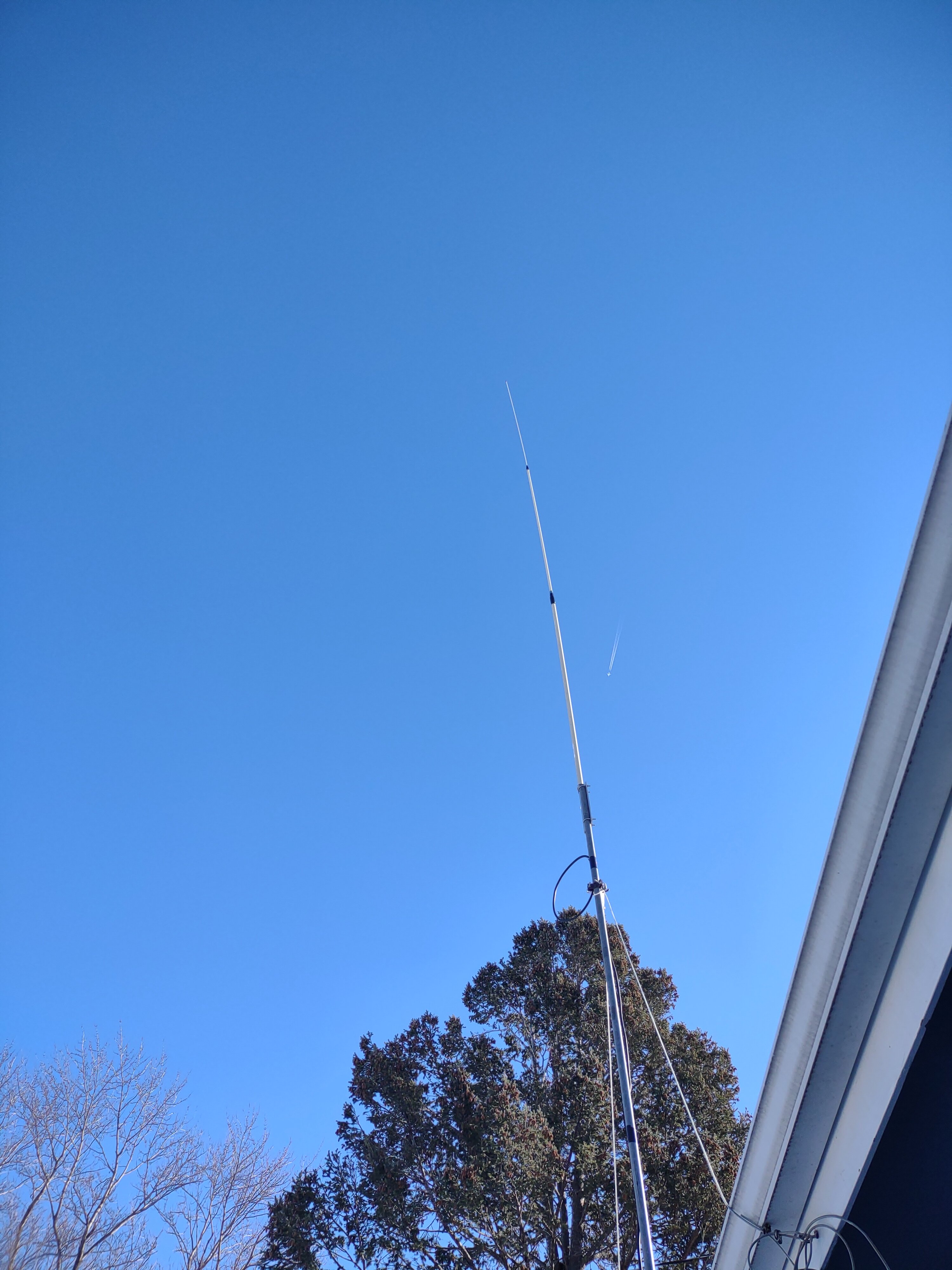

Well, the AP has issues. The SWR climbed to 1.5 and gets worse as I higher in frequency. Thinking the element that came apart has a crack. So, I installed the Imax 2K. SWR on 1 is 1.5, 1.2 on 40 and 1.1 on 27.555.0.
