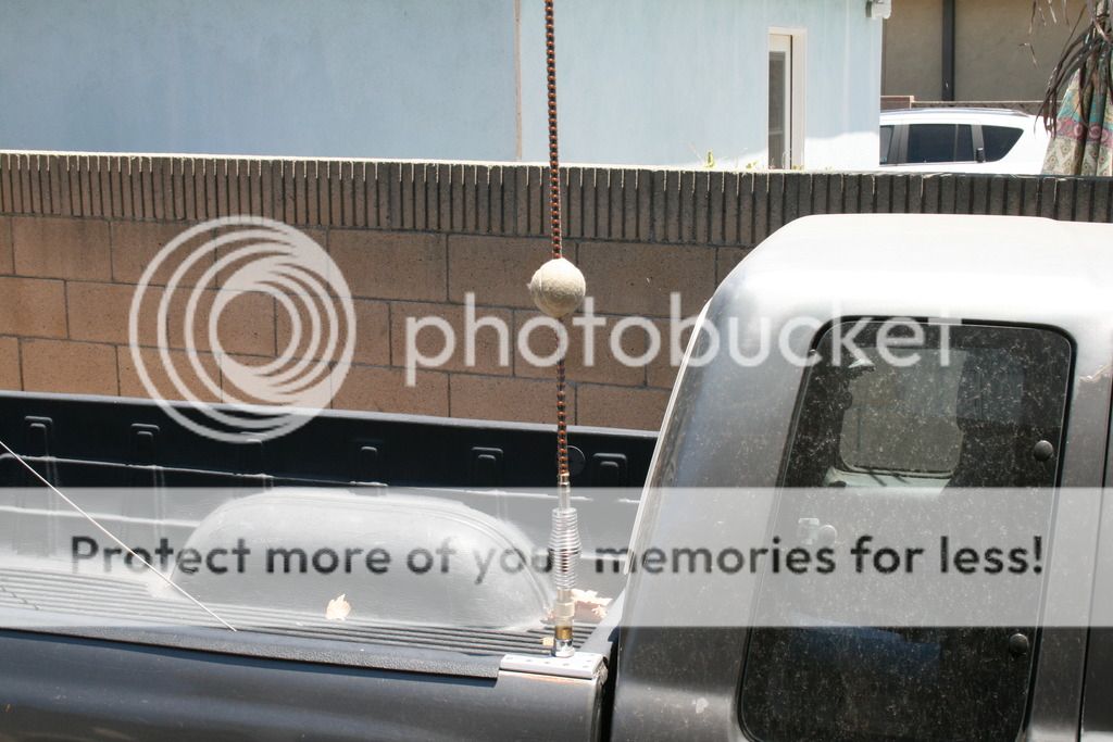

Here some pictures of the current antenna setup I have.
This is the Procomm antenna for off roading with a group. For some reason spotters don't like getting hit in the face by a SS whip antenna :)

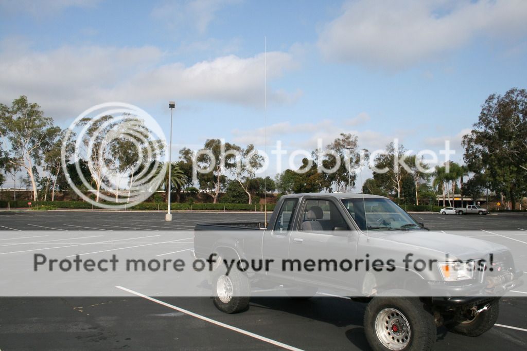

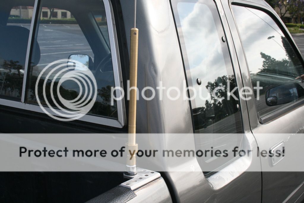

I use this whip antenna in the desert for best performance and a wider band width. It's disadvantage is it's 13' 10" high and is a hell of a tree wacker.
The mast is drilled almost through so I can tune from the bottom of 11 meters to the top of 10 meters.

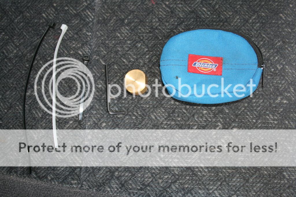

This is the manual tuning kit for setting up the whip antenna. With the antenna at maximum height, it covers 11 meters. The short black zip tie tunes from 27.005 - 28.5Mhz with an SWR under 1.7:1. The white zip tie covers 28.3 - 28.5Mhz with a SWR of not over 1.2:1. The long black zip tie covers 28.3 - 29.7Mhz with a SWR under 1.5:1.

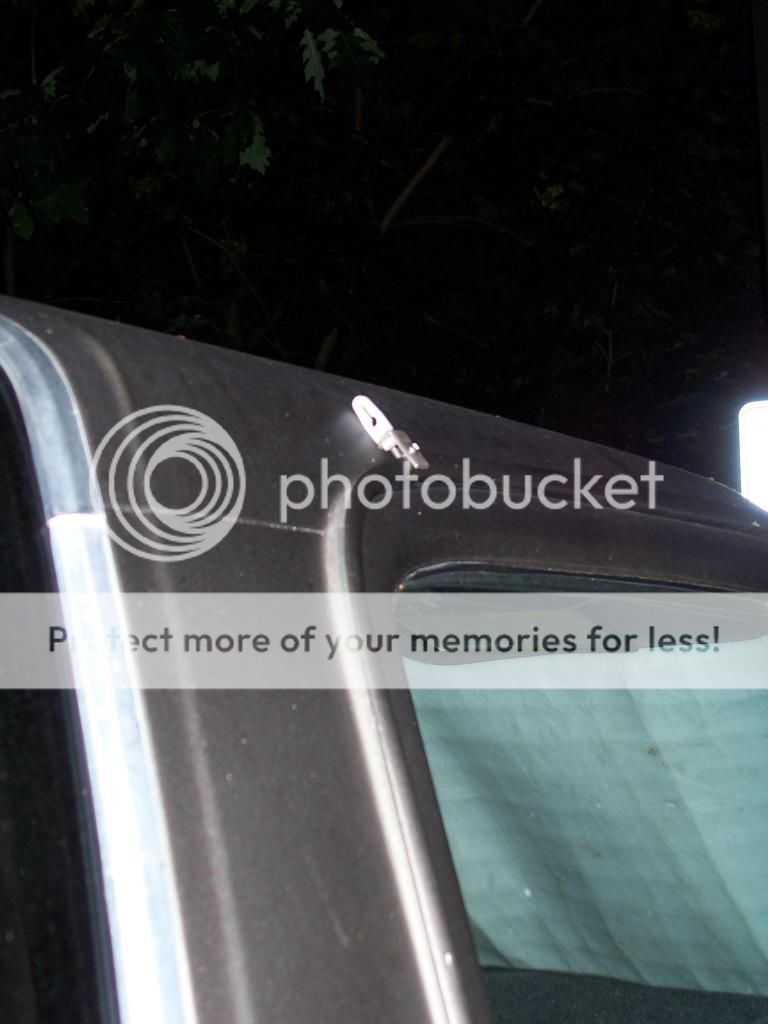

A gutter tie-down is no guarantee that WON'T happen, but it doesn't hurt. ;)
Here's the one on my RC in my avatar.
But I notice newer trucks like yours, no longer have gutters!!! :eek:
