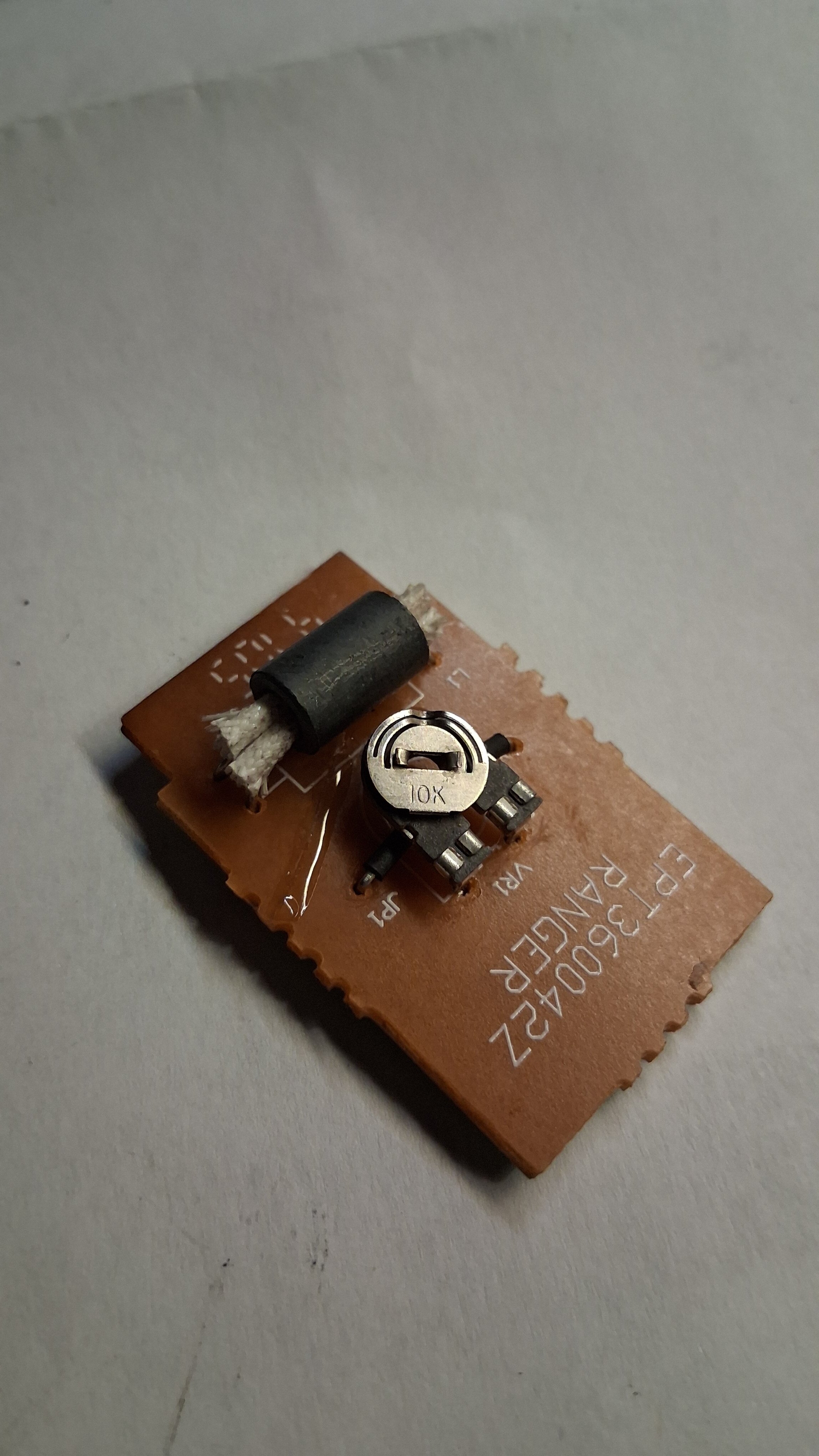

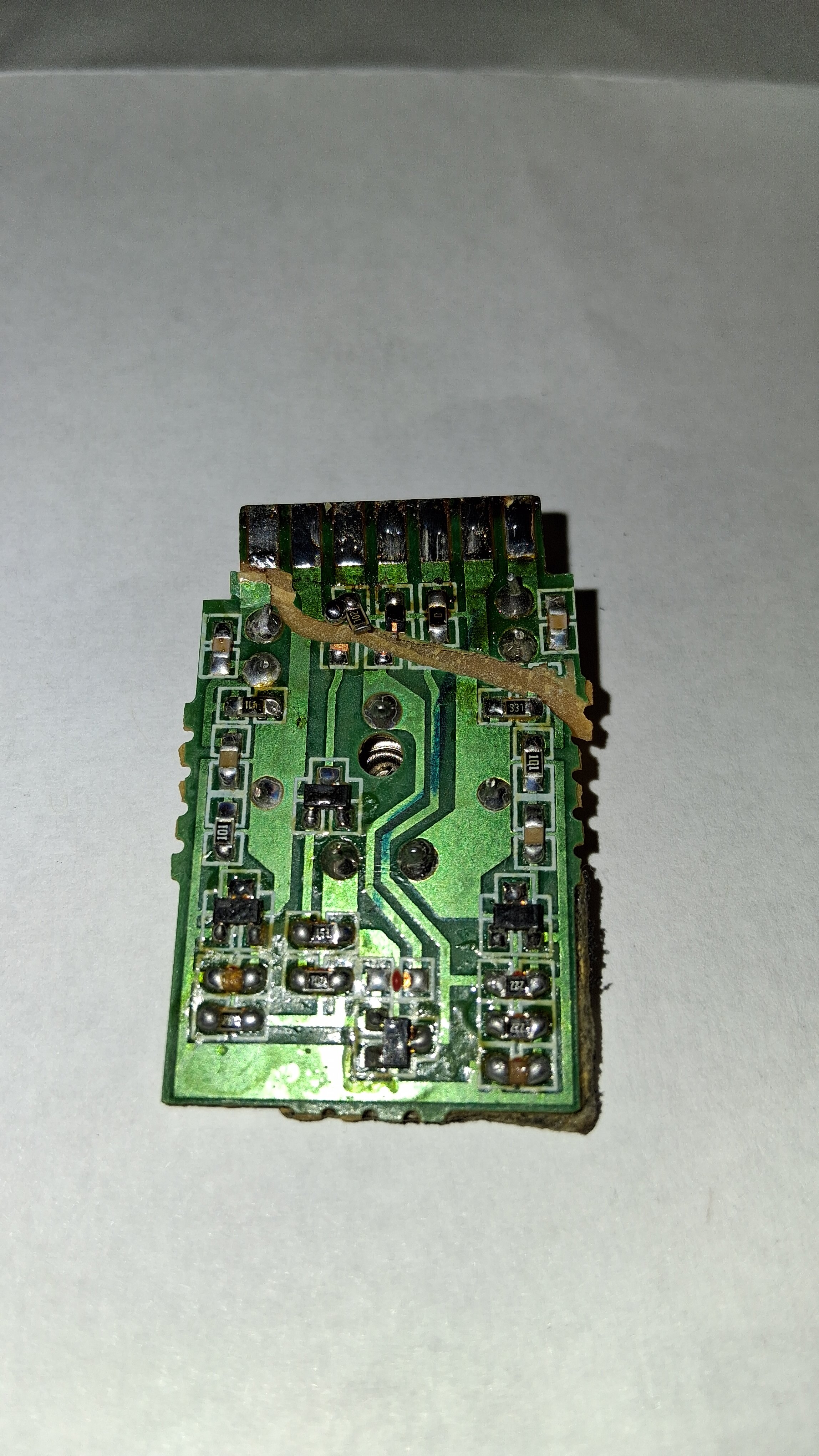

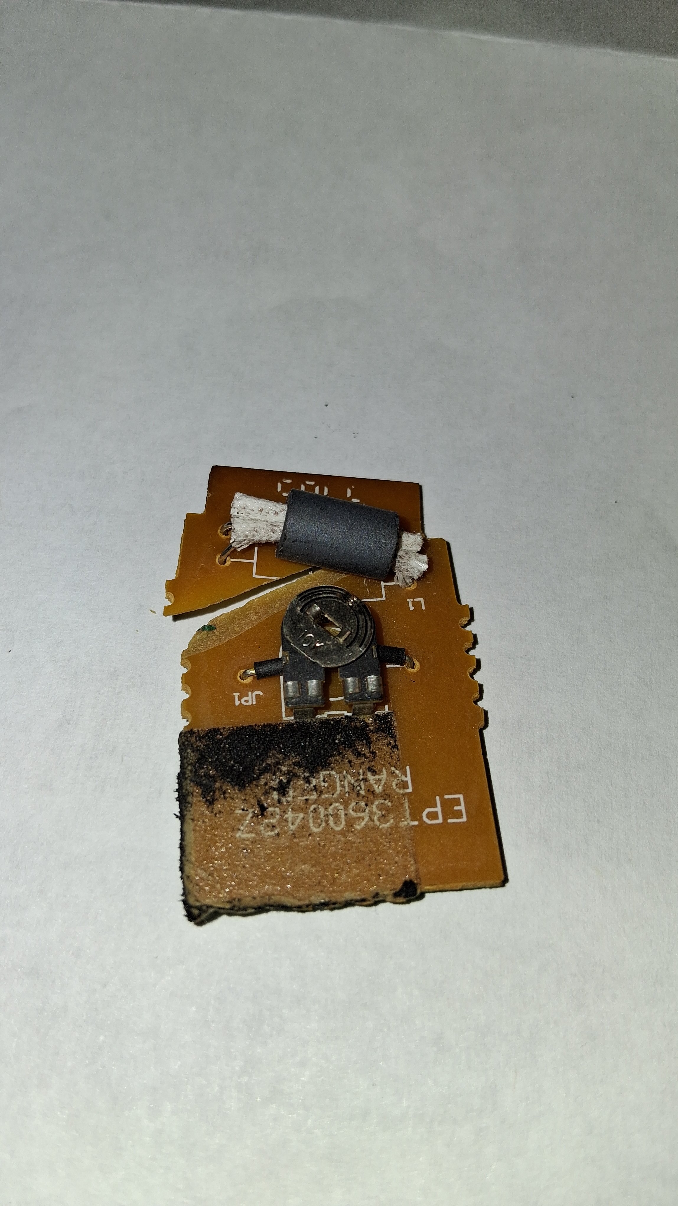

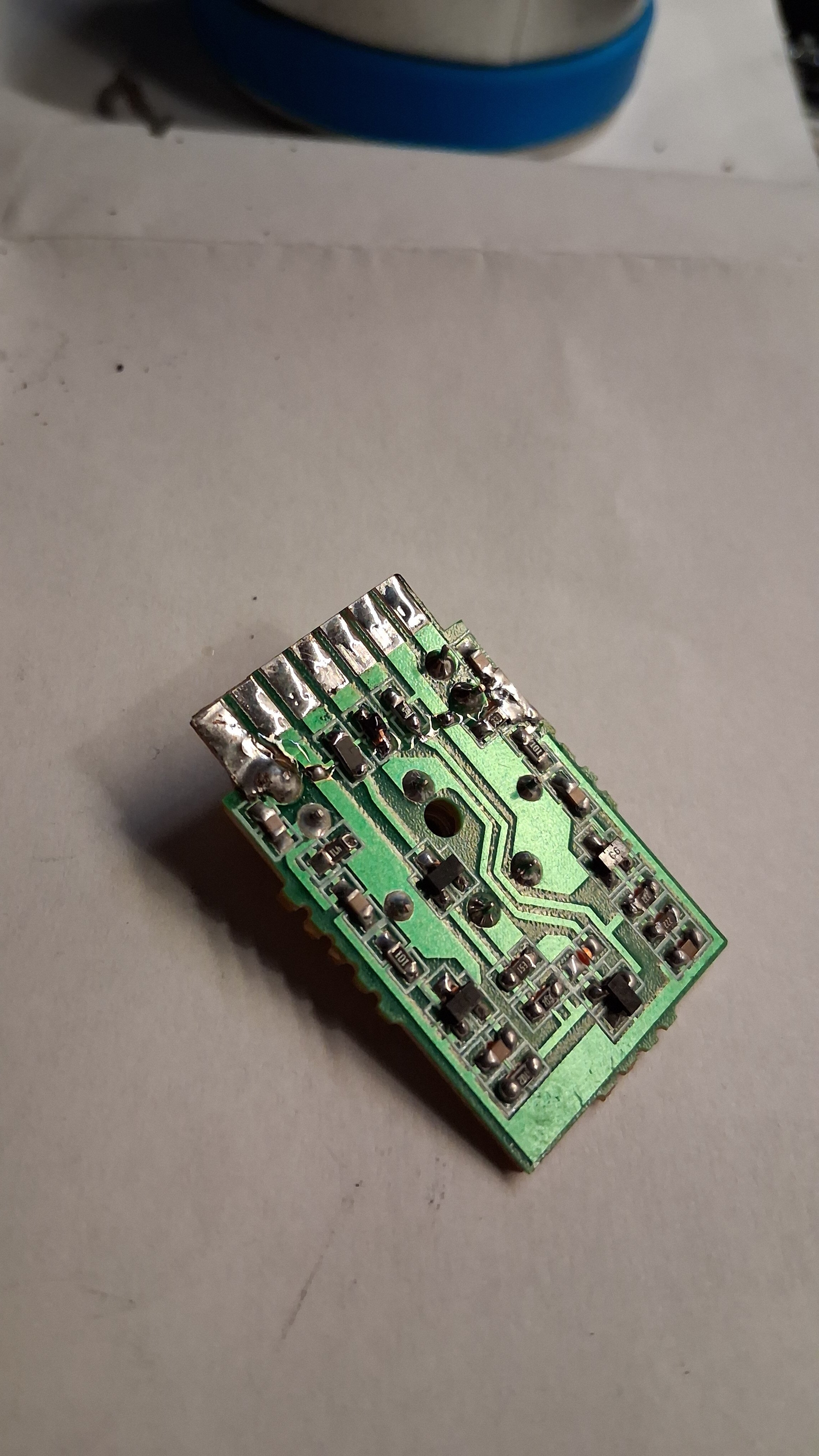

I always wanted to put one of these on the scope.
Luckily, I had one layin' around!
The diode was still good after cleaning and drying so I sealed it up with some UV resin. The 1k resistor was broke and had to be replaced. It's now good as new and way past my bedtime. Hopefully this weekend I can find some time to play with this.

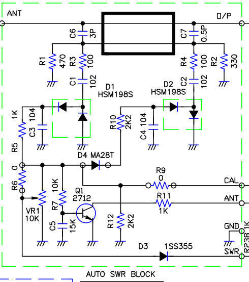

I'm wondering which way to do this. I think I need to modify this board with some jumper pins.
As the circuit sits, there is no way to use a 10x probe to separately measure the voltage contributions from the coupling caps and the current contributions from the coupled conductor (measured as a voltage across the same resistors the voltage caps connect to) so I can't really show much besides the sum of everything without modifications.
I considered using two of the same swr boards and an RF splitter and remove the caps from one and remove the second conductor in the other. But in order to probe the detector outputs, I think I need both sources combined. So then I was thinking about a set of jumper pins that let me isolate and reconnect the two caps and current conductor. Suggestions?
With switches, I was worried about lead length since the one side is only 0.5pF and that represents almost 12kohm at 27MHz, and that's only 69nH in the inductance realm, so I thought any excess wire, even if short with respect to 69nH would throw off the balance.
I did, however, finally realize that PCB traces, when above a ground plane (transmission line), do not have the 24nH per inch that a free wire has, its more like 4-5nH, so maybe DIP switches would be ok since it is close to the ground below. That 0.5pF has me thinking that even the slightest change in parasitics will throw this thing off, but if they were individual switches, maybe that would work better.
Last nights thought was to throw some pin headers on the board between each cap and sensing resistor, and another to break the current pickup wire between them, and then use some of those little jumpers that are often seen on old HDD slave select pins. Bought a kit last night with finger grips molded into them. But now after reading your DIP switch suggestion, I was able to find single dip switches on amazon so I will try those first and see what happens. It would be a lot easier than fumbling with those tiny jumpers. Thanks!
edit: I just hope the open switch capacitance is nowhere near 0.5pF...
