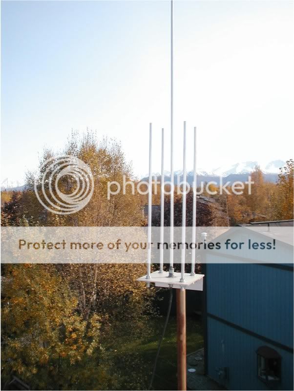

someone on here used to have a pic in their sig of something that looked kinda like a sigma 4 but the grounds were paralle to the the main element and had some kinda square pannels at the top and bottom of the geounds with the main running up the center of it . if someone knows what im talkong about and can post the pic id be thankful .
anyhow , i was wondering if its just another way to make a sigma 4 , and what the differences in their performances are .... ?
not sure which antenna you mean booty unless its this one
Geez never seen that monkey before Bob. What is that? Bottom radials a vertical close-in ground plane? Interesting. Manufactured? Homemade? Is it a 1/4 wave or 1/2 or something else?
skelleton sleeve monopole, 3/4wave monopole with 1/4wave open sleeve,
yes its homebrewed by a ham in the usa.
QSL. Can't see the top in the pic so couldn't judge the length. Guessing is for 2 meters?
Seen relatively similar all aluminum J Pole for 2M/440 with a matching stub.
TNX
thats it Bob . thank you :)
i dont see any gamma or other tuning system so im guessing its tuned by adjusting the length of the elements ??? and for some reason i suspect that if the ground elements arnt spaced exactly right all around the radiator that it throws everything out of skew ??
so its not like the sirio sigma 4/vector/LW150 .
no its not the same as a sigma but similar,
the monopole is isolated and direct fed at its base, unlike the sigma style antennas you are stuck with a 3/4wave monopole,
theres a good explanatioon of how they work in the arrl under open sleeve antenna,
its not a j-pole .
