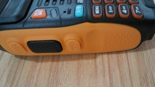

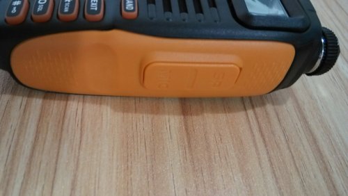

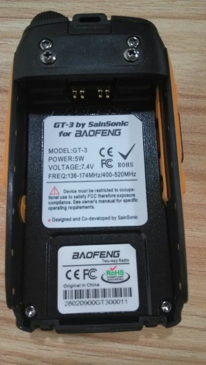

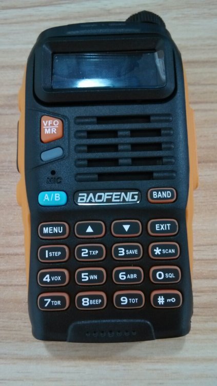

Then the pictures
front side
back side
the following pictures are from their website
just same with the one I received.
