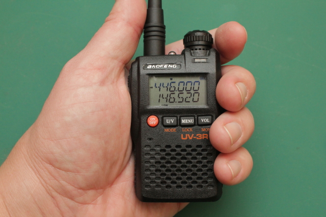

As you can see, the radio is tiny! It's very similar in size to the Yaesu VX-3R, although the button configuration is different.

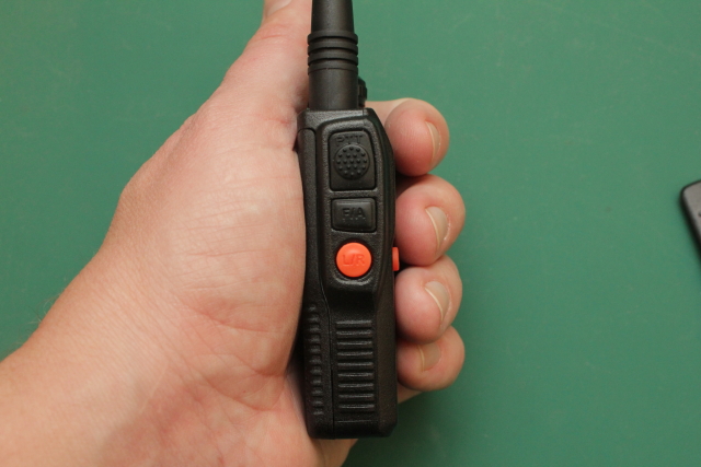

Here is a picture that shows how thin this radio really is:
Without the antenna, this radio is smaller than the wallet I carry in my pocket. With the antenna attached, it's still small enough to slip into a baggy pants or shorts pocket.
In this picture, I set the Baofeng VX-3R on top of my Yaesu VX-8R to give you some perspective on the size of the radio:

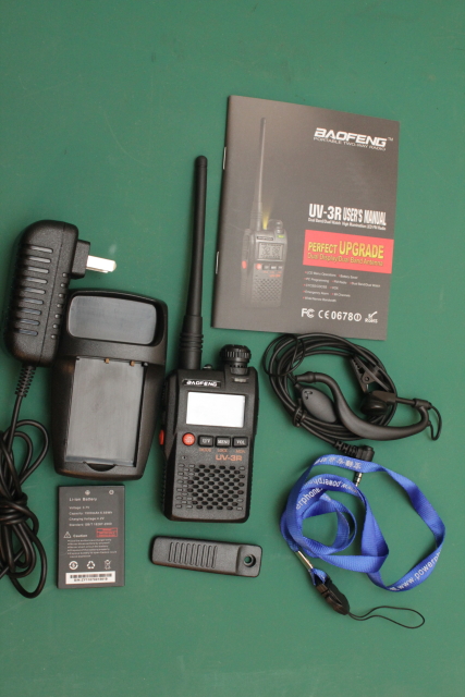

So, I know you're asking: What all do you get for $50? You get a 2 watt 2m/440 radio with 99 memories, scanner, and FM broadcast. Here is a pic of everything included in the box:
As, you can see, in addition to the radio, battery, and manual, you get a desktop charger, belt clip, lanyard, and earphone speaker/mic. I also opted to purchase the USB programming cable and an additional camo colored shell.

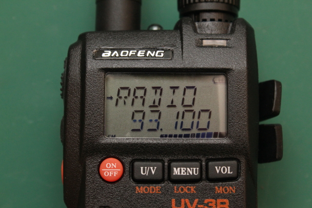

Here's a picture of the FM broadcast radio function enabled:

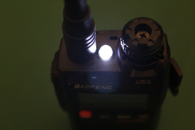

As is commonplace with the Chinese radios, the radio also has a fairly bright LED flashlight:

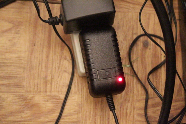

After I put the battery in and started charging the radio, I started looking for the charging indicator. It took me a few minutes to figure out that the indicator is actually on the wall wart, and turns green when complete:
So, you can see that you get quite a bit of bang for the buck. The battery is a standard Fuji NP-60, Li-ion 3.7v 1500mAh battery that is inexpensive and readily available. If you want to buy them really cheap, you can get them on eBay for $6-$7 ea.

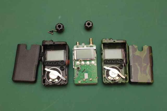

Changing shells
As mentioned, there are different case colors available: Black, Yellow, Blue, Red, and Camo for $6 each. I don't really care about colors, but I had to order one to see how difficult it is to change.
The new shell comes with a new plastic display face, the rubber buttons and a new top dial. To change the case, you just remove the battery, remove the antenna, remove the dial on top by removing its screw, then remove the two screws on the back next to the battery. The whole thing just prys apart. Here is a picture of both shells with the radio guts in the middle:
You retain the orange rubber seal and the rubber speaker/mic & power cover from the old shell when you reassemble the whole thing. The whole process took less than 10 minutes.

Is that an SMA antenna?
Yep, one of the things that they did right on this radio was to use a regular SMA antenna connection that is found on most other radios on the market. One catch, though: The LED flashlight on the radio is a little close to the antenna, which means you have to be careful which antennas you choose. I put a Comet SMA503 on my UV-3R to test, which worked well.
