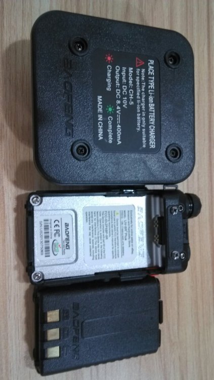

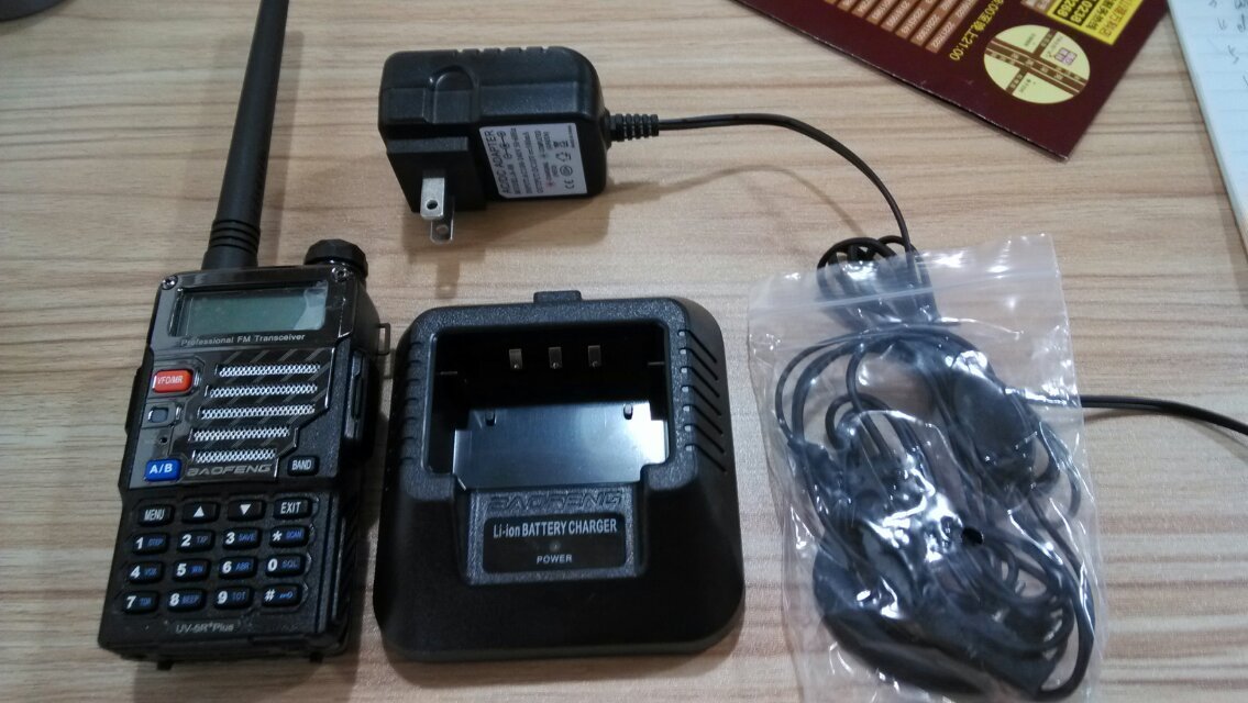

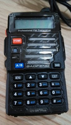

1.full picture of baofeng UV-5R plus
Frequency Range: 65MHz-108MHz(only commercial FM radio reception)
136-174 MHz and 400-520 MHz (TX/RX)
Channel No. 128
Frequency Stability :±2.5ppm
frenquency step: 2.5MHz/5MHz/6.25MHz/10MHz/12.5MHz/25MHz
Antenna:High gain Dual-Band Antenna
Antenna Impedance:50Ω
Dimension(W x H x D)100 x 52 x 32 mm
weight:130g
Transmitter
Output power:4W / 1W (Max 5W)
Modulation Mode:16kΦF3E / 11kΦF3E
Maximum deviation: <5kHz(Wide) / <2.5kHz(Narrow)
Spurious Radiation:<7μW
Adjacent Ch. power:≤-65dB(Wide) / ≤-60dB(Narrow)
Pre-emphasis characteristics:6dB
Current:≤1.6A(5W)
CTCSS/DCS deviation:0.5±0.1kHz(Wide) / 0.3±0.1kHz(Narrow)
Intermediation sensitivity:8-12mv
Intermediation distortion:<10
the picture of everything

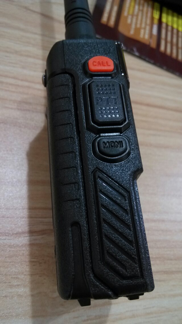

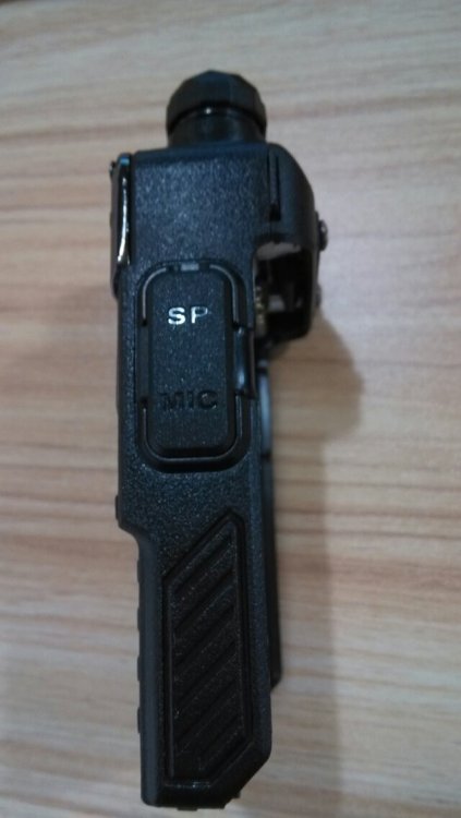

The left side has the typical PTT, "CALL", and "MONI" buttons,almost the same with 5R, but different in design

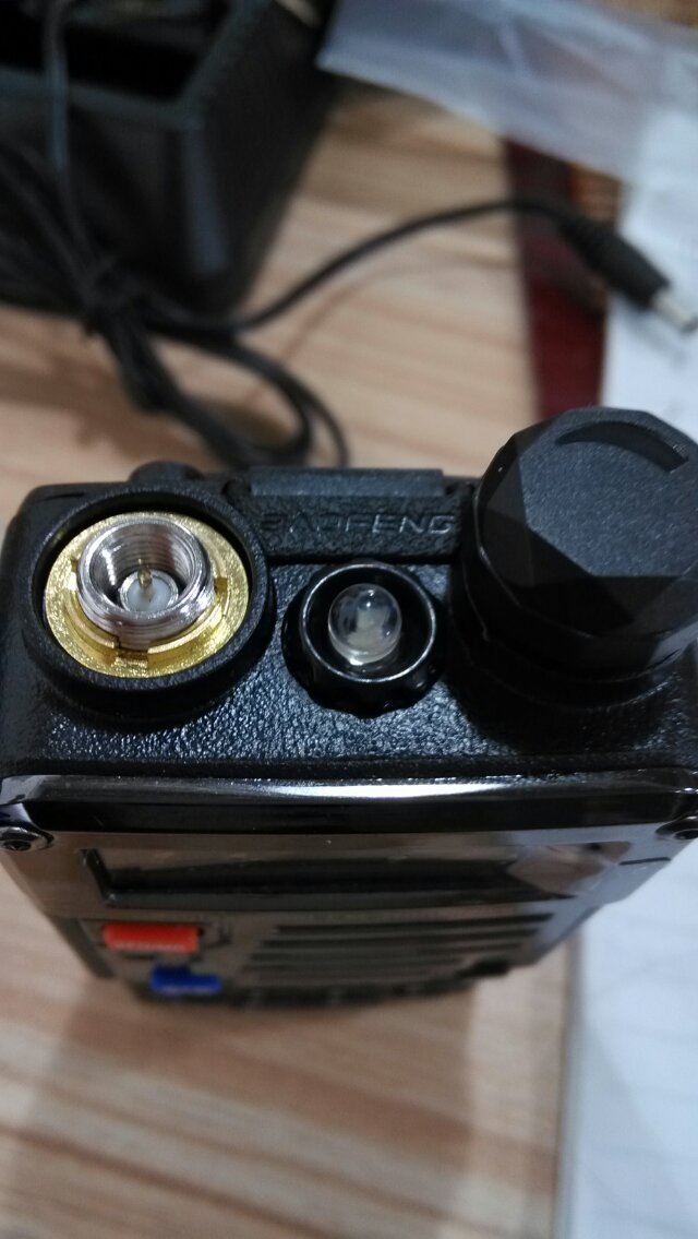

The top of the radio is where you find the flashlight and On/Off/Volume knob

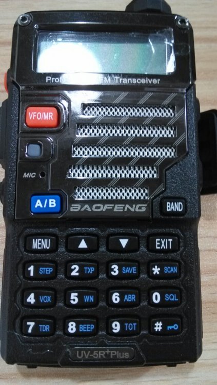

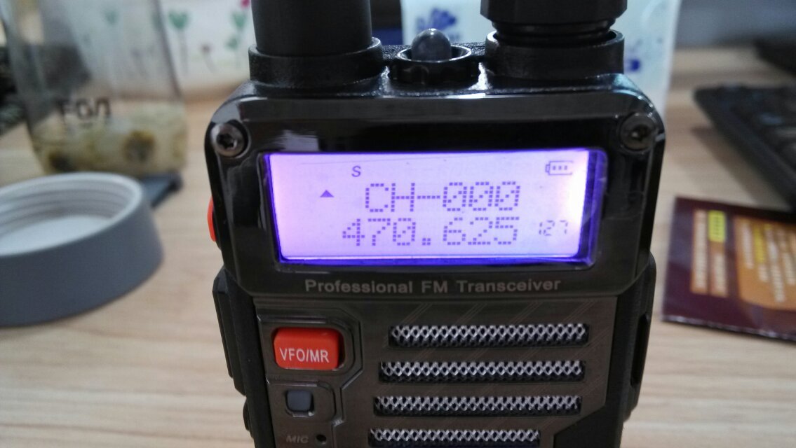

the display with broadcast radio on
I don't have Baofeng 5R, so i can't tell the detailed differences between them maybe you guys can give your opinions.

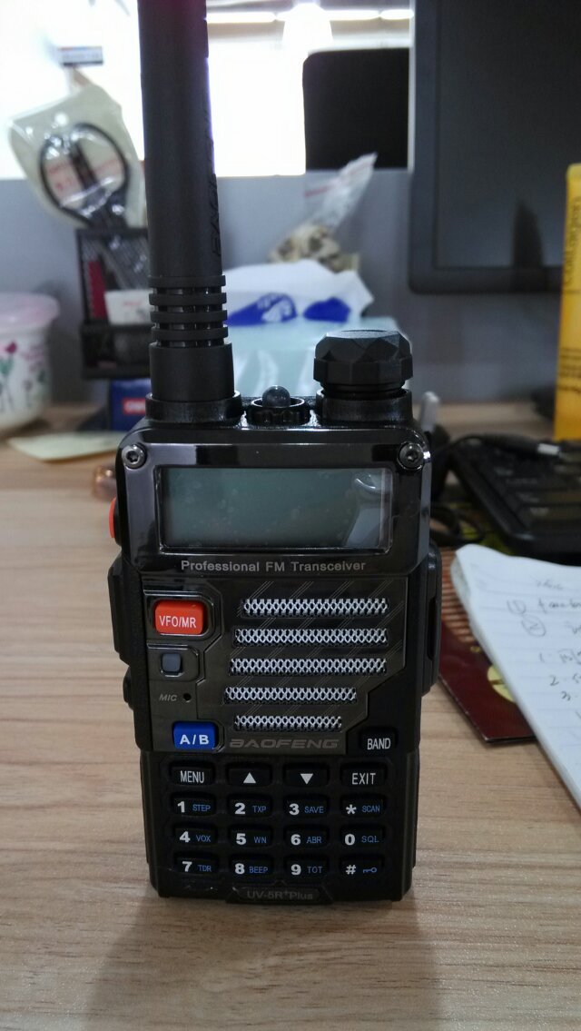

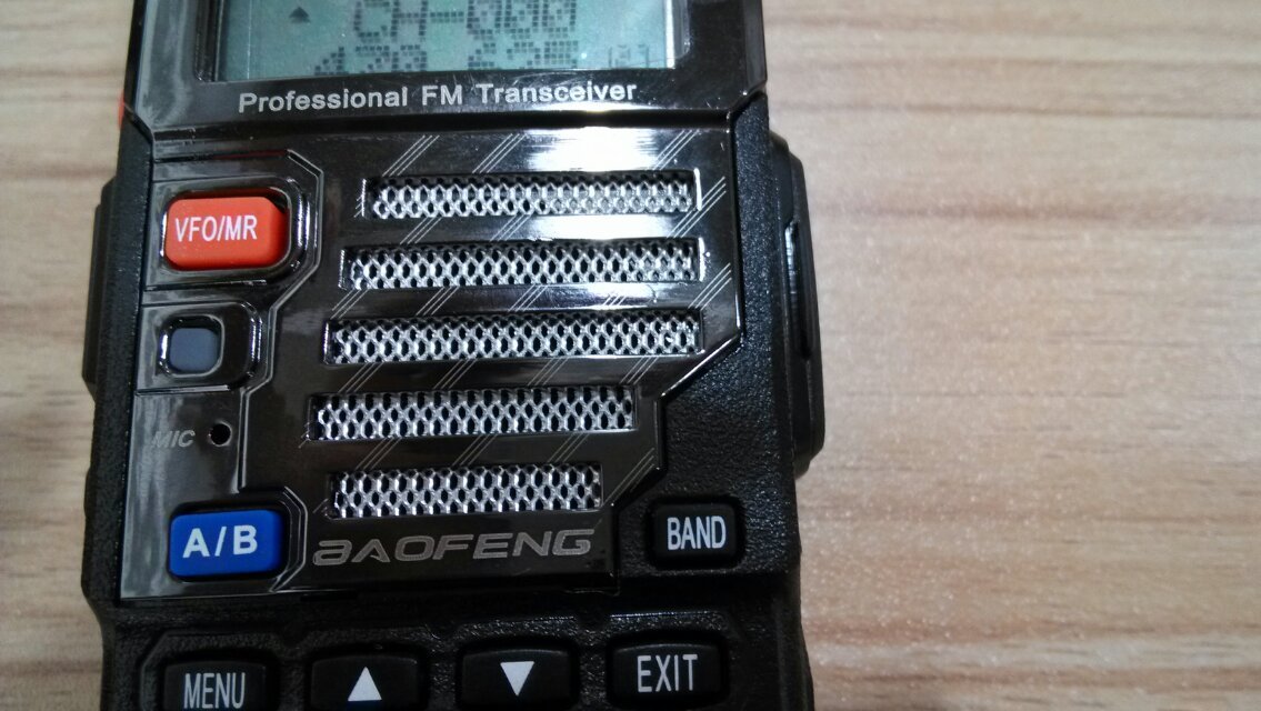

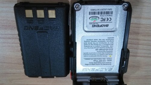

more close-up pictures of 5R+
