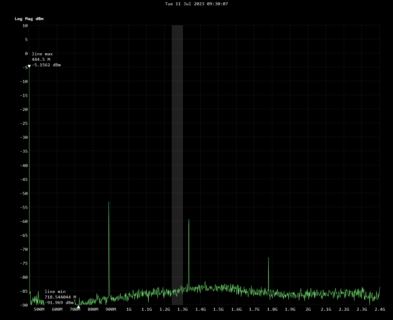

Here is the plot with a transmission on 444.5 Mhz:
In this plot, you can see the 2nd harmonic is -53db, 3rd is -59db and 4th harmonic is about -73db.
Now you know!
