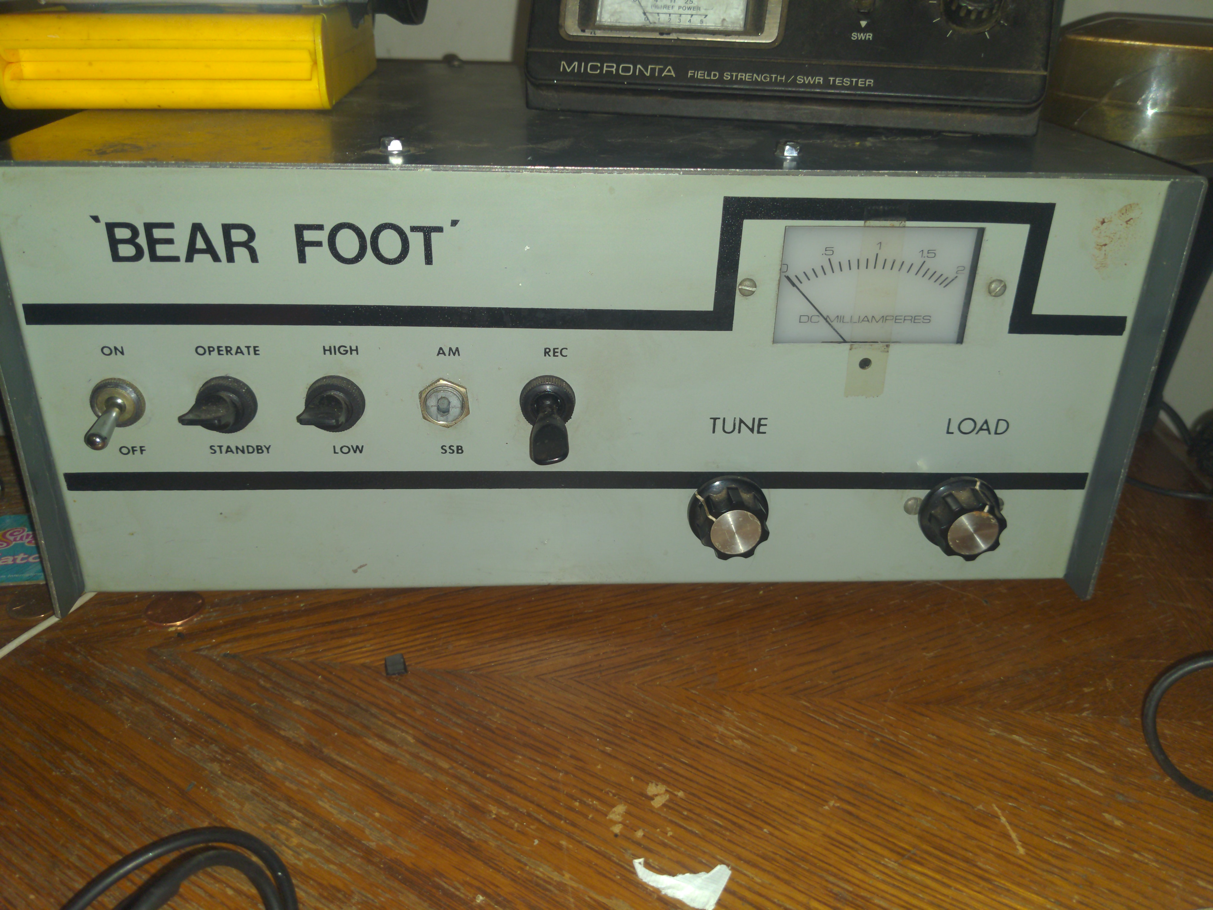

thats right this thing is transformerless.i never knew this existed?when i went to pick this amp up i nearly threw it in the air...lol....i had to look twice inside only to find no transformer....wow...cool.....big fat caps in it ...3 of them...............31js6 tubes if i remember right.3 of those .swings 500.........i could swear i seen the tube cap leads soldered on the tube caps.the fan pulls air across the tubes instead of blowing on them.coolest little amp i seen yet....no transformer in a base tube amp.....sweet.
anyone ever see such a thing?

hey nomad radio ...heres a picture of the amp since you never heard of this one.i didnt even see a small transformer at all ,none.......just a thick yellow 3 prong cord leading up to the electronics inside and you can see 3 big fat tall caps inside.with 5 watts in i get 100 watt key on high swinging to 4-500......on low....50watt key swinging 250..........not a great big keyer but a nice little 4-500 watt pep amp.there is a fuse inside that you can see very easy.i,ll take a shot of the insides later when i have more time.so this would be a rare amp huh?i knew i had something rare here.how would you say ground it??run a wire from the chassis to where??no actual good ground in my room here other than the electrical outlet ground.i imagine if you hammered away at this amp the caps could drain enough that the power could suffer??
