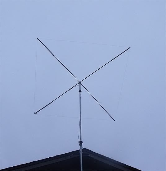

OK, I thought it was you I talked to a while back while you were using it. How deep were the side nulls?
How was the impedance, near 50Ω?
I would like to know more about your experience with it.
Reactions: 1 person

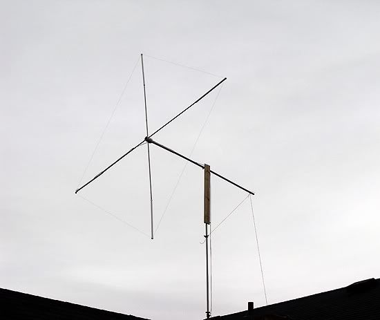

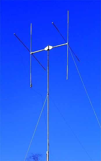

I didn't have it up long until I was turning it into a 2 element Quad.
It began its life cycle as a horizontal Loop Skywire, which generated a healthy discussion.
Then it became a vertically mounted and polarized loop before transitioning into the 2el Quad.
If memory serves me, I may have mentioned that in the thread Outdoor Loop
The loop required an impedance transformer as it has a natural impedance just exceeding 100 Ohms. For that I used an e1/4ƛ 75 Ohm RG59 section of coax.
ƛ/4 x .66 = length, ƛ determined by your center frequency. In my case 35.92* /4 x .66 = 5.9268 or 6'
wavelength calculator
*27.385 MHz

Nice. Homer, have you found anything which provides better performance than (or even as good as) the 2 element Quad?
