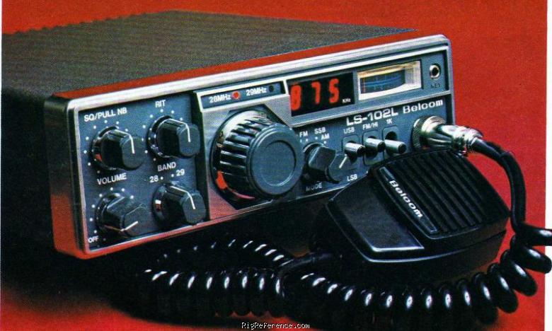

There is a service manual for the Belcom LS102L, which is a slightly modified version of the LS102. This manual might still be useful for alignment procedures. You can download it here: ELEKTROTANYA.COM
I think the only difference was the L version added LSB. Back when that was made, not many people used LSB on 10m. I doubt they redesigned the entire board just to add LSB, probably just an added crystal or a means to pull the existing crystal to shift the IF to the other side of the crystal filter. I'd guess the rest of the radio is identical. If its otta whack now, you won't hurt much trying to follow the L service manual ignoring the LSB part..
