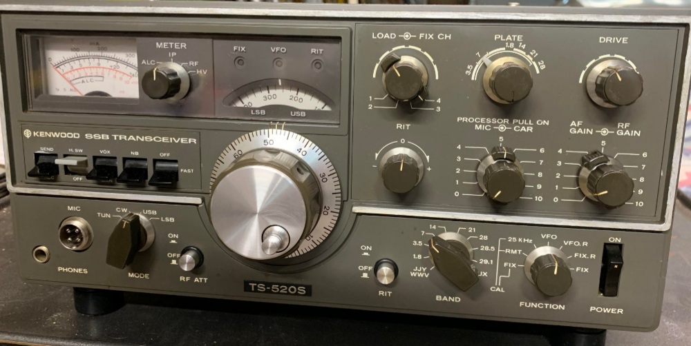

Not sure if it comes with any extra equipment or even an antenna ill know more when I go to pick it up but for now here is a picture of this clean little radio
The guy im getting it from is a local licensed ham operator so im assuming its true to 10m and not converted to 11m
Reactions: Slowmover

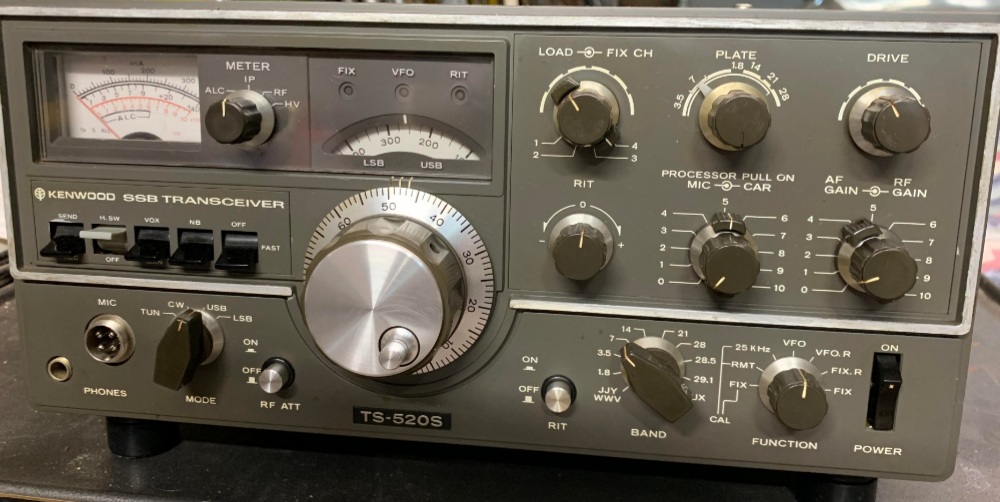

View attachment 40608 Not sure if it comes with any extra equipment or even an antenna ill know more when I go to pick it up but for now here is a picture of this clean little radio
I will post more and surely be asking alot more questions once I have it. I still have to get my license so getting on the air will take a little time we all know how lengthy an antenna set up or "farm" can take and i thought i was picky with how perfect i could get an 11m antenna. Looks like my ocd will get some more chances to show itself lol

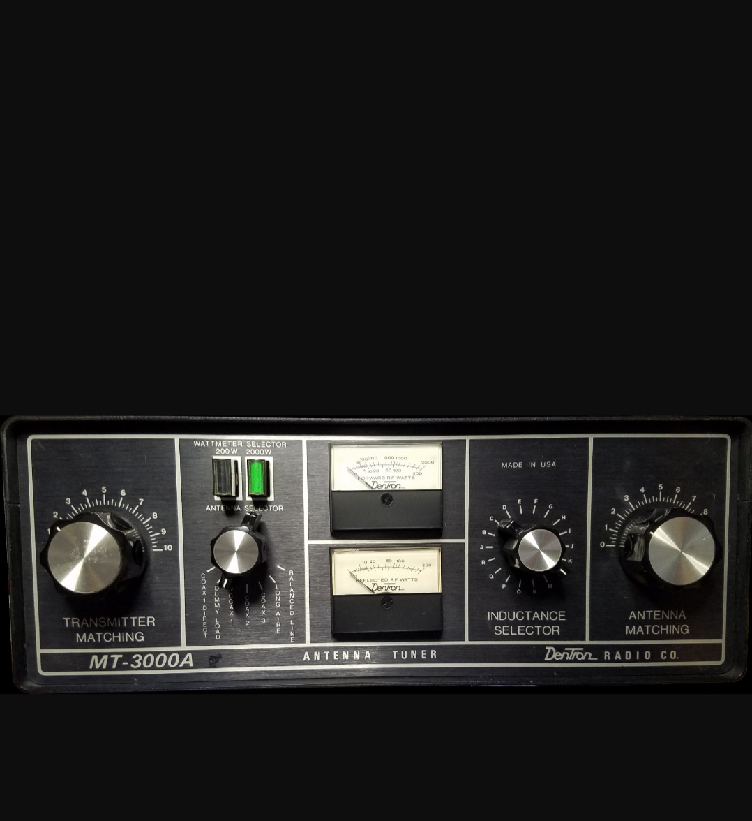

What do you think about the Dentron mt 3000a

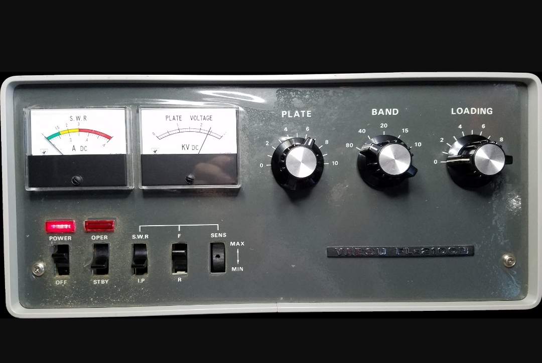

These two pieces are from a local ham. He wants about $930 for both any opinions?
They sure don't beat the price of the one you showed @BJ radionut
The MT-3000A is a good old tuner...They have a switch issue...Has seen in the add I posted/ updated switches installed...
IMHO the prices being ask by local are to High!
That Yaesu amp at best w/ new tubes around $450-500...seen them at Hamfest and 4 sale for $350 w/ used good tubes.
The tuner $200-300 in very good condition...I also have the MT-2000A (same tuner/ no meter) Paid $125 for it...
That said I personally feel he is way to High.

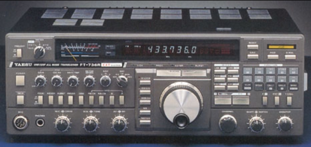

I also ran across this locally
The guy is asking $700 but I'm more interested in 20 and 40 meters 2m is really popular around my area from what I hear on 11m and 6m would be fun to get into not to familiar with 440 so for me the kenwood was obvious.
