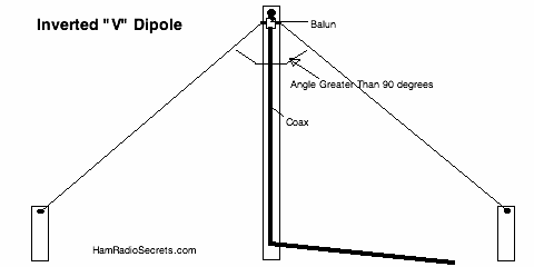

SWR on dipoles. A horizontal (or vertical) dipole exhibits a 70 ohm impedance. 70 ohms is the natural Z of a half-wave dipole, so you will see a typical SWR of 1.5:1. An inverted-Vee exhibits an impedance of 50 ohms. so your SWR will be a flat 1:1.

The only time I tried an inverted V, [and it should be called an inverted Y] the swr shot up to almost 5. That is because, I guess, it was reflecting off the coax. As soon as I straightened it out, it went to 1.00, on two different meters and the radio SWR set meter. So not sure where your getting all that.

I'm getting it from Fred Terman, John Kraus, Edmund A. Laport and 45 years of experience. Oh, and the ARRL antenna book.
I'm getting it from my SWR meter, the radio SWR meter and a borrowed meter, all tell me 1.00, time after time. The meters seem to show reality, the other stuff seems to be theory. Anyway, I go with the meters.

This is the type of inverted-Vee antenna I'm talking about.
Your antenna, (whatever it is) has some peculiar characteristics that present a 1:1 match in your case.
