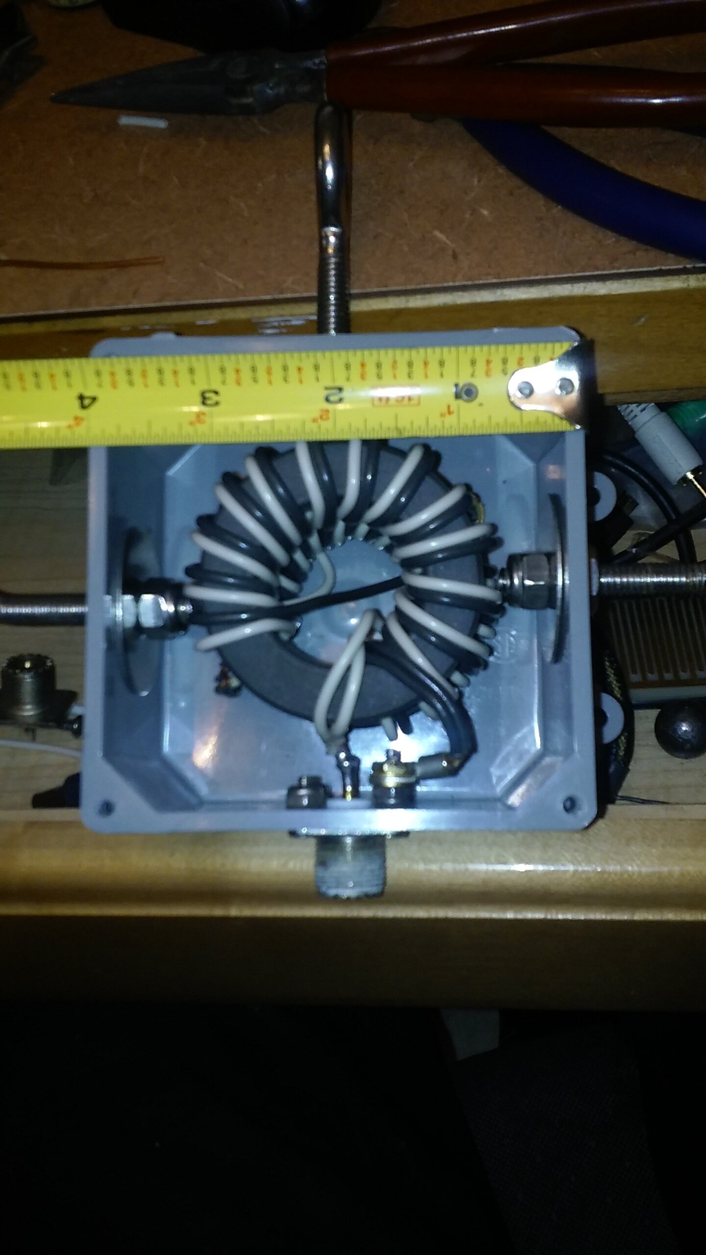

By the numbers
Previous burned up attempt
More arcing , sorry about the pics
The 40oz devil spawn feline assisting in the balun winding
Yup, junk
Not only was the calibration off a bit but the same cell phone camera with cataracts.
The yellow trace (VSWR) has two noticeable dips in that 50KHz to 60MHz span.
7.244 MHz and 52.4 MHz.
...missed it by that much.
Reactions: 543_Dallas

All because I can't seem to design, construct, build, follow directions, get the right materials, in order to have a 4:1 current balun.
Mod_0 : 7.244MHz & 52.40MHz with a 2.5:1 "saddle" between 14 & 28.5 MHz.
Result: arced, and well, not even close. Vinyl is not an insulator, it's a covering or coating.
Mod_1 : more of the same w/o the arcing.
Result: try again
Mod_2 : 14ga magnet wire and 4mm OD x 2mm ID teflon sheath. Same design.
Result: A biotch to wind and useful at 7.290MHz an not within 40:1 vswr anywhere.
Without the Drake MN2700B I wouldn't have HF at all. However can you imagine the return loss @ 3.825 across 150' of 9913? I don't have to :-/
Mod_3 : The above materials on verified "K" (52) 2.4" cores with (for the moment) the same design.
Right now her 33' vertical works better.
