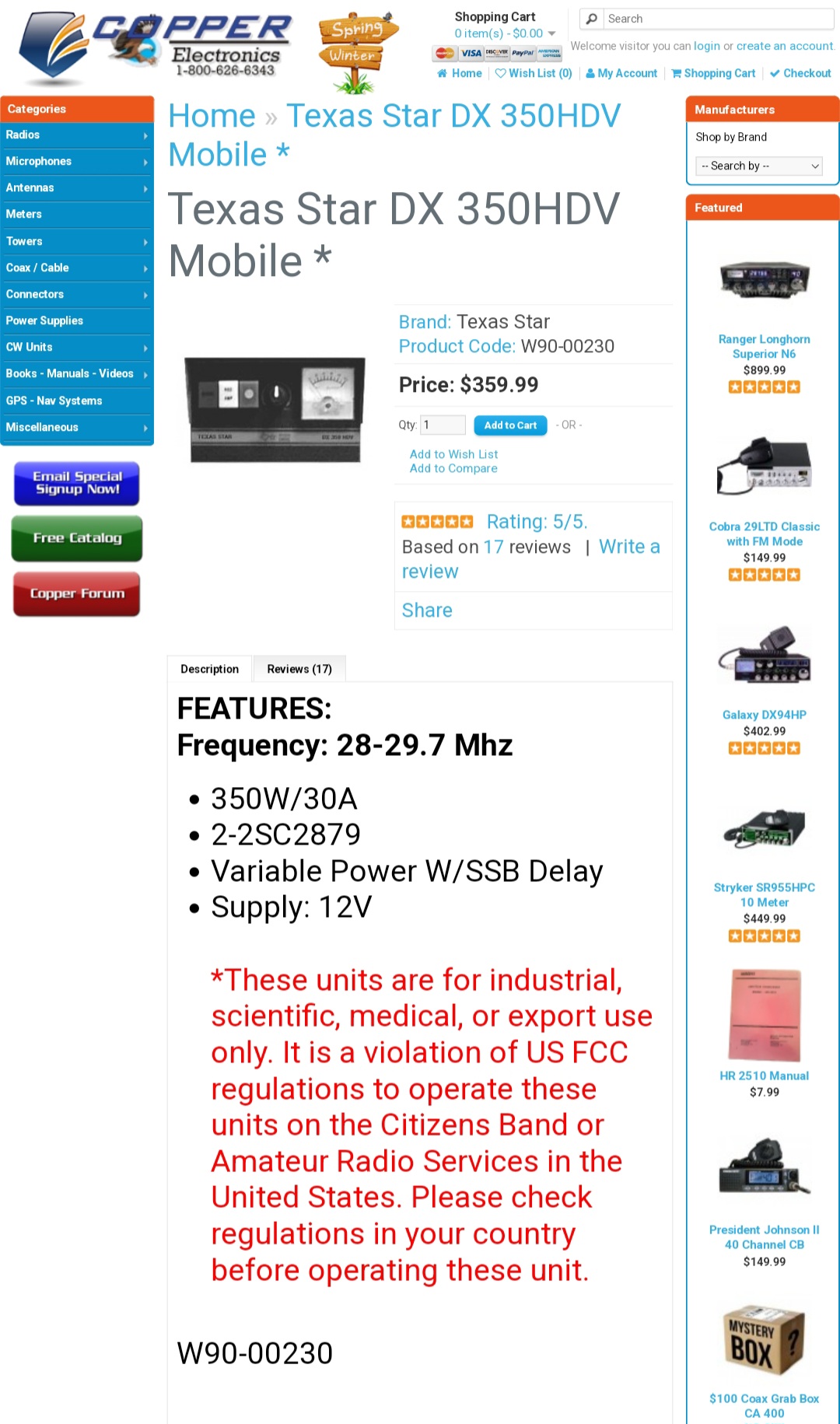

Here's TS 350hdv available at coppers. It's wild... I remember when these amps were just a tad over 200 bucks and with toshibas.. The good o'l days.
Sadly, the good old days has only been a few short years

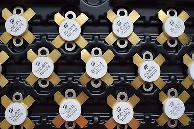

Another cheap option, especially if you are comfortable soldering.
Get one of these:
And just swap them out with the 4 Toshibas. They are the closest thing to a drop in replacement for a Toshiba 2879. They aren't as rugged and they only have about 90% of the output, but they are drop in.
If you think there may be other problems with the amp and you don't want to deal with it, send it and the replacement transistors to a tech and just pay for their labor. Still going to be cheaper than buying a new amp.
Get one of these:
That's what I would do too, I've got a matched set of 4 already on stand by for my 500v. It's the next best thing anymore unless you can find and have the coin for the real Shibas!
