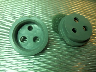

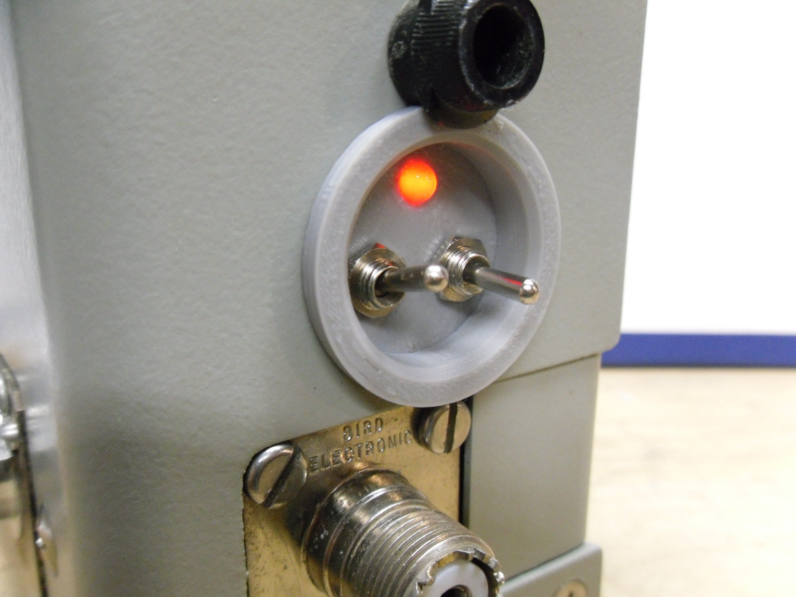

I installed a cap that I found on Ebay for my switches that mounts in one of the side element holes and it works great. It took me about 10 minutes to install it and I didn't have to drill any holes in the case.
