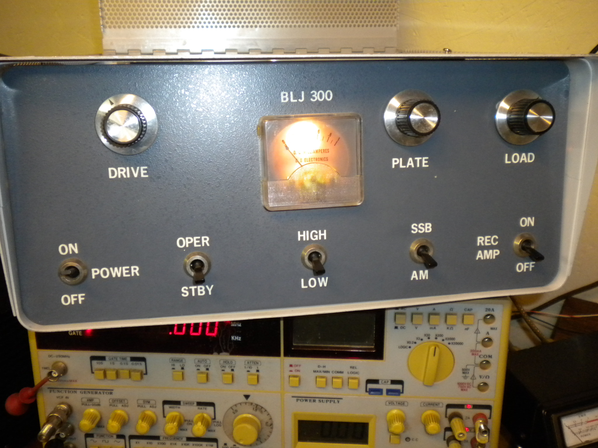

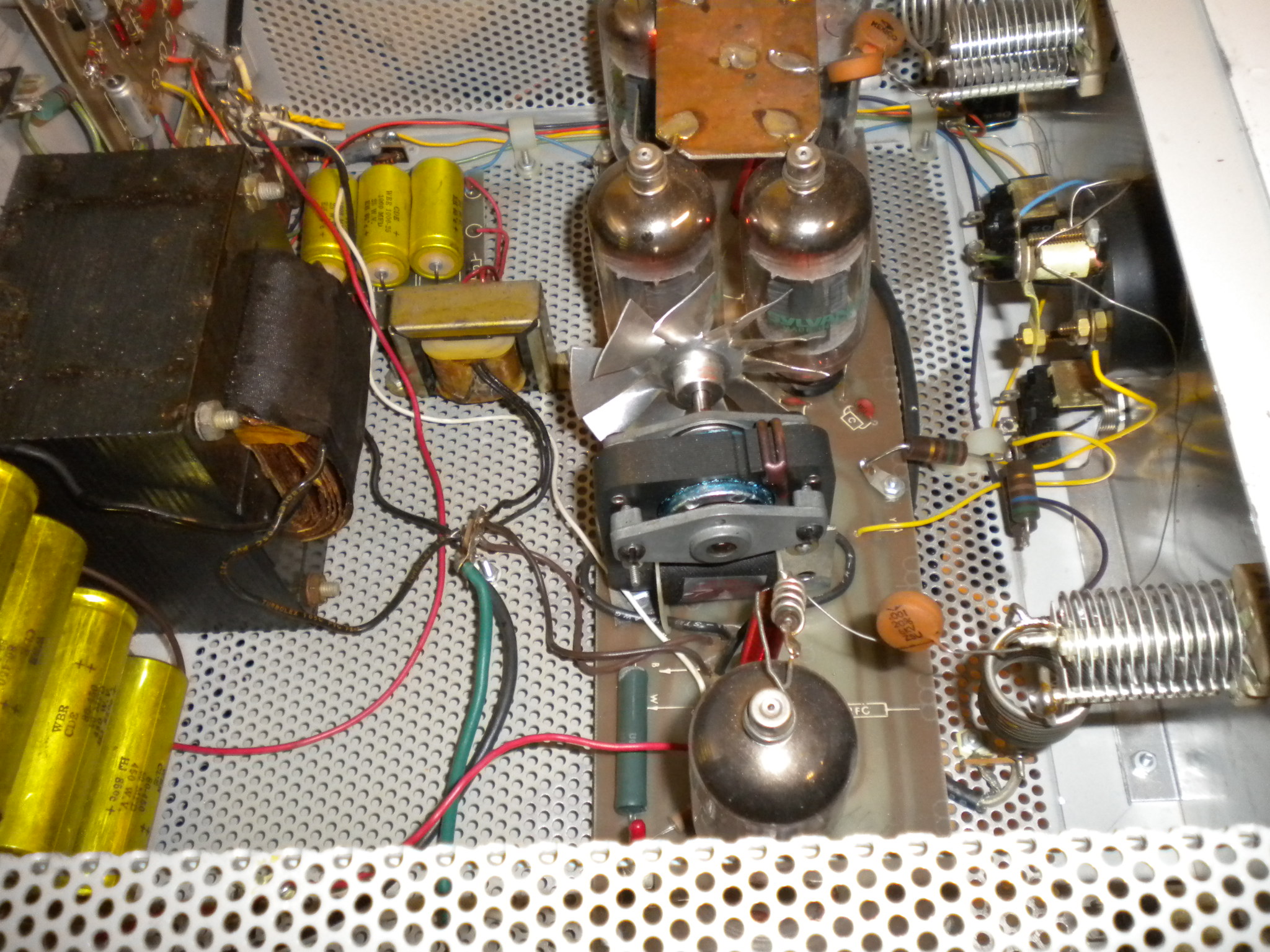

Can't find much on it.
1 driveing 4 20lf6...Need to know setup process???Also dead key. and modulation.
Thanks in advance...
Just wanted to know before <can not stand it>
I have uploade 2 pictures below.

It ought to tune and load as pretty much any sweep tube amp. Don't overdrive it - 3-4 w DK and maybe 15-20 swing max. If you hit it hard enough you might get 500w out of it, but it won't be clean and you will burn through the tubes a lot faster. Keep the drive down and it should provide 350-400w of clean audio all day long.

I have both a blj300 and a blj 400,My blj300 uses 1 20lf6 driving 4 20lf6 on a 4watt dk on low about 380 or so on hi about 600watts all day long on my bird meter.My blj400 uses 23js6 tubes 1 drving 4 and does about the same!Excellent amps for for sweep tubers!Just don't drive them hard never seen 6lf6 in them.

Hello my name is chuck I just bought a BLJ 500 but I don't know much about this tube amp it's my first ever I was wondering if you can tell me how to set this unit up drive,plate,load im not sure what to do please help so I don't blow the thing up ? is the drive like the tune knob were do I start HELP ME lol thanks.....
tuning
My unit has a toggle switch besdie the driver tube....Does this disable it???:unsure:
If you look at the driver tube you can see the top of the toggle switch to the left.
Old post sry wow I'm really late on this lol the switch is for low and high wattage.....
