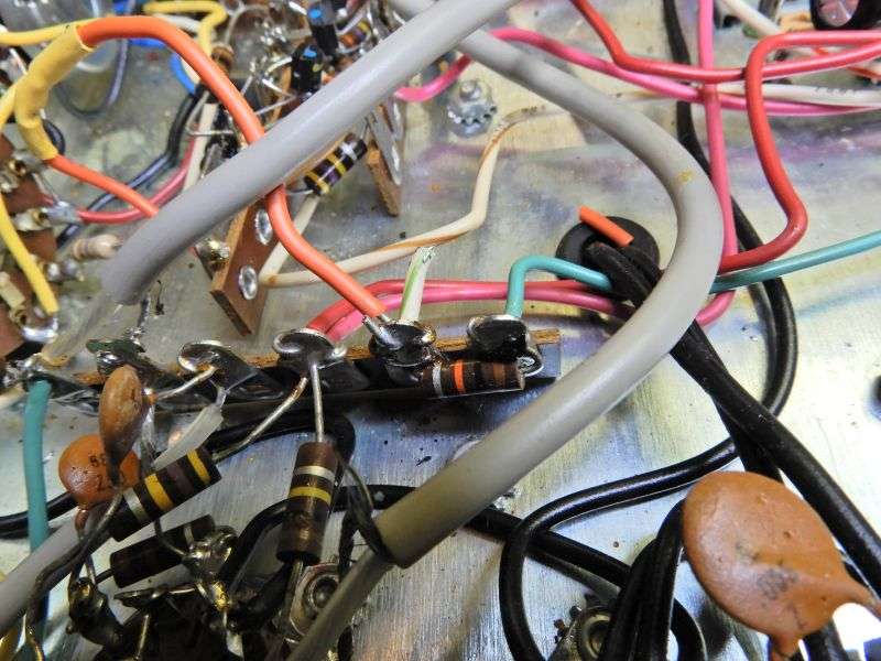

Cut the orange wire to reach the front-most end of R53, the lug where the white/green wire was removed and solder it to that lug.
M3hotwire_org_2_R53

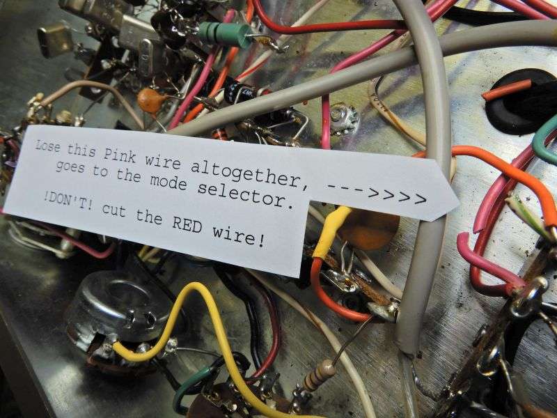

Next to this lug towards the front is a lug with a red and pink wire on it. Cut the pink wire at both ends and remove it.
M3hotwire_lose_pink

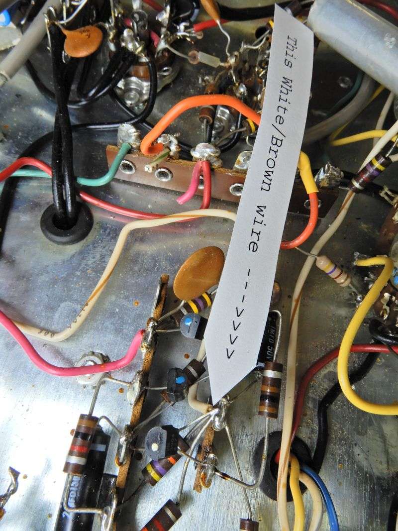

At the center of the front-most tie strip that supports the SSB ALC circuit is a white/brown wire that leads to one lug of T2. Cut this wire at this tie strip, strip the end.
M3hotwire_whi_brn

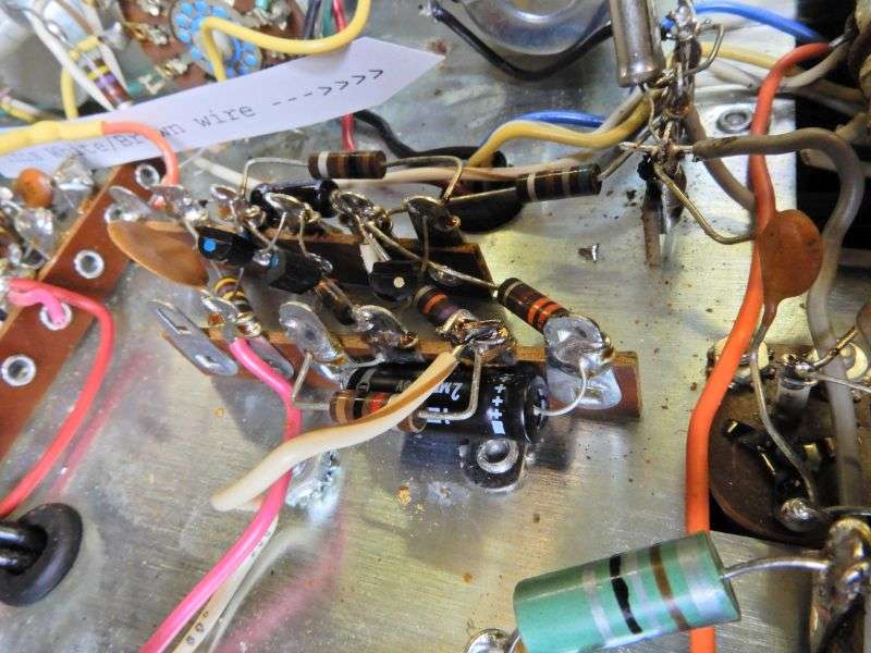

Solder the end of the white/brown wire to the ground lug on the rear-most ALC-circuit tie strip.
M3hotwire_ground_whi_brn
