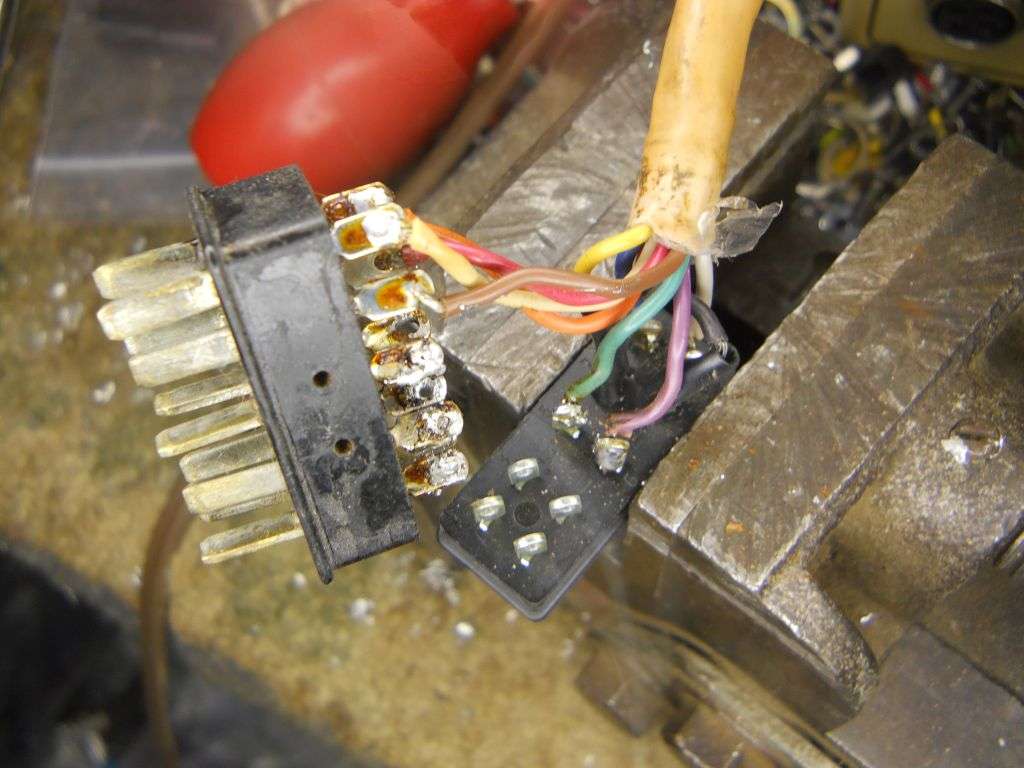

The Browning Golden Eagle Mark 4A is like any other 45 year-old radio. A product of the miles and the years, both.
Replacing every, single electrolytic capacitor is just the start. The 10-pin "Jones" plug that joins the transmitter to the receiver may or may not age well.
This plug gets changed. Somewhere along the line somebody used a knife or abrasive to 'clean' the pins. This removed the shiny tarnish-resistant plating, and exposed the brass base metal undeneath. This results in a noisy connection that cuts in and out.
Not exactly a commercial-grade result if you leave this thing in the radio.
A new one is still available if you turn over the right rocks.

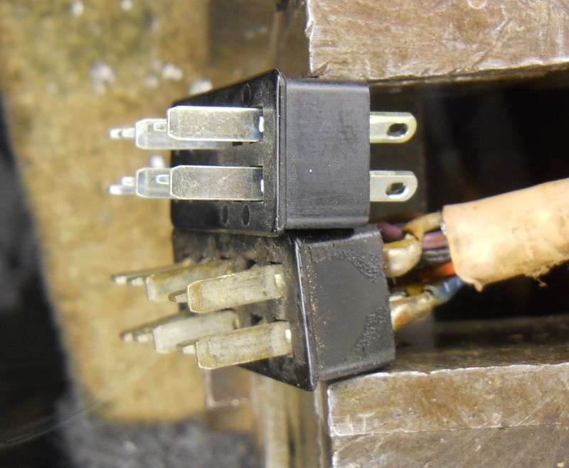

I prefer to transfer the wires two at a time. Makes things less crowded for the soldering-iron tip.

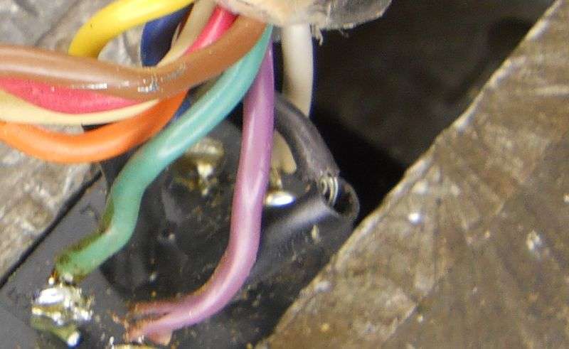

The sharp-eyed reader will spot the plastic tubing slid over the black wire. Removing each wire from the old plug requires some care. I grabbed the black wire's insulation while it was still too hot, and it came off. The sleeve restores insulation well enough. Changing the length of one wire to "skin it back" would make the process awkward.
Fortunately the housing on this plug is plastic, so no shock-hazard worries like the old metal shell might cause.
