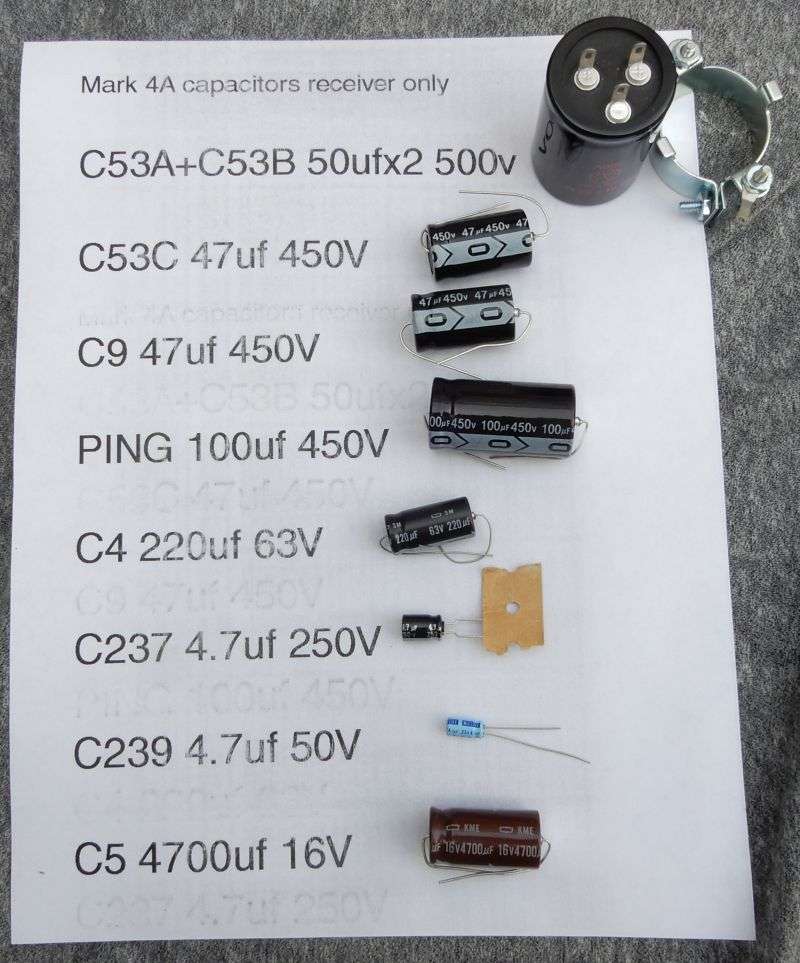

Even so, this is the original list of capacitors.
This is just the capacitors. We don't use an exact replacement for the 3-section "twist-lok" 'can' capacitor. We use a 2-section part, and the third one takes the form of an axial-lead cap.

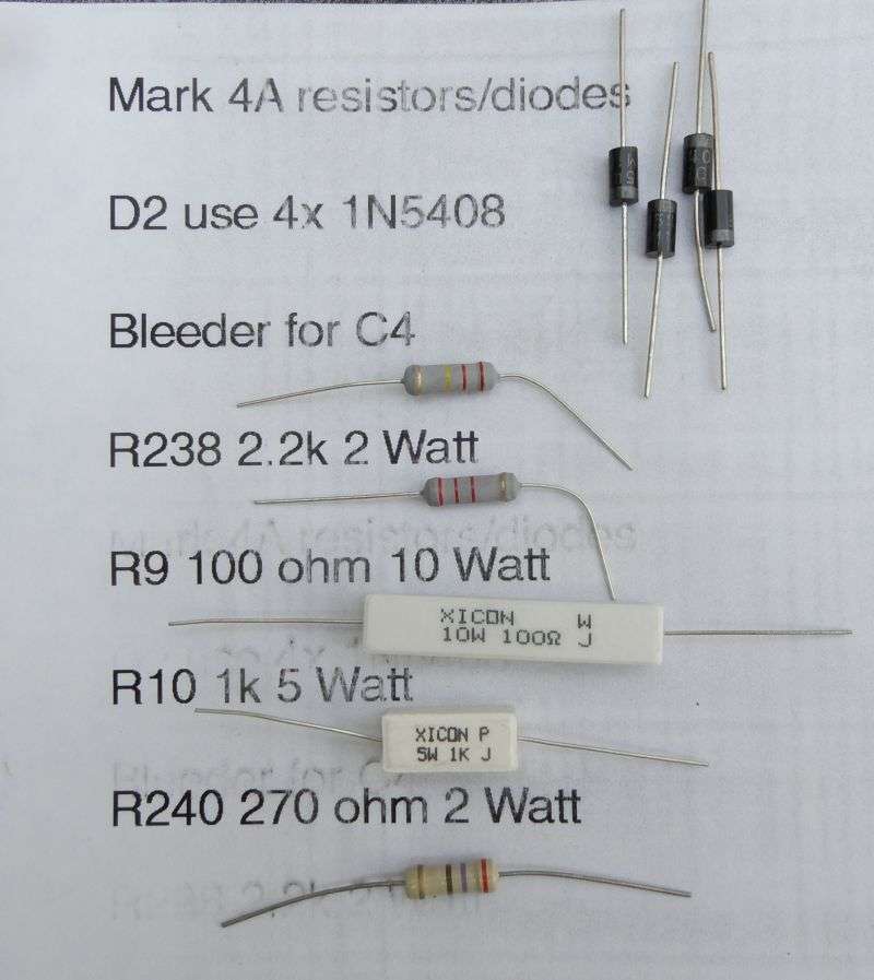

There are wirewound power resistors that run so hot the markings are burned away. One of them gets changed from 250 ohm 10 Watt to a 100 ohm 10 Watt. Yeah, that's cheating. I should just use a 25-Watt part, right? This mod doesn't reduce the ripple filtering enough to matter, and it boosts the modulated peak power just enough to see on a meter. Not enough to matter, but people want what they want. And that includes irrelevant wattmeter readings. Anyway, it runs much cooler. So does the other 10-Watt that we DO replace with a 25-Watt part.
Carbon-composition resistors that aren't good for 45-plus years are also on this list.
**OOPS!** The 750 ohm 25-Watt part wasn't included in this pic. Revisions are coming.

Revisions continue for this idea. We have used four 1N5408 rectifiers to replace the Mark 4A 4-legged bridge "block". Had too many of the factory bridge cause a headache after a repair. But simplifying the labor for this procedure is probably a good idea, so this list now starts with a one-piece bridge.

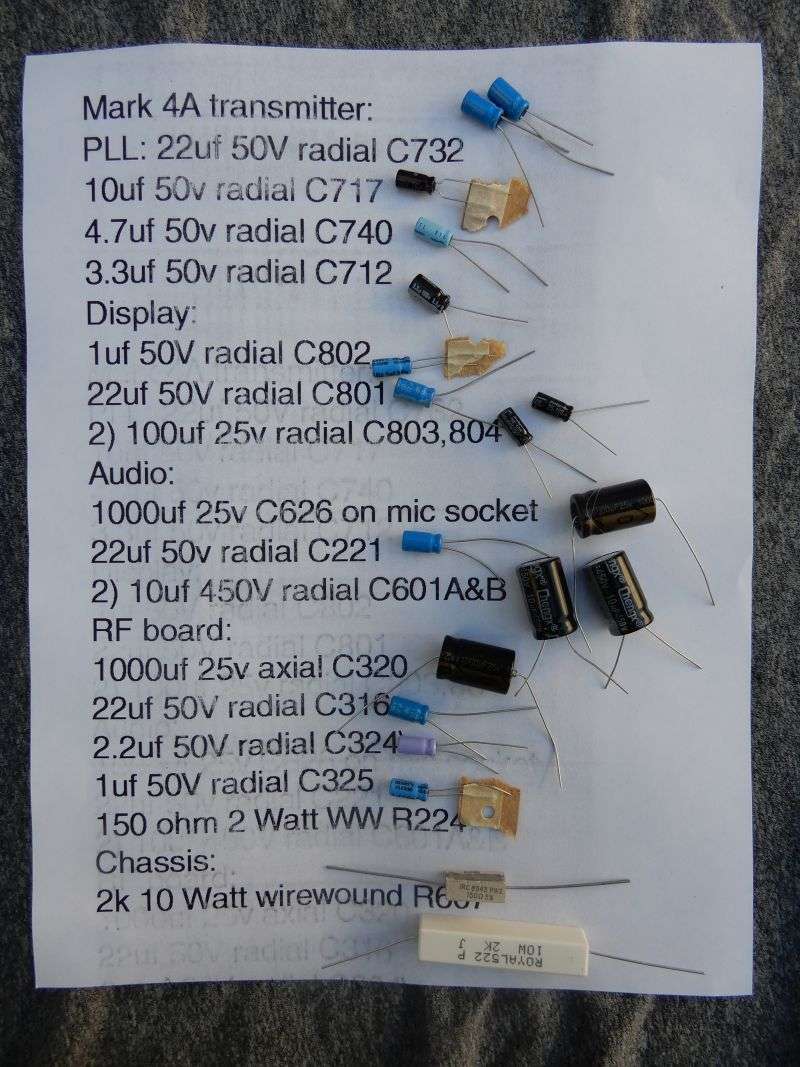

Finally got the transmitter list put together.
Still no concrete notion of when this gets real. My stock on some of these parts is pretty low. This package won't see the light of day until I restock in some quantity.
Might not sell all that well. But the risk is minimal. Worst case I end up with a couple of years' worth of parts for the next dozen Mark 4A radios.
