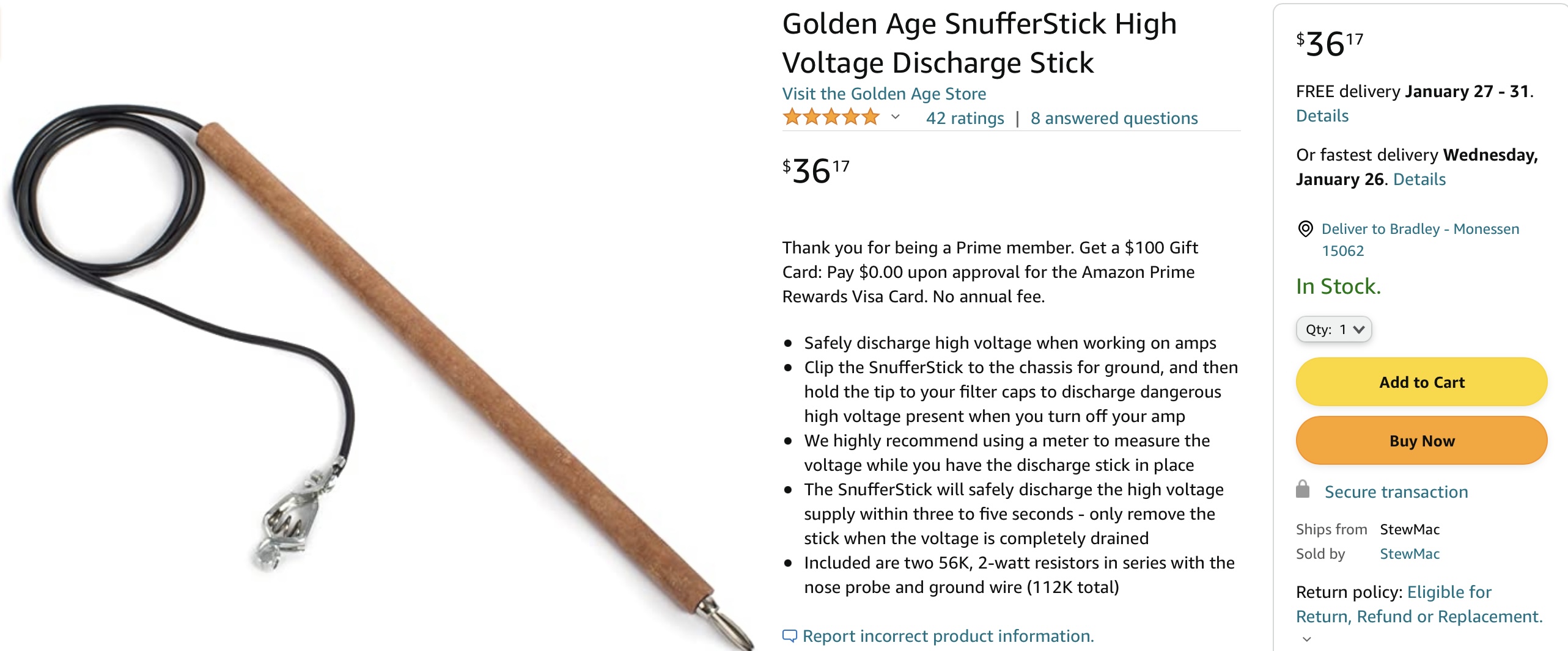

In my search I settled on the following manufactured Capacitor Discharge Stick which is rated to 600 volts. I’ve used it with great success to discharge AC capacitors. A little pricey but it works.

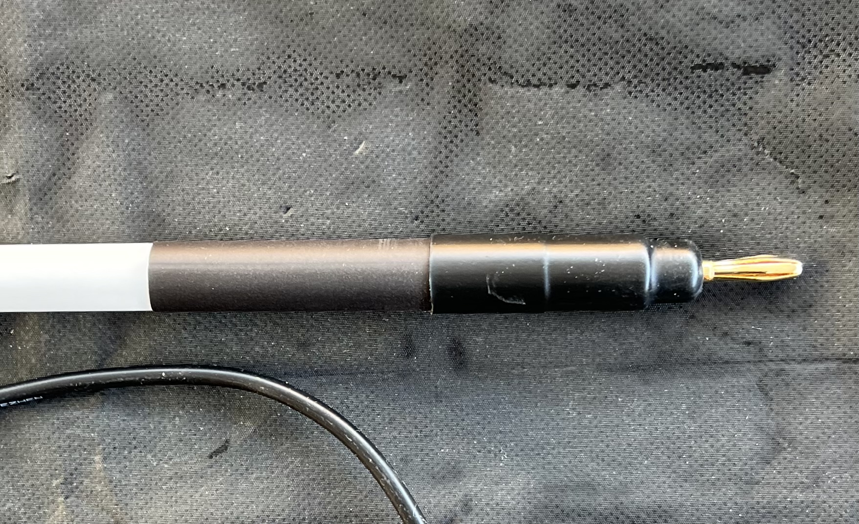

1. Teflon/PTFE Rod 2 foot long 1/2 to 1 inch diameter with at least 5/16 to 1/2 hole down center. Purchased from ZORO. McMaster-Carr has some good sizes as well.

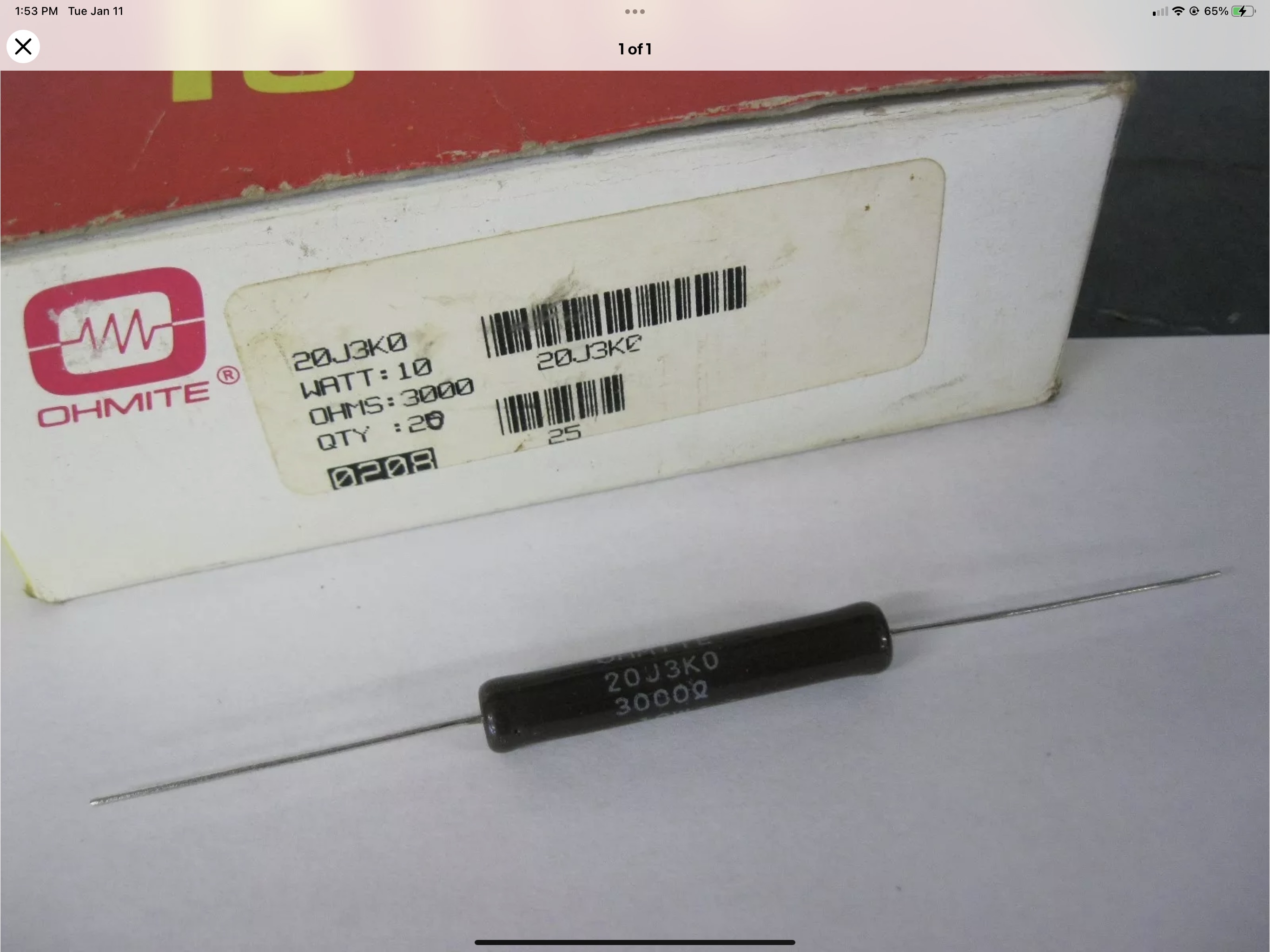

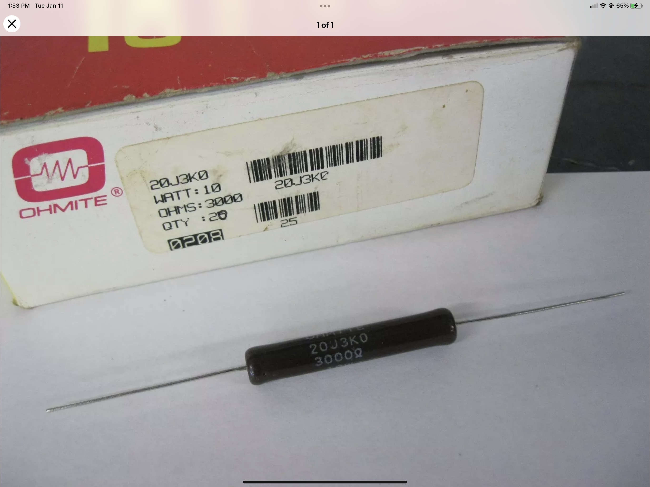

2. Resistor…calculate value needed and then 5 watt or 10 watt. I choose these:

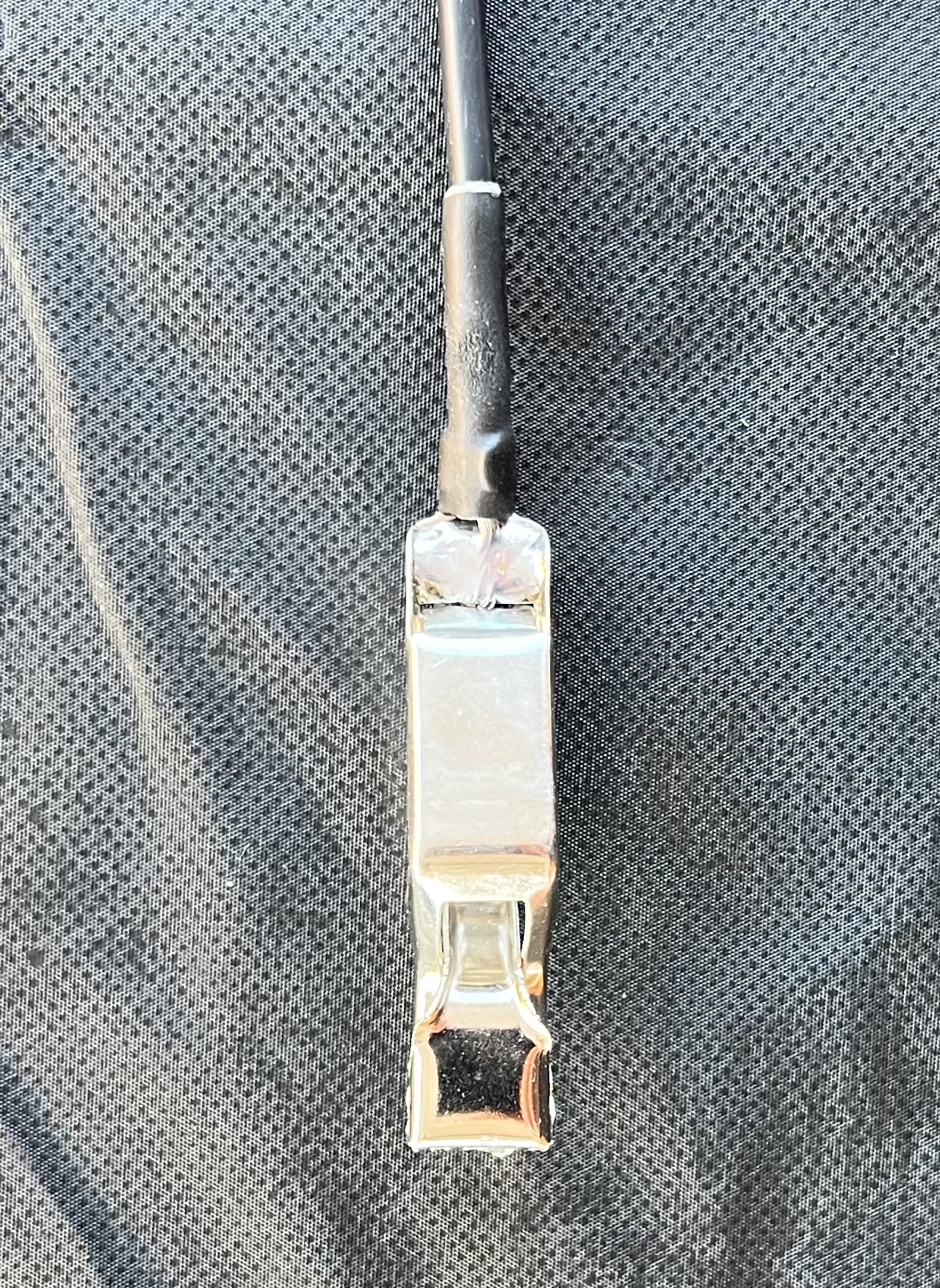

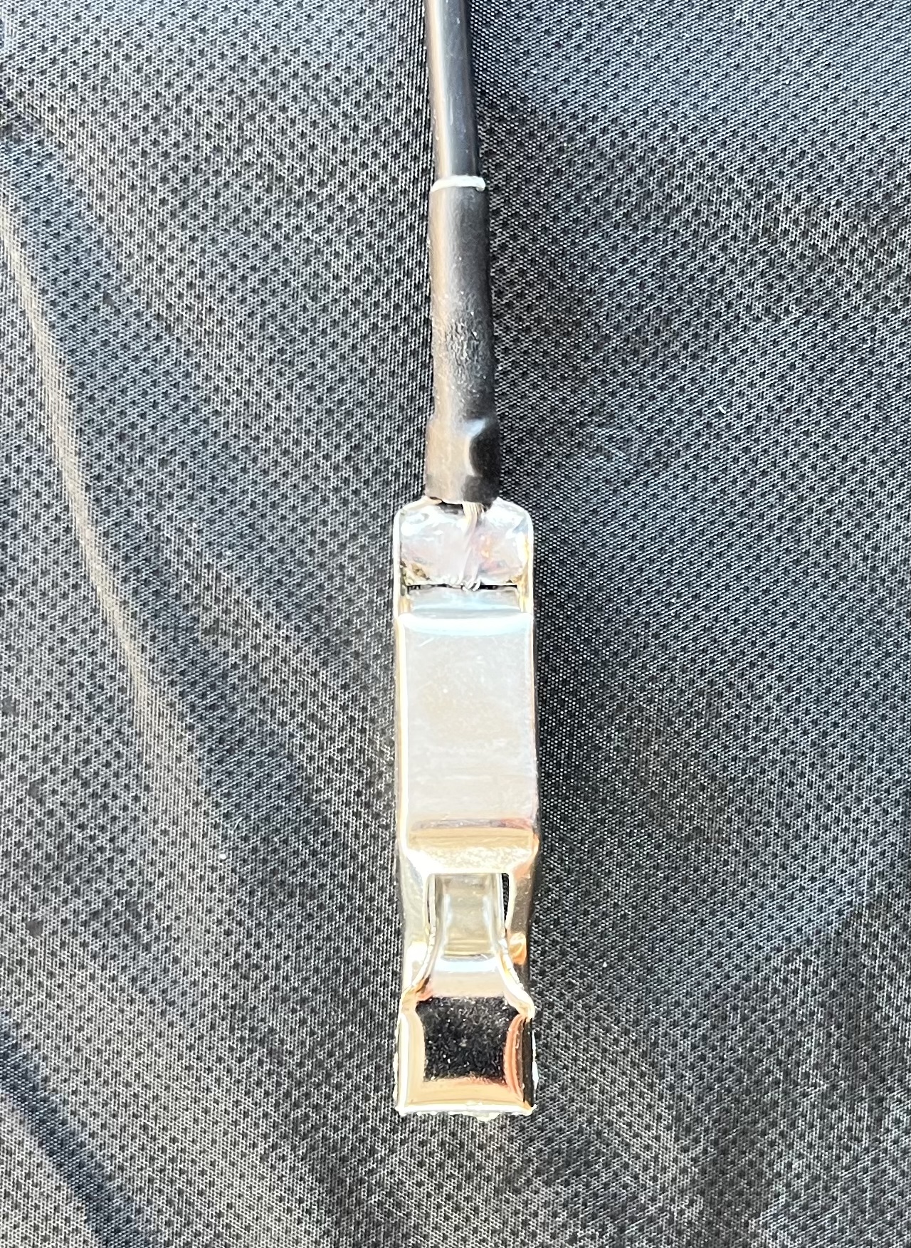

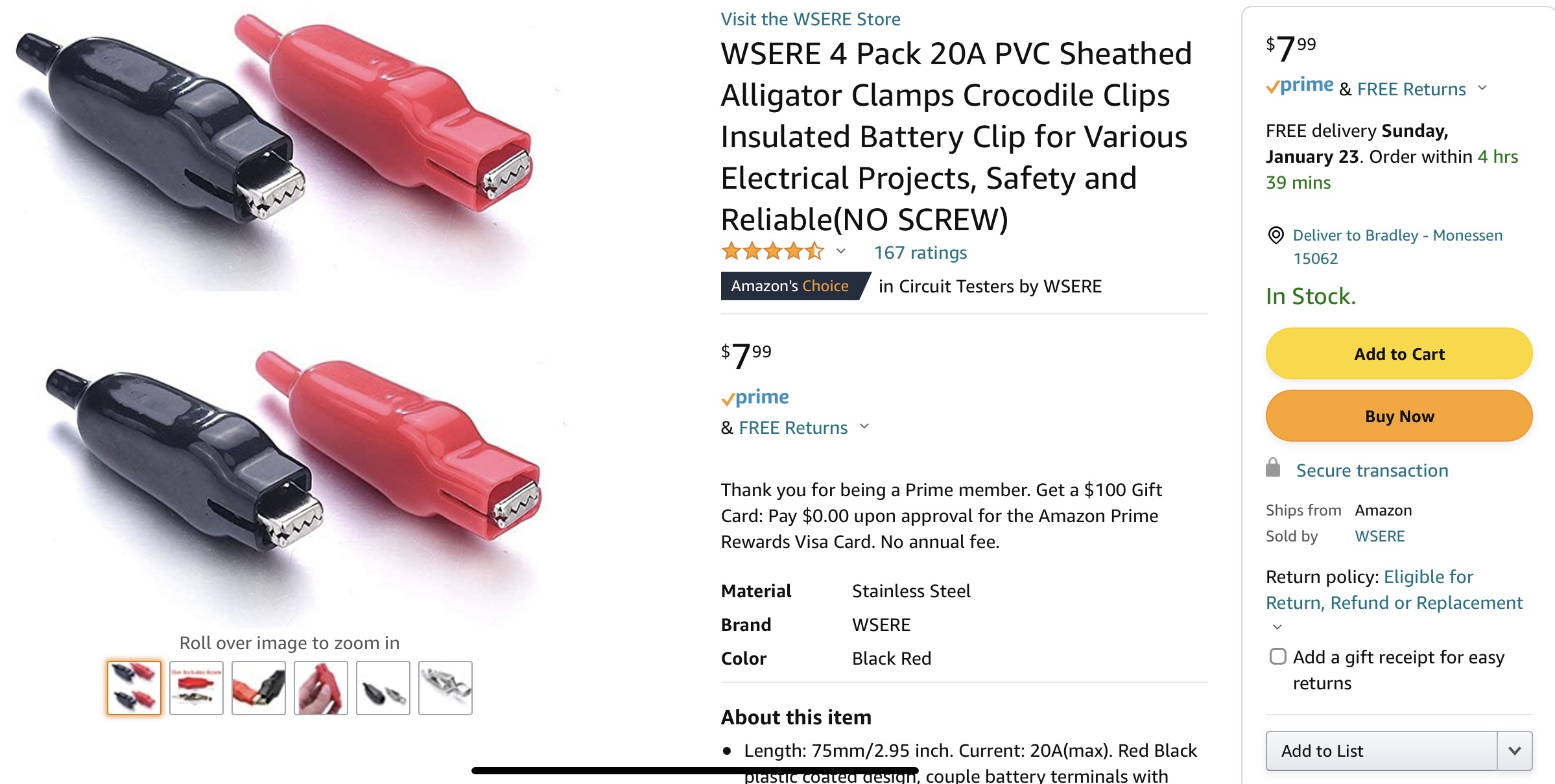

7. Crocodile Clip for attaching to chassis or ground. These are great off Amazon:

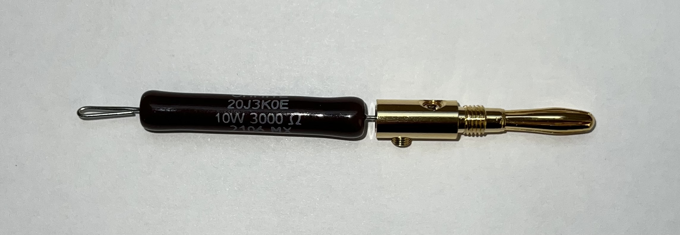

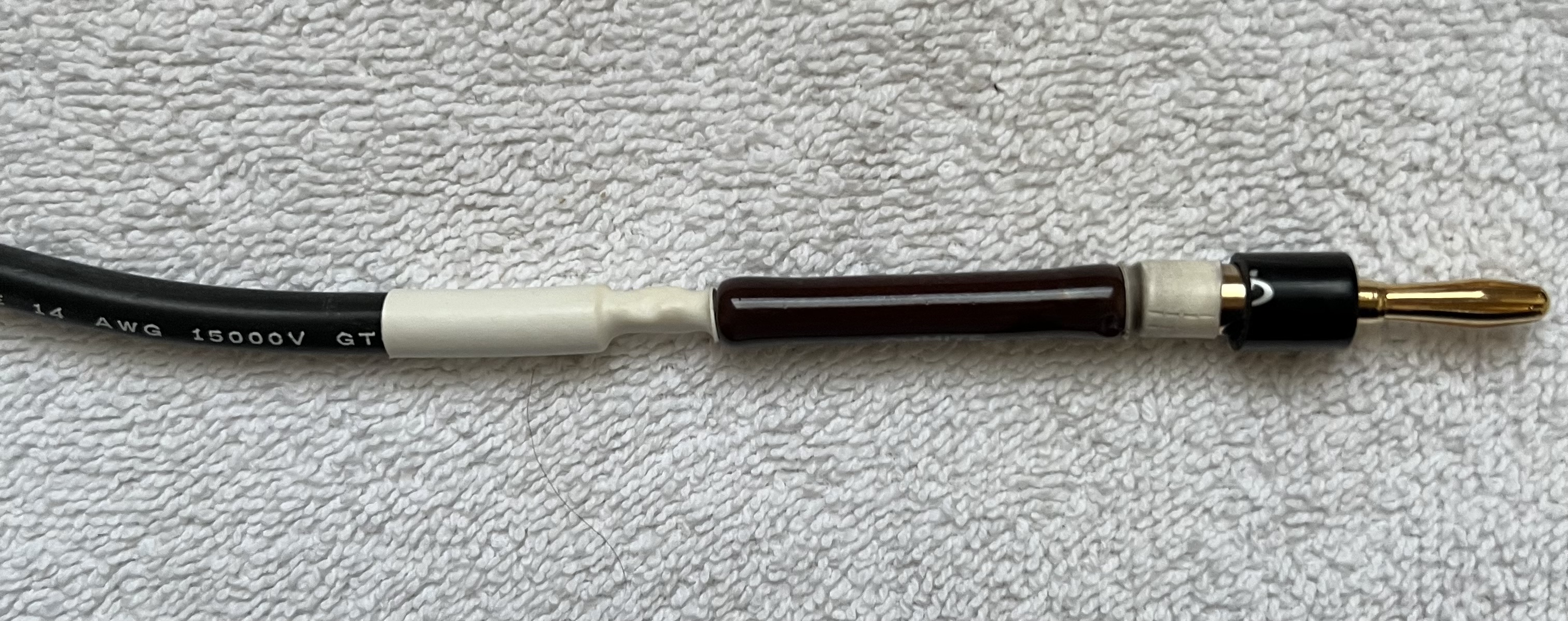

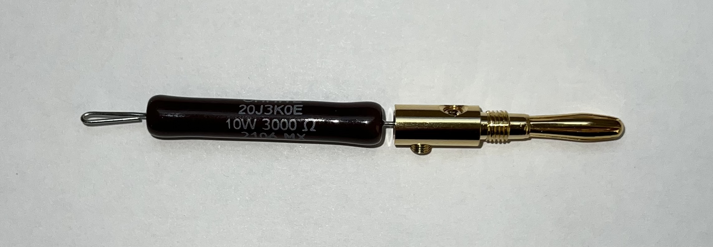

The reason for a hole down the center is that I’m using a 3000 ohm ohmite 10 watt resistor. I want the resistor to solder directly to my probe tip which is a banana plug and then slide it up inside the rod.

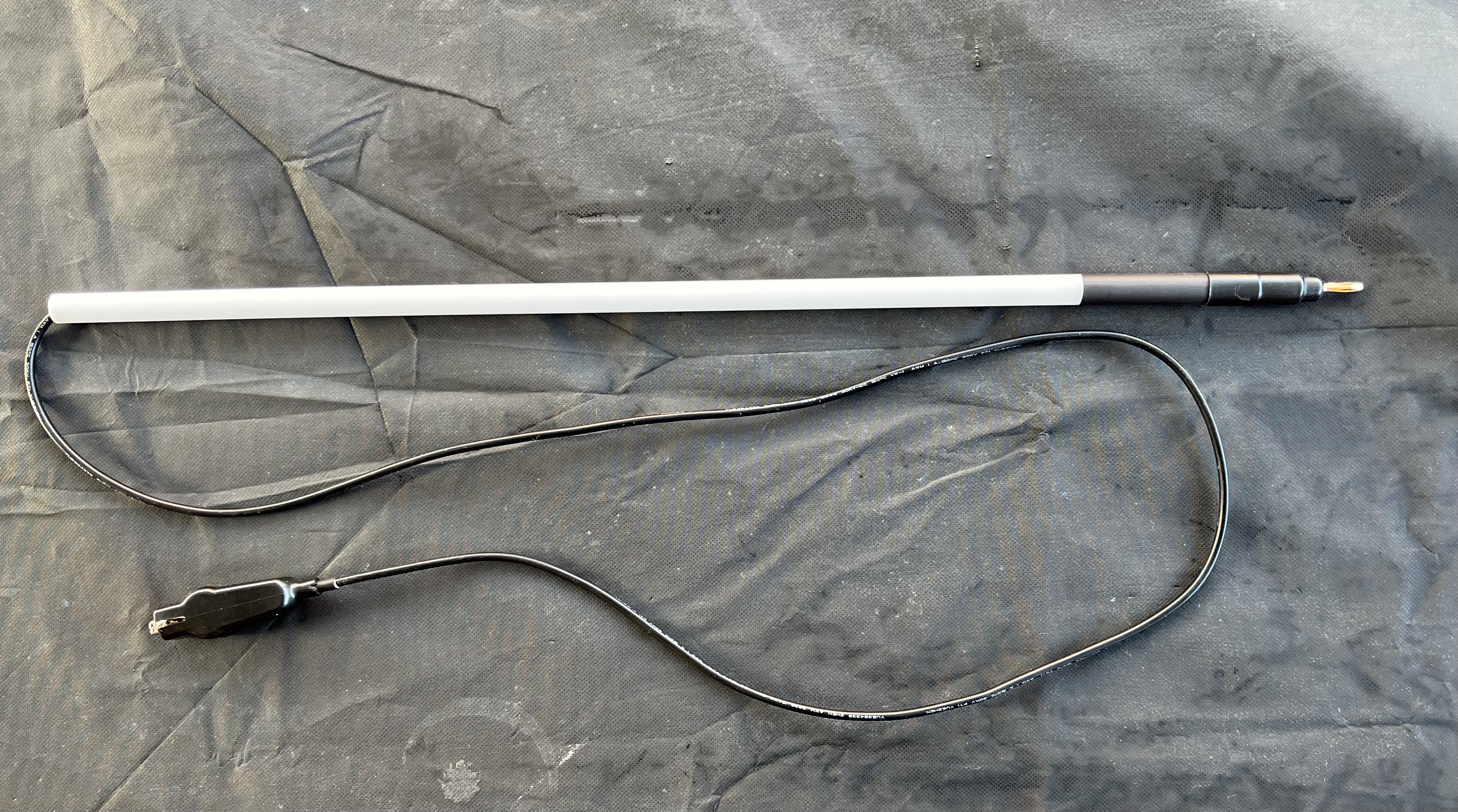

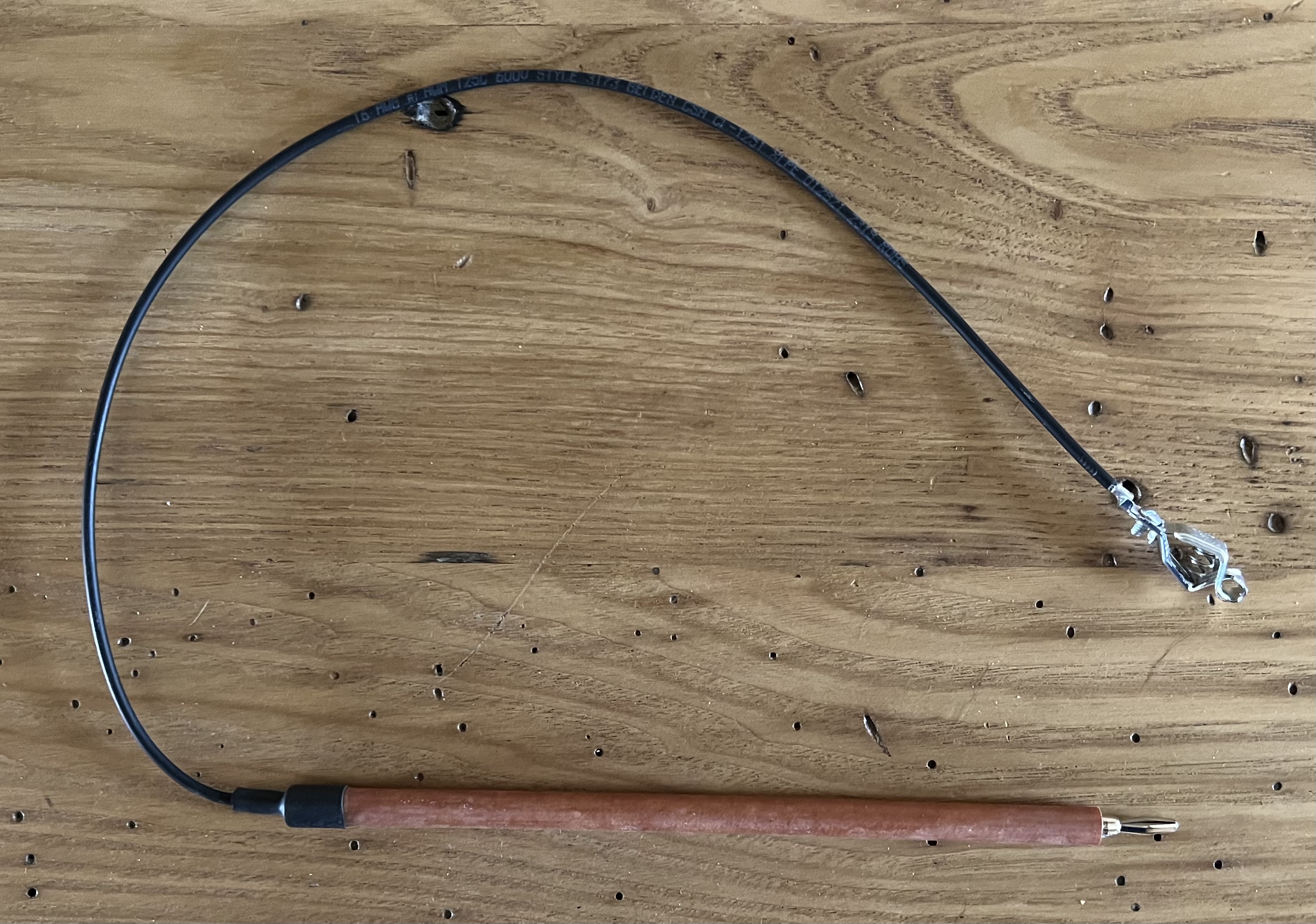

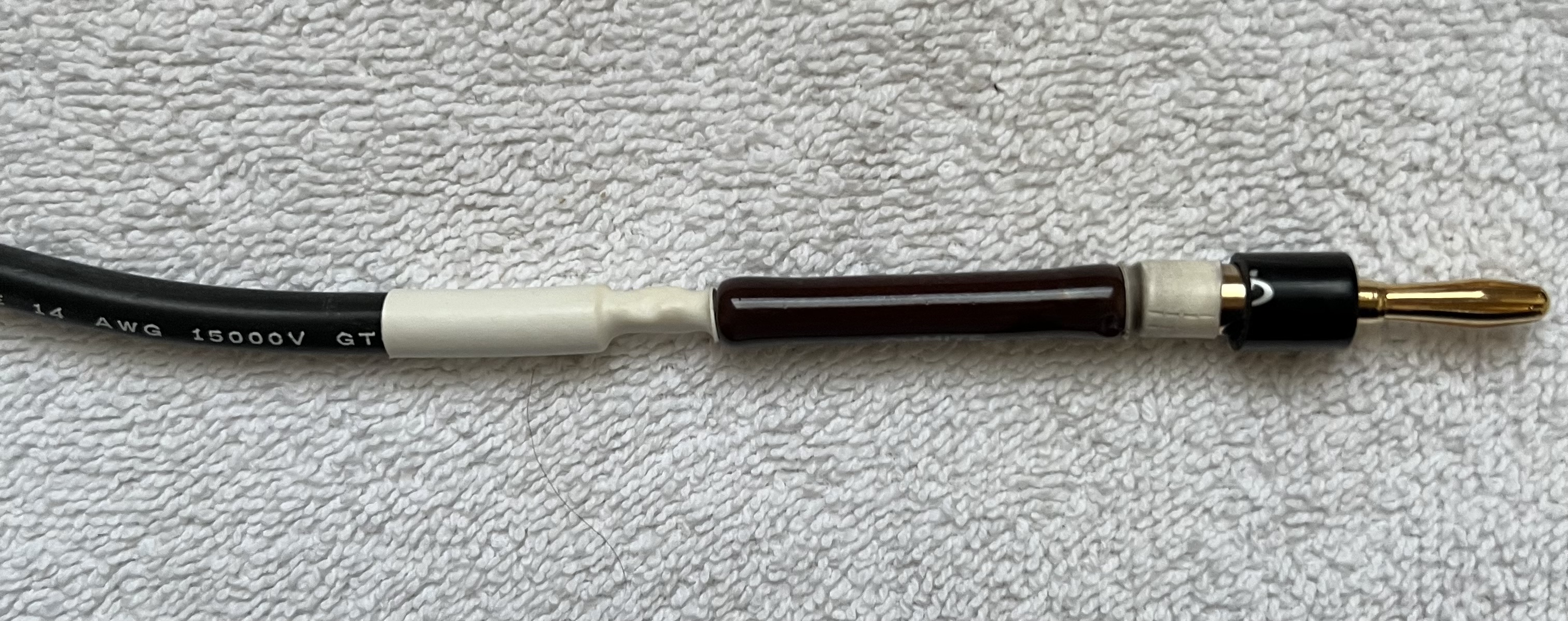

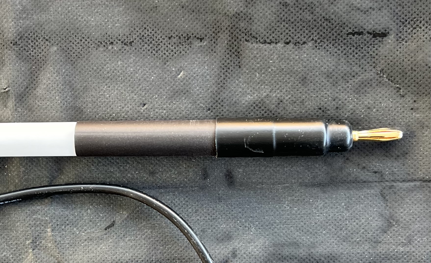

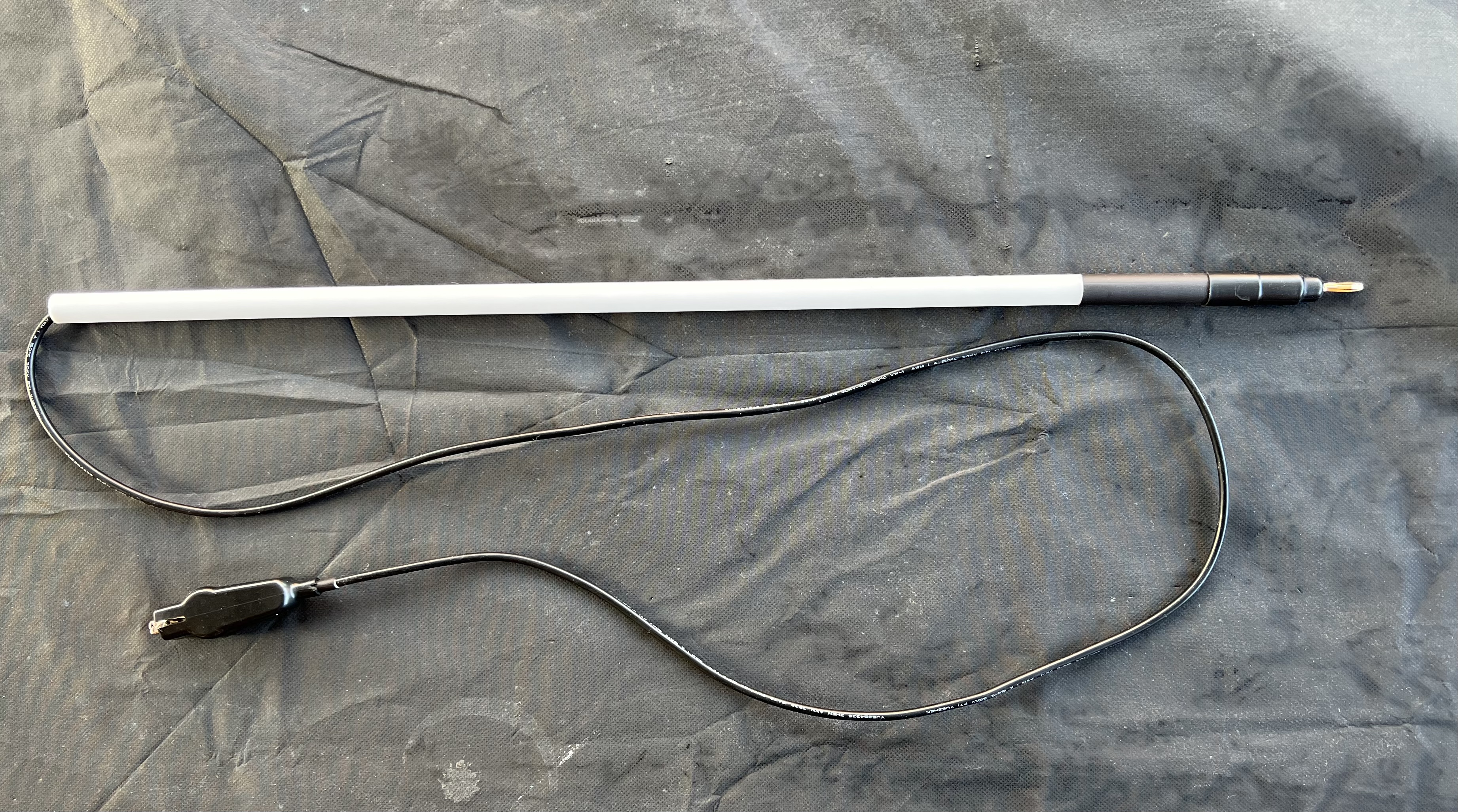

The following photos show the build:
The above banana plug is Flood Soldered and then the capacitor lead inserted.
Then slide the assembly up the center of your Teflon rod.
I would greatly appreciate any feedback for ways to improve and what others see as a hazard that I haven’t considered. Yes please tell me if I have a “FATAL ERROR” in my design/project.
View attachment 56697View attachment 56698

Notes: The hole down the center needs to be large enough for the resistor to slide into. I’ve found that 5/16 is usually large enough. The HV wire isn’t carrying High Voltage because it’s after the resistor. Now if you placed the Resistor at the Crocodile Clip HV is traveling that wire until it hits the resistor.
Most of the time when purchasing wire for around the home or in our autos were more concerned with Amperage rather than Voltage. Amperage is based on guage of wire while voltage handling is based on Insulation of the wire.

So I did almost the same thing as you, the only difference was I don't run the ground side of the lead down the handle towards me because if by chance that insulation never failed or something it would be next to my body. I make it come through the handle and then come at the side a little bit of the ways up
