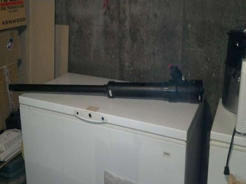

I just use my home made spud cannon. I use a screw eye screwed into a large heavy drywall anchor that is in turn screwed into a potato. I have to leave LOTS of slack line and I use mason's line. I have to use a really small charge to get it over the 60 foot high oak trees which is really hard to do as it uses fuel like hairspray or WD-40 and gauging how much is hard. A full charge would put it over a giant sequoia with ease. :ohmy: I also get to have fun with it in the antenna off season. :D
Sorry for the crappy image. i just used my cell phone and was too lazy to get the camera gear all out and set up.
The back screws off to spray in the fuel and the red button is a BBQ igniter aka firing button.
